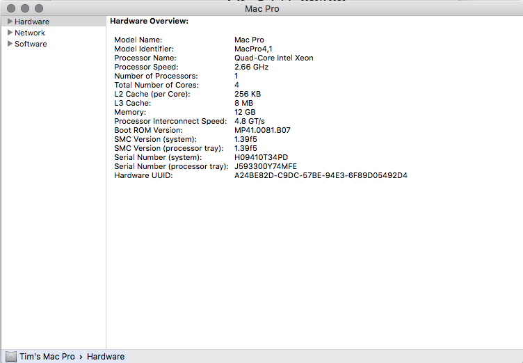

Okay, So I finally got a chance to run this again: Disabled SIP, shut down, removed harddrive with El Capitan and booted from External Yosemite drive. Mounted the firmware, ran the installer, ram disk was made, then after shutting down the machine and holding down the button until the light flashed/ loud beep was made, machine booted up like it normally would and no update was applied. I tried this several times using different firmware dmg's (since I couldn't remember which one was the most recent).
Am i missing something/ doing something wrong?

That's strange, so, you have a 4,1, with the B07 firmware, a EFI GPU, Yosemite (SIP disabled from the El Capitan recovery partition), mounted the required firmware on the desktop, but cannot finish the firmware upgrade process. Am I correct?
Yes. The only step in the process that seems to be giving me trouble is the restart. It says to shut down the system, hold down the power button until it flashes, release it and then it should take longer to start up/ should install. But the only thing happening is it is just booting up like it normally would.
