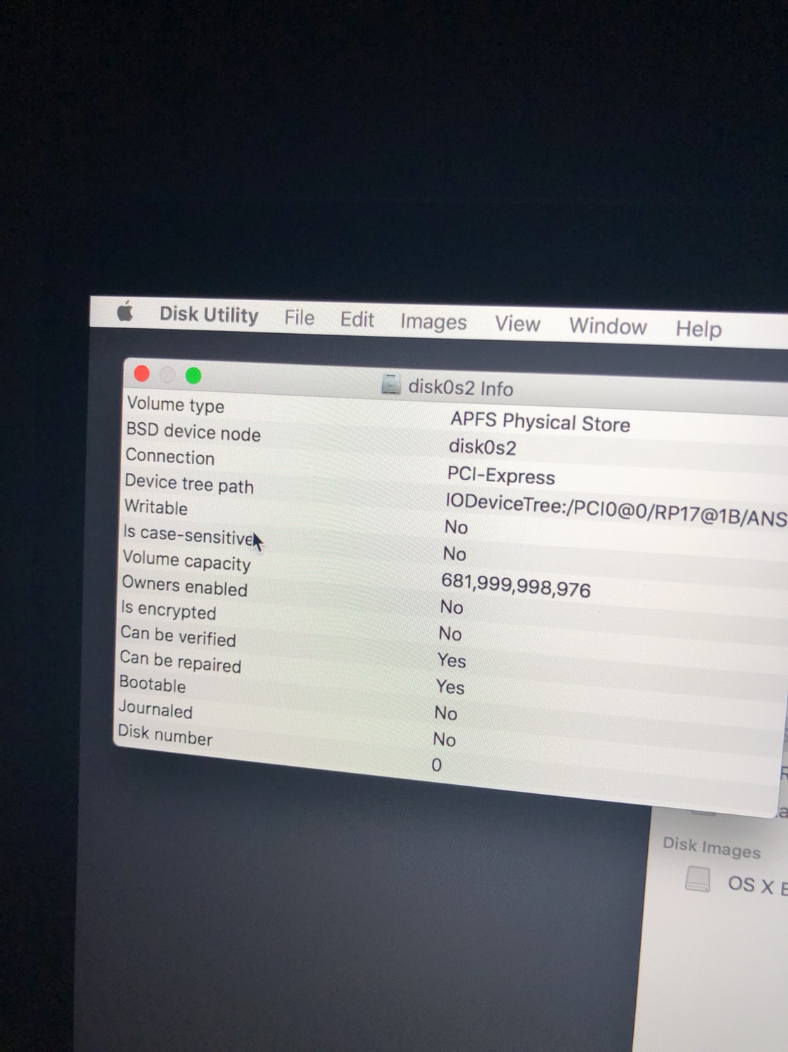

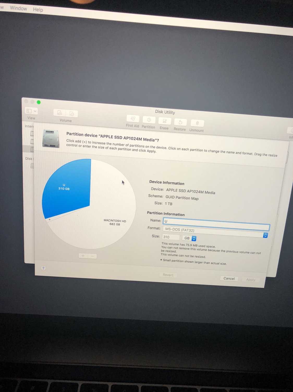

So I just got my 2.9 i9/16gb/1tb MacBook Pro and I went to install boot camp on it. During disk partitioning,
This is what comes up in disk utility
It rather looks like it crashed mid resizing partitions and managed to mess things up quite badly.. I suspect you may be stuffed if you don't have a backup as I don't there exists many recovery tools for APFS.
You'll probably have to repartition the disk from scratch to reinstall OS.

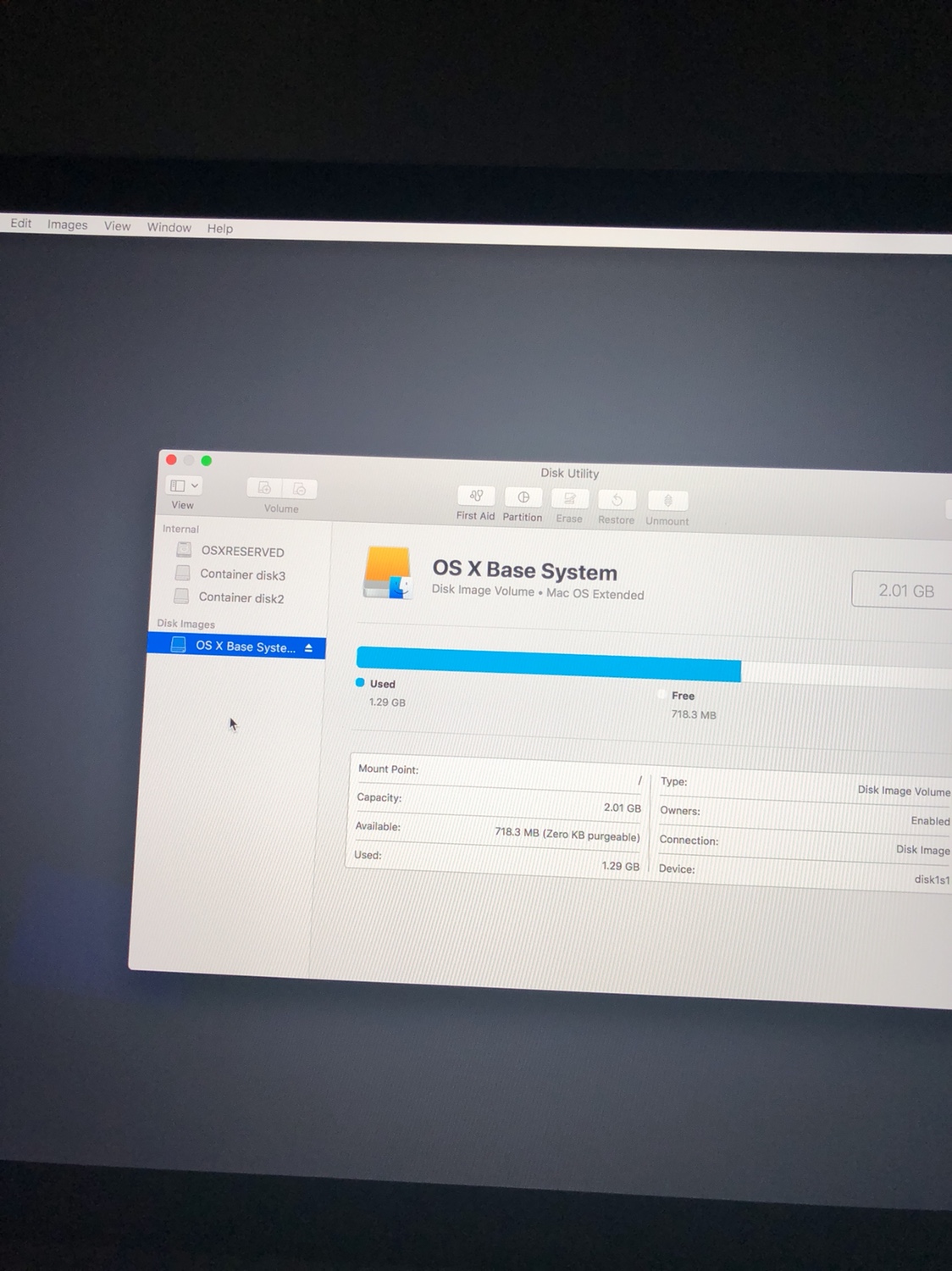

I tried making repartitioning the disk from scratch but it’s not working. Could this be a faulty SSD? I tried doing it myself on disk utility and I keep creating more weird files in the stupid disk utility.
I’m trying to find a manual way to make a disk partition, but it seems to fail no matter what I do....
I assume you manually removed ALL existing partitions and then created new ones, and what happened then exactly? Describe, please. 🙂 It's much easier to help if we know the exact error messages if any, and so on.

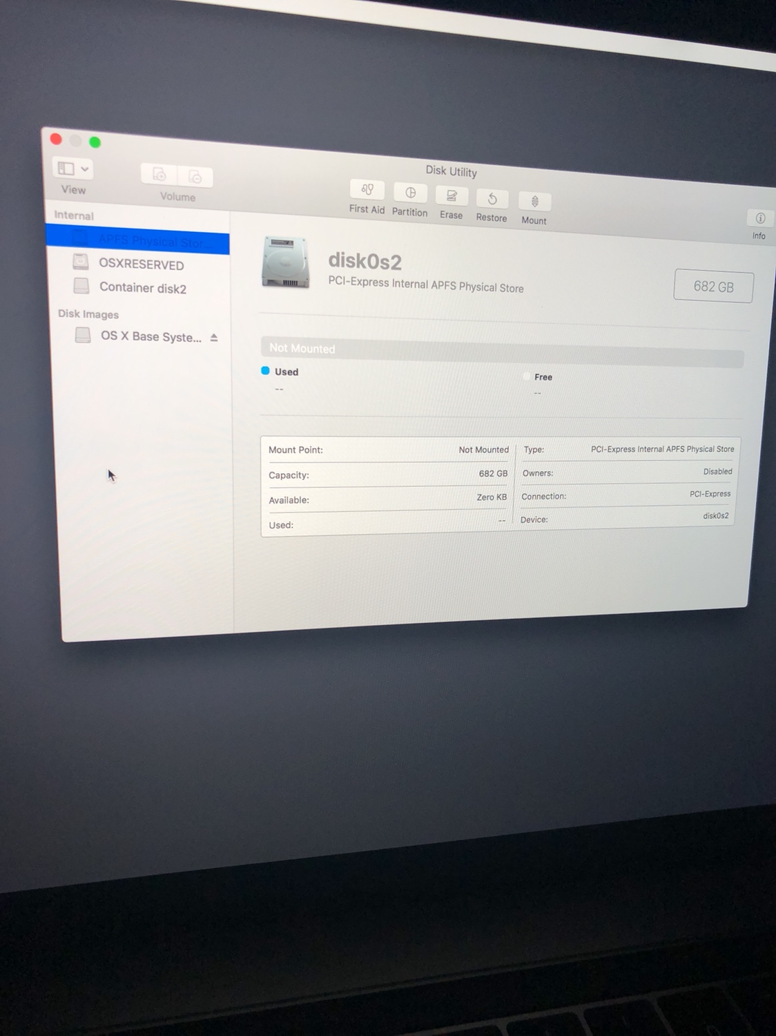

I got OS X to download, but I can’t delete this partition no matter what I do... how do I get rid of this?

Boot into internet recovery > disk utility > view "show all devices" > erase the top level internal HD (rename it macintosh HD etc) What does disk utility show now? It should only show the top level internal HD and then macintosh HD underneath it as a partition.
Make sure you boot only to internet recovery and changed the view settings to "Show all devices".

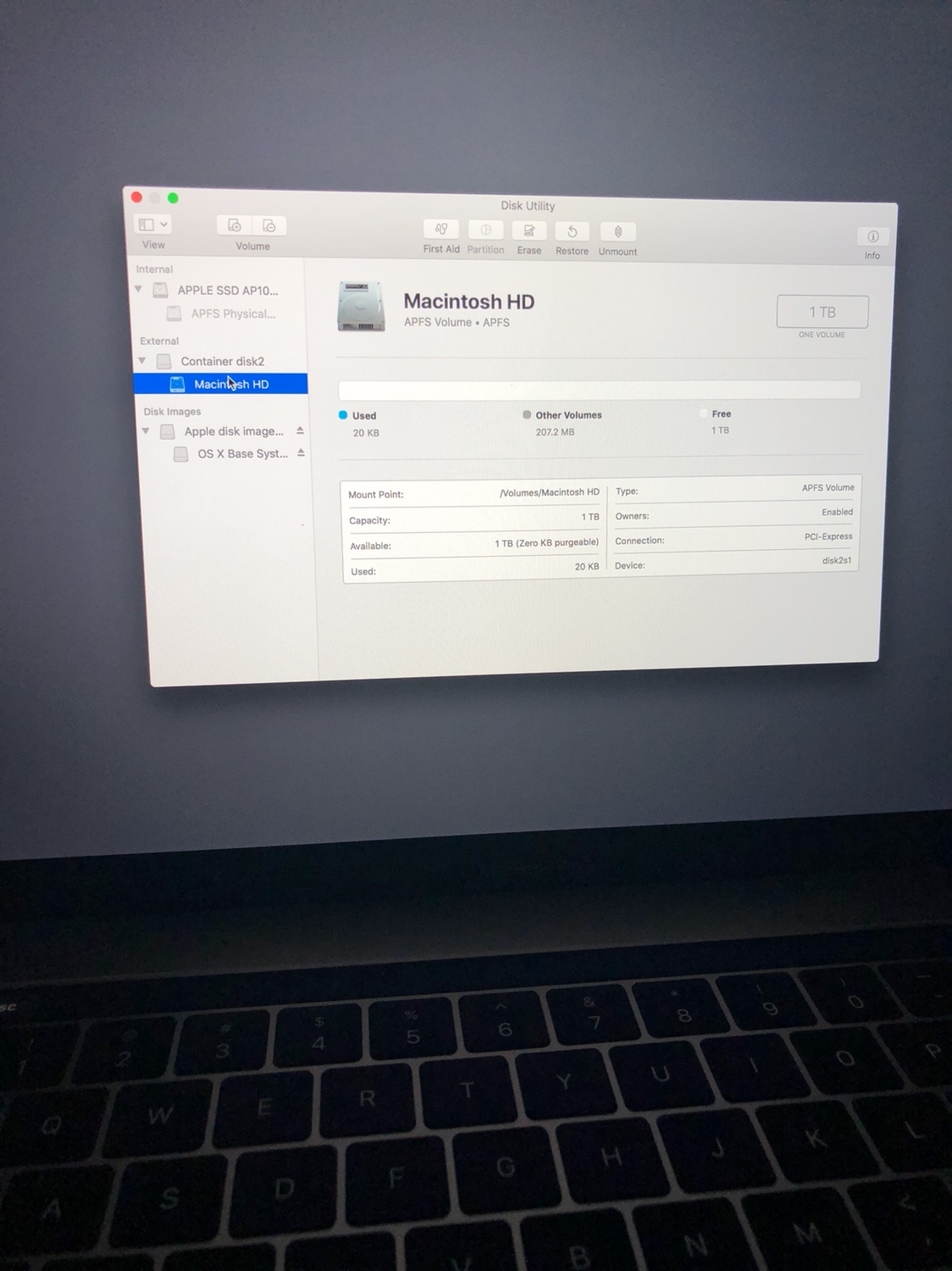

Press on the Apple SSD AP10.... and Erase that. Rename that to Macintosh HD.
You then should see the Apple SSD AP10... the very first listed and then macintosh HD underneath it. If that is true you should then be able to reinstall the macOS to the internal HD macintosh HD partition.
edit: make sure you format the "Apple SSD AP10..." disk as 'macOS extended journaled'
Worked! Thank you so much! I was able to also install boot camp this time.

So wanted to update you guys...
It happened again and messed up both my operating systems... I just returned it so I can order another one. They think it’s my SSD drive that’s bad
