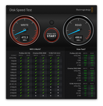

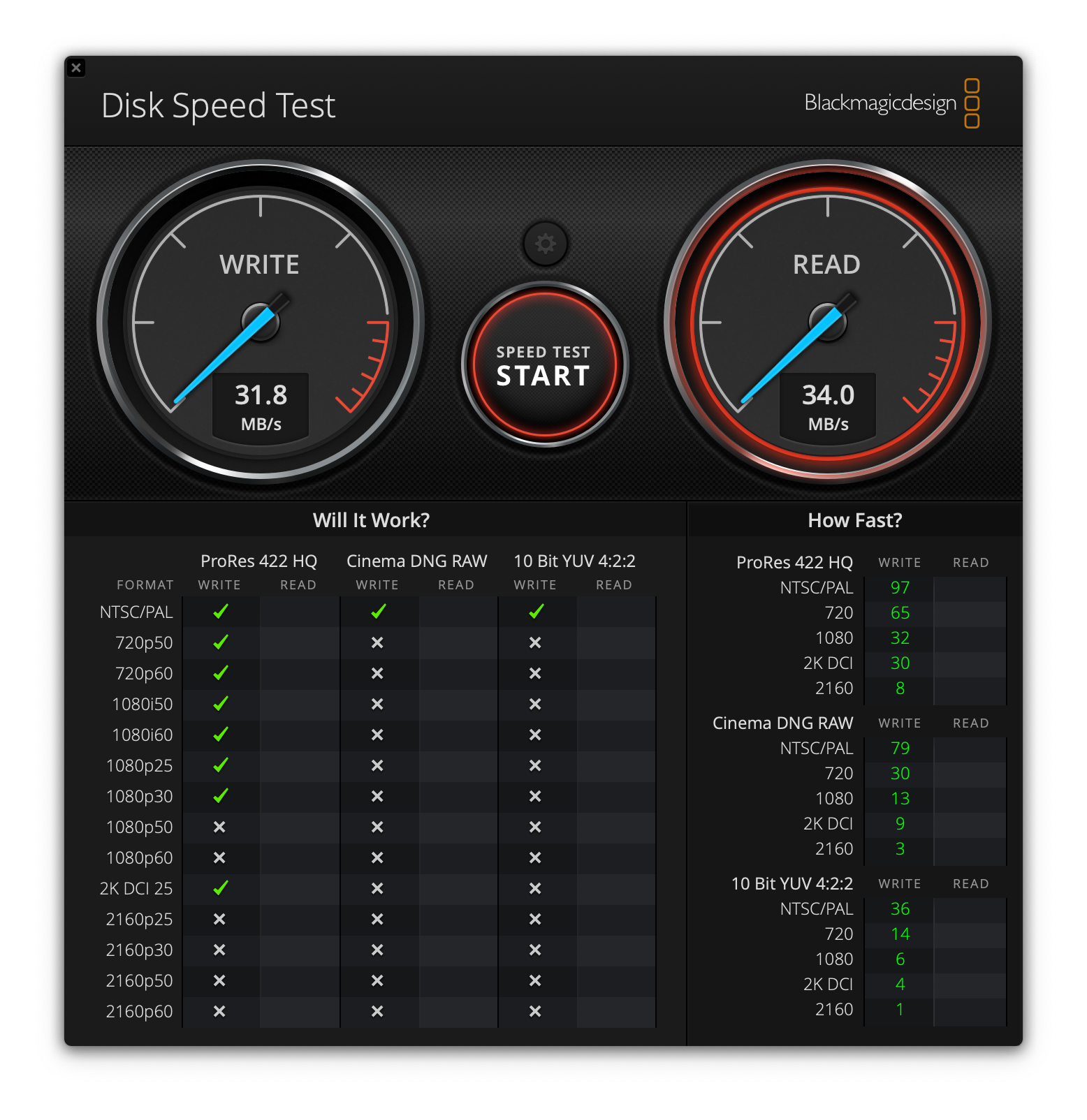

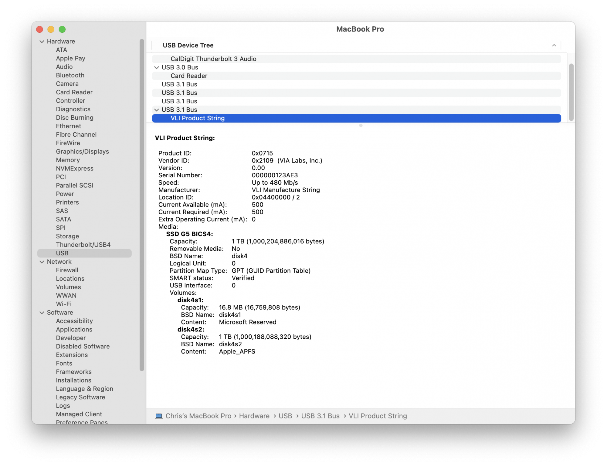

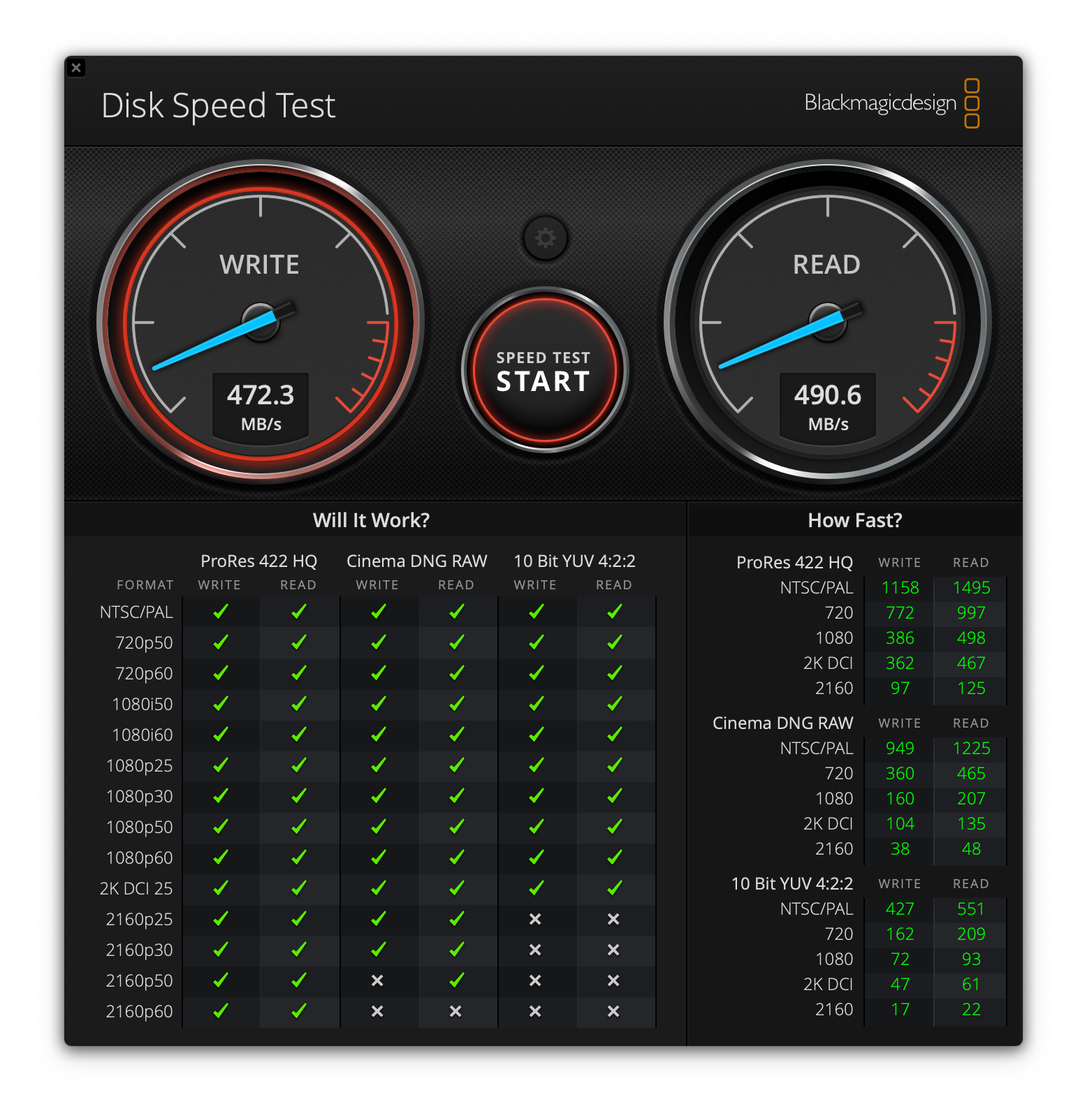

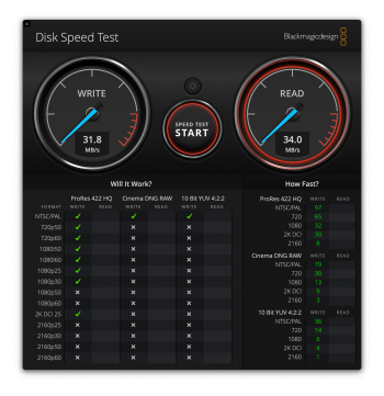

I’m having an issue using the usb-c 10gbps port on my TS3 Plus. I can’t seem to get the full speed out of the port.
I’m plugging in a 2.5” 10gbps SSD enclosure, using the cable that came with it. When I plug it in to the 10gbps port on the TS3 plus it only connects at USB 2 speeds (480mbps).
I’ve tried the drive in a few other configurations and it works as expected in all of them (plugged in to the USB 3 ports on TS3 (5gbps), plugged in to the TB3 port on the dock (10gbps), plugged in to my MacBook direct (10gbps)) This is all using the same cable too.
I’ve attached a few screens shots to help illustrate what I’ve written here. 2 speed tests and the system profiler report when plugged in to the USB-C 10gbps port.

You can click on the USB 3.1 bus to verify that it's the ASM1142 XHCI USB controller that you are connecting to. What driver is being used for that bus?
