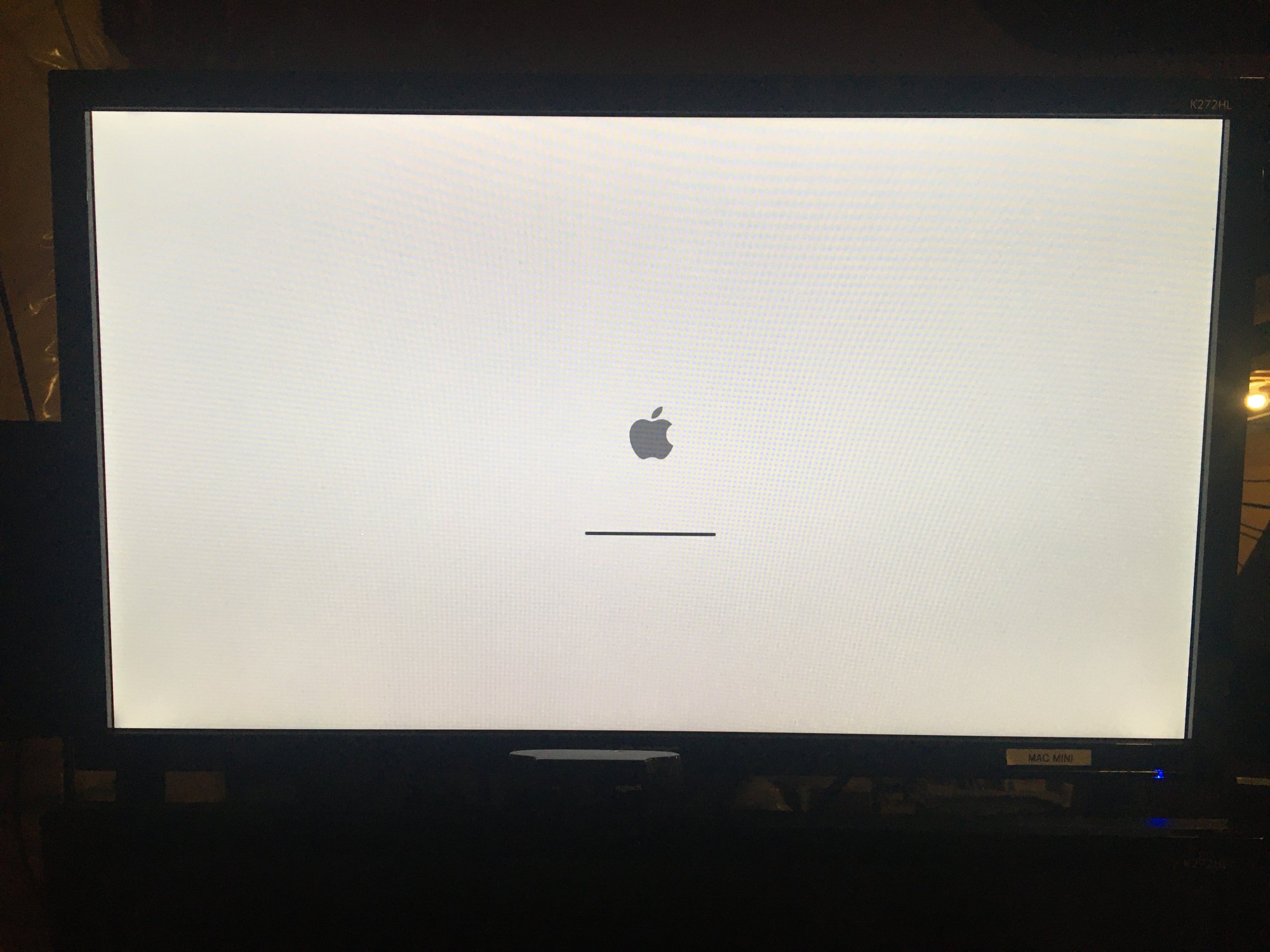

I followed dosdude directions precisely for installing Catalina on 2011 Mac mini multiple times. Does not get past apple logo install screen.
Mac mini has clean install of latest high Sierra and tried creating two USB drives. No dice.

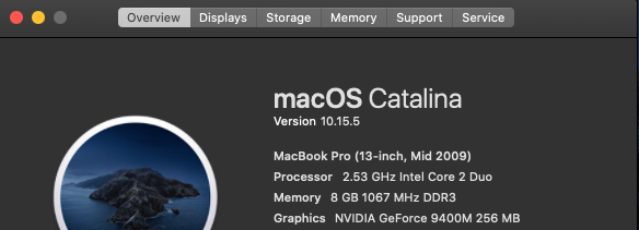

using dosdude1's patcher I managed to download Mac OS 10.15.5
Why not just go for the latest version, OS 10.15.6? When I last used dosdude1's patcher, that is the version I got.
Also, if you use either SuperDuper! or Carbon Copy Cloner for your backups, there is an issue with OS 10.15.5 that "complicates" those backups.
No matter what, it's better to get OS 10.15.6.
