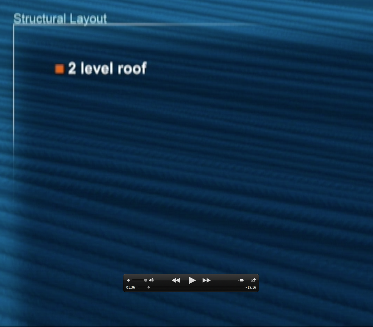

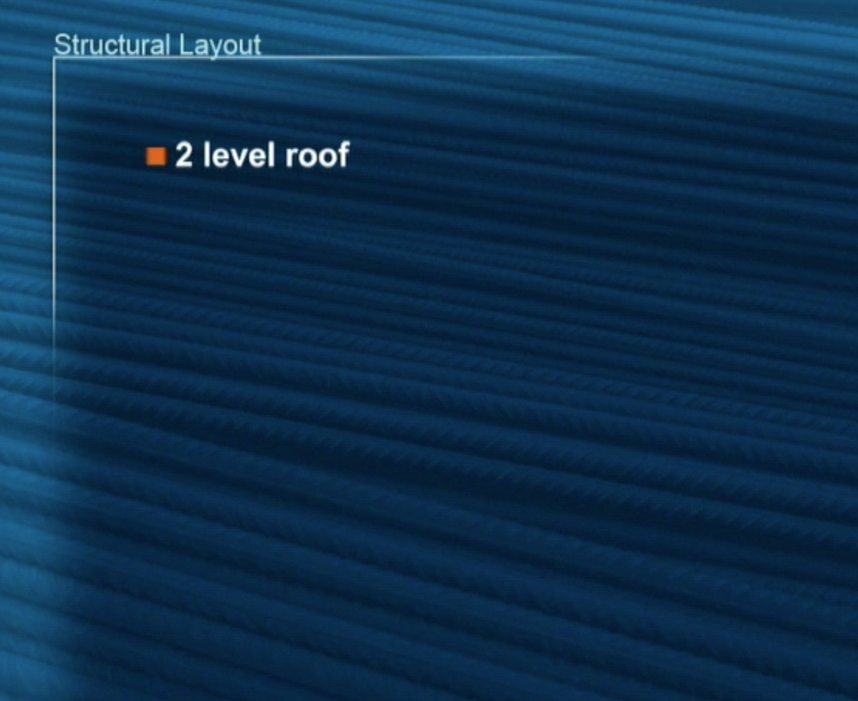

What's up, peeps! I'm having a strange problem with exporting footage in FCPX. Now, the footage is .MOV DV (720x480). I don't know if it's actually anamorphic or not because I didn't film it nor perform the initial edits and am just doing small corrections (cuts, dubs, etc), but FCPX "detected" it as 720x480 DV anamorphic. Frame rate is picked up as 29.97i. The unedited footage looks perfectly fine outside of FCPX (QuickTime, VLC) but after I've done edits and exported them, every other few frames is blurry and then back to normal again. This is with every one of the 12 videos in this project, and with some of the videos I only added a small 5-second text layer in the beginning.

Nonetheless, I have attached screenshots to show you exactly what goes on with the videos... every one of them. Blurry... not blurry... blurry... not blurry.

This seems to be a problem with interlacing.
Did you deinterlace the files before editing them, or during exportation?
That might be the issue... I didn't deinterlace the files at all, all I did was import them and start editing. I used Final Cut's automatically-detected settings (which I presumed looked "right" so I went with it and readjusted accordingly). I exported this same video @ 29.97i a little while ago and didn't notice any jumping from blurry to not blurry, but the video overall isn't as sharp as the original...
Always make sure you understand every little setting about the video files you will edit, particularly the interlacing which is very tricky!
