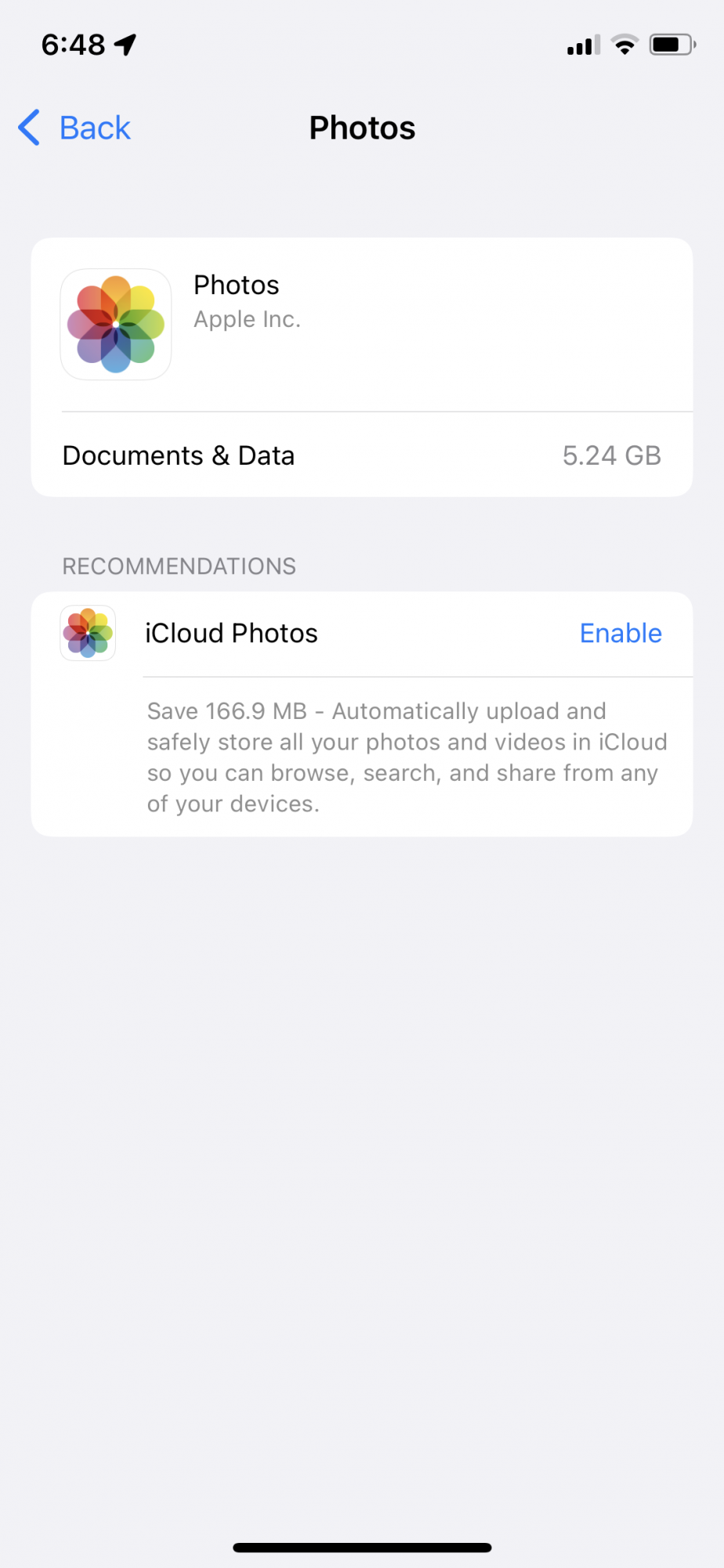

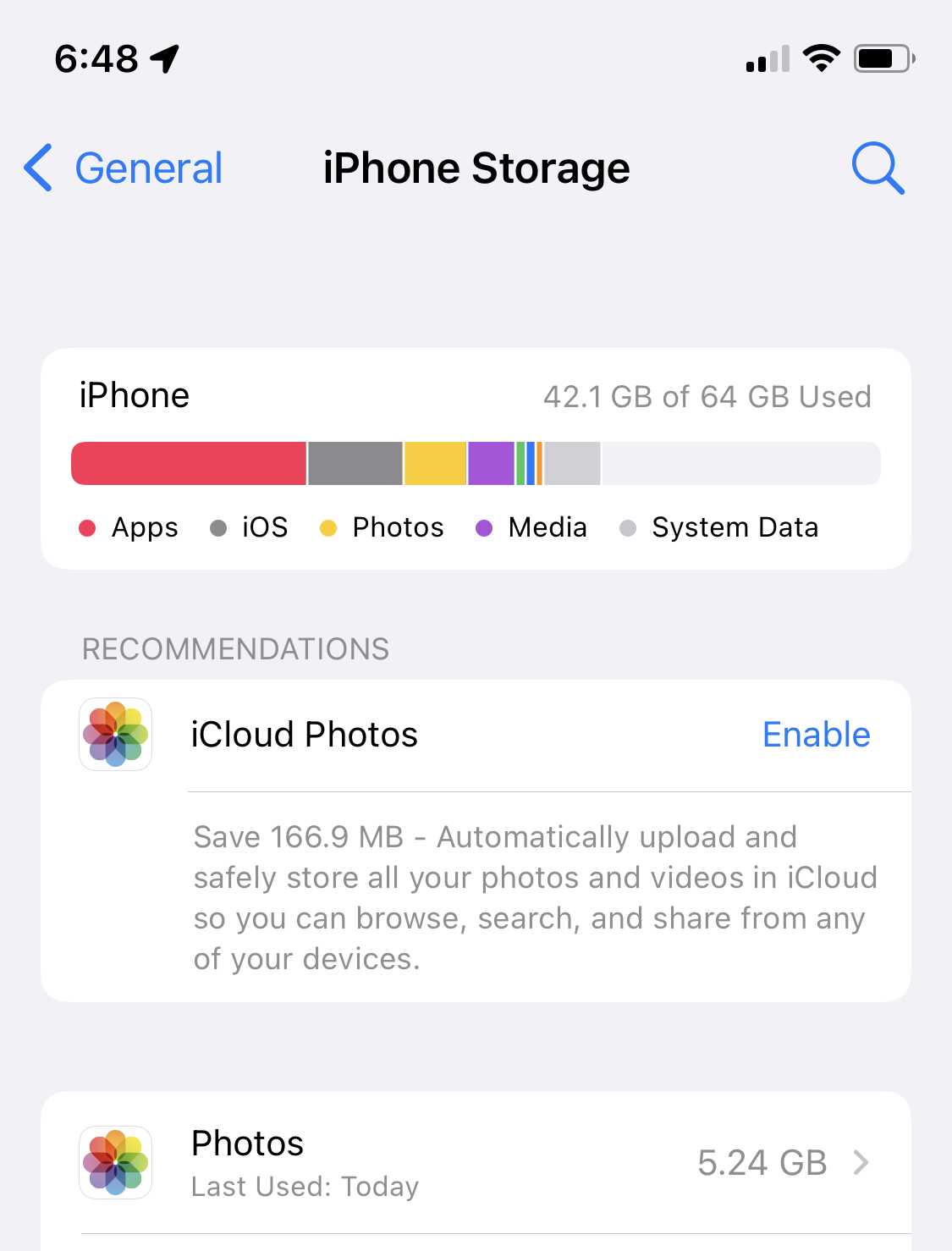

I only have 167 MB of Photos stored in photos, but when I go into settings > iPhone storage, it shows 5.29 GB of photos. I don't use photos in the cloud and I have already tried resetting and backing up/restoring my device. I have nothing in the recently deleted album either.
I've already called Apple and they escalated my issue to the engineering team, but that it''s been almost 30 days and they still don't have an update on my issue.
Anyone experience something similar?

Are you absolutely sure that the photos on your phone only consume 167MB? iCloud photos has an option to store the high res photos in the cloud, while retaining a lower-res, optimized version and then temp download the full version when opened? I know personally, this option does in fact save space and depending on your photo library size, can make quite a difference.
Yes, I only have 60 photos and six 10 second videos. I've never used iCloud photos, it's off and no photos are in the Cloud.
I've also Air Dropped all the photos to Mac, deleted them from the iPhone and Settings still shows over 5GB of storage.

Okay, no worries, just checking. Are you running 15.4.1? I know that iOS 15.X had a long lasting storage bug that would simply show inaccurate data. I am wondering if this bug is still present. When you said that you restored the device, did you restore a backup, or set it as new? If you had not already tried this, I would try first making a reliable backup, then restore as a new device, then set it up as a new device without restoring the backup and see if you are still seeing it.

Yes, I'm on the latest version of iOS. I Have not setup as a new device yet, but I suppose that is something I can try.
I do have a big collection of Photos on my Mac but I do not sync photos to my Mac and iCloud Photos on my Mac has never been used.

Okay, fair enough, it could simply be a bug. Does Finder report the same 5+ GB usage on photos? I would think if it is a glitch, a restore as new would solve it. It is really annoying to do this but I usually do this once a year.

Finder shows 6.21 GB of photos on the device (didn't notice that until you asked).

Okay, it is probably that storage bug then. Here is what I would do;
1. Create a backup(Local on mac preferred)
2. Go to settings and reset all settings(Not erase content)
3. See if the issue is still persistent
4. If it is still an issue, either ignore it or restore using finder as a "New phone" and not use the backup
5. If after all of that, you still see the issue, then restore your backup from step 1.

Actually, the photos storage menu on the iPhone is stating the 167 MB. If I enable iCloud Photos, it will upload all the photos in the Photos app and free up 167 MB of storage
I have no photos synced to my iPhone from my Mac. I have a combination of photos taken by the phone, screenshots taken on the phone and photos air dropped from other devices.
I see, so a deduction based on that statement. Mine says 3.45 GB for "Documents & Data" in Photos but only states I wlil save 1.18 GB by enabling iCloud Photos. However, I do have some albums synced to my iPhone from my Mac, so it may not be including those in its estimate.
Documents and data might mean a photos database that for some dumb reason starts at 5gb. It’s probably storage that you’re unable to reclaim.
Until you can find someone with less space than that being taken up, I’d assume it’s something we’re all facing.
Also - the way iOS 15 pulls images from messages into photos, maybe they’re taking up space there. And finally, what about “recently deleted”? Or albums shared with you that may be cached?
