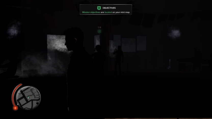

Has anyone seen an issue like this? n some games it looks like the models aren't being filled. It is kind of hard to explain, here is a screen shot:
You can see outlines and everything moves fine, but all is dark. This is from Sleeping Dogs and I've also had the problem with Hand of Fate. For the game Human Fall Flat, it isn't dark like this but the models are filled with static.

What OS version and NVIDIA web driver version are you using? Really hard to know what the issue is without more information.
Sorry. 10.12.6 and 378.05.05.25f04
Interestingly, I just booted using the OS X default driver and the game looks fine.
Is your GPU GTX 670 (post title) or GTX 760 (text reference)? Flashed or not?
As long as the game isn't using CUDA, you should be fine with the default driver. There's an issue with High Sierra & CUDA not recognizing the default driver with the latest update. Not sure if that also impacts Sierra.
*Sigh* Sorry, it is a 760, I'm always swapping the two numbers. Not flashed.
The issue with two of the games has been going on for quite some time, long before the latest updates. I never looked into it before because they were bundle games and I didn't care enough at the time.

You are running an old OS and an out-of-date driver. Any issues in the 10.12 web drivers will never be fixed. If you're running the web driver, you should always be on the latest OS to ensure you are using the most up-to-date drivers.

Doesn't change the fact you're running a legacy OS with out of date drivers. If you are experiencing issues with the 10.12 web drivers, be prepared for the fact that they will never ever be fixed. NVIDIA only updates drivers for the most recent OS version (10.13 in this case).
