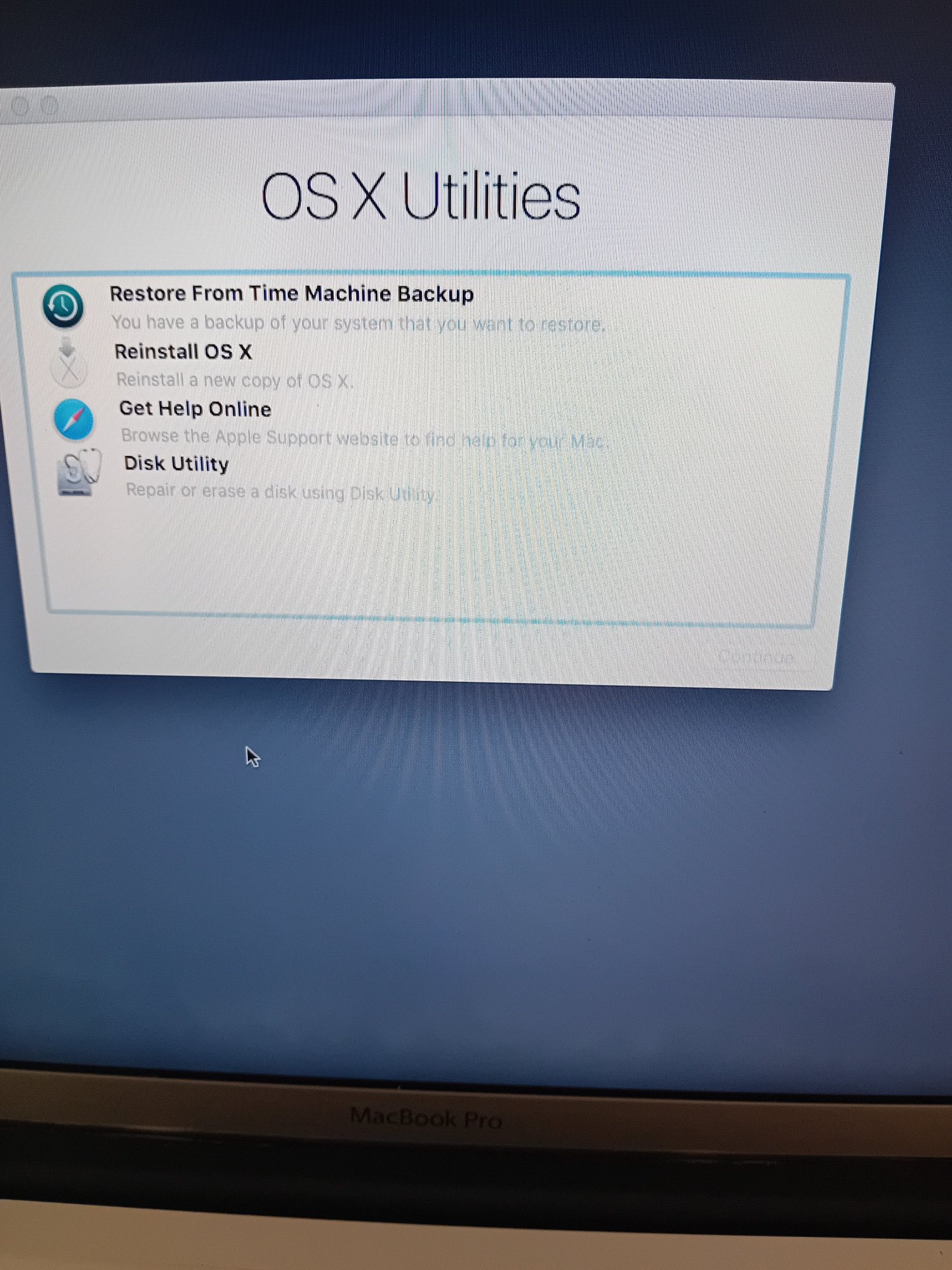

I erased the drive using Disk Utility, and then rebooted in Recovery Mode. I click the option to re-install a copy of the OS, go through the installation process and the computer restarts, only to return me to the OSX Utilities menu - see attached. I've tried it a few times, resetting pram and nvram, and booting in Safe Mode (Safe Mode doesn't seem to work).

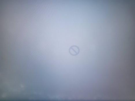

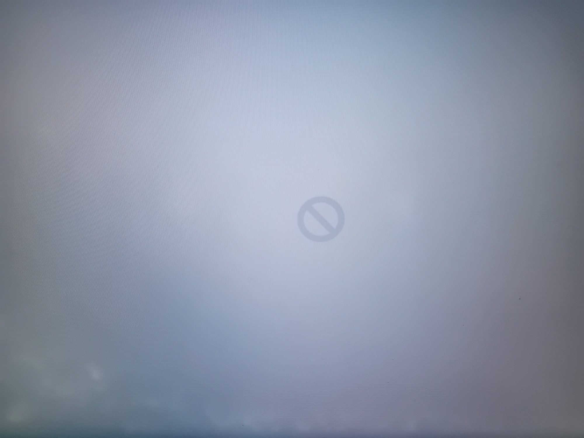

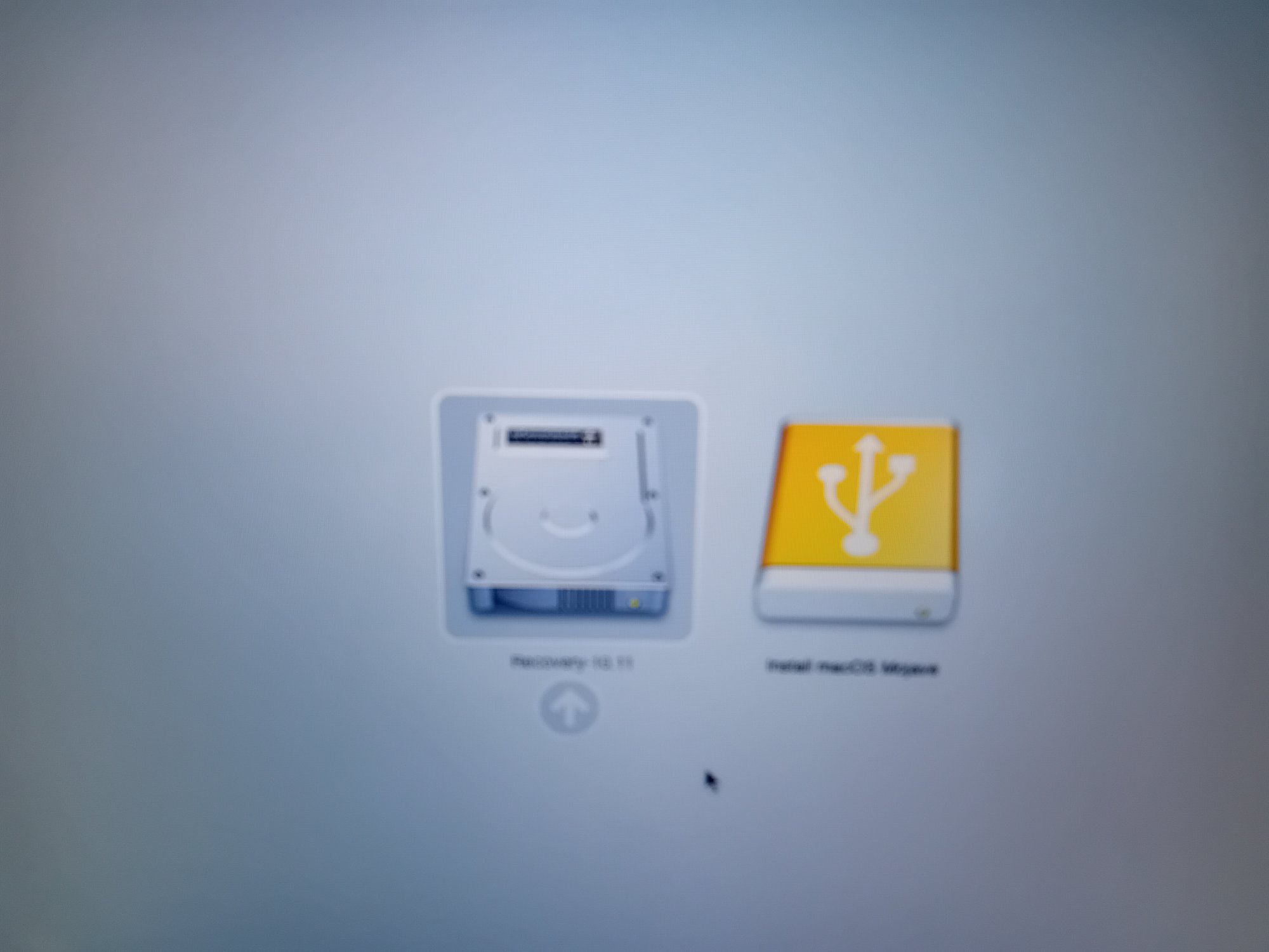

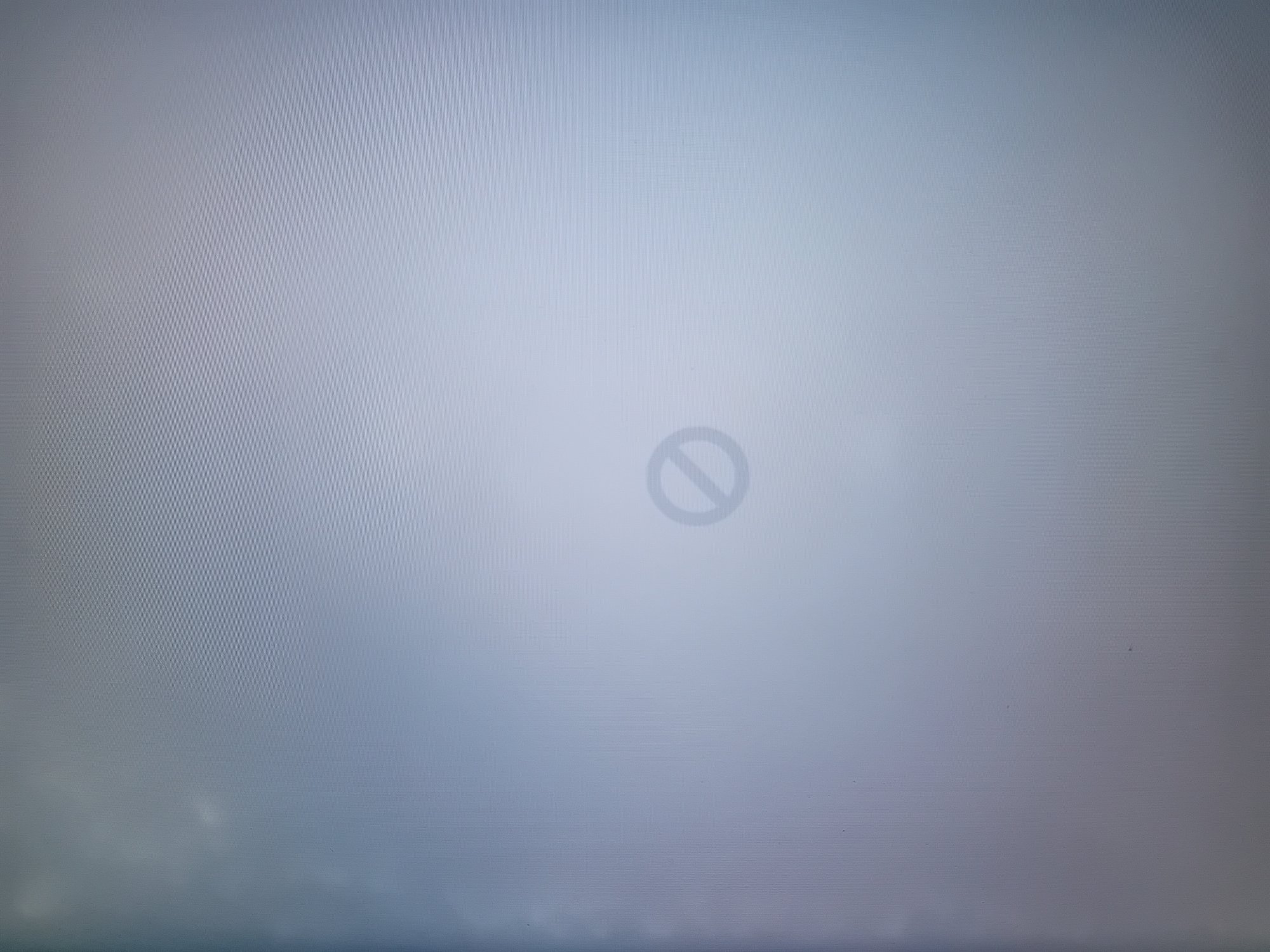

I tried to install Mojave from a USB drive (see attached -pic is blurry but first image says Recovery, second says "Install macOs Mojave". I click the install button, but the screen goes grey with a circle with a line through it, then the computer shuts itself down.

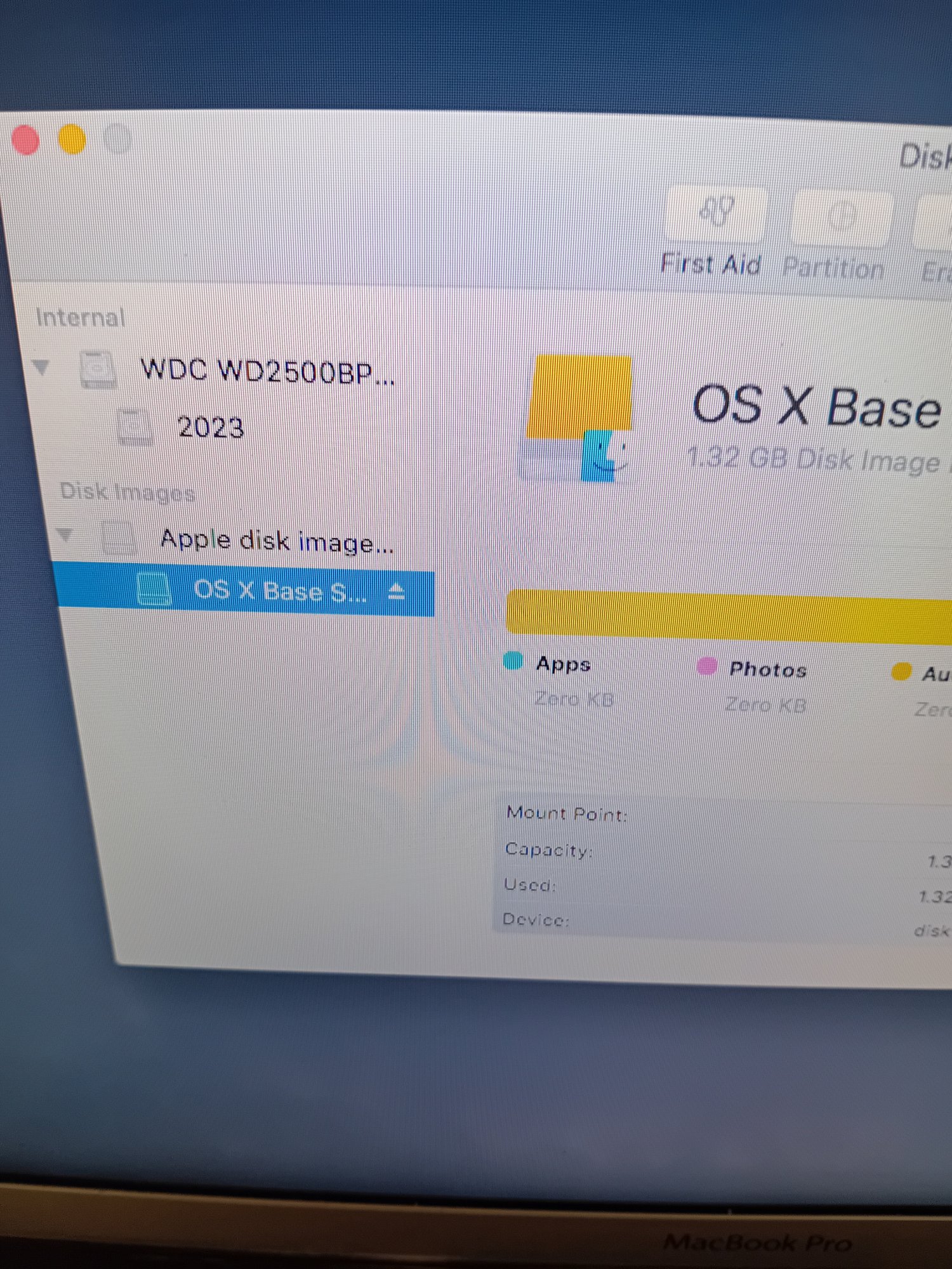

Also attached is an image from Disk Utility, these are the drives available. I'm not sure what Apple disk image or OSX Base System are, I'm trying to reinstall on the 2023 Disk, which I think is a partition of the one above it. Would deleting the partition do anything?

Followed the above steps but unfortunately I'm still having the same issue - I click to install High Sierra and the screen goes grey with the null symbol and then the computer shuts down.
Repeated the process but with El Capitan. When I try to boot from the USB, I'm just brought to the OSX Utilities screen after clicking the Install drive.
Just another update if anyone can help.. When I boot holding the Option key (without the USB drive connected), the only drive available is the Recovery. The internal HD is still recognised when I open Disk Utility however.
