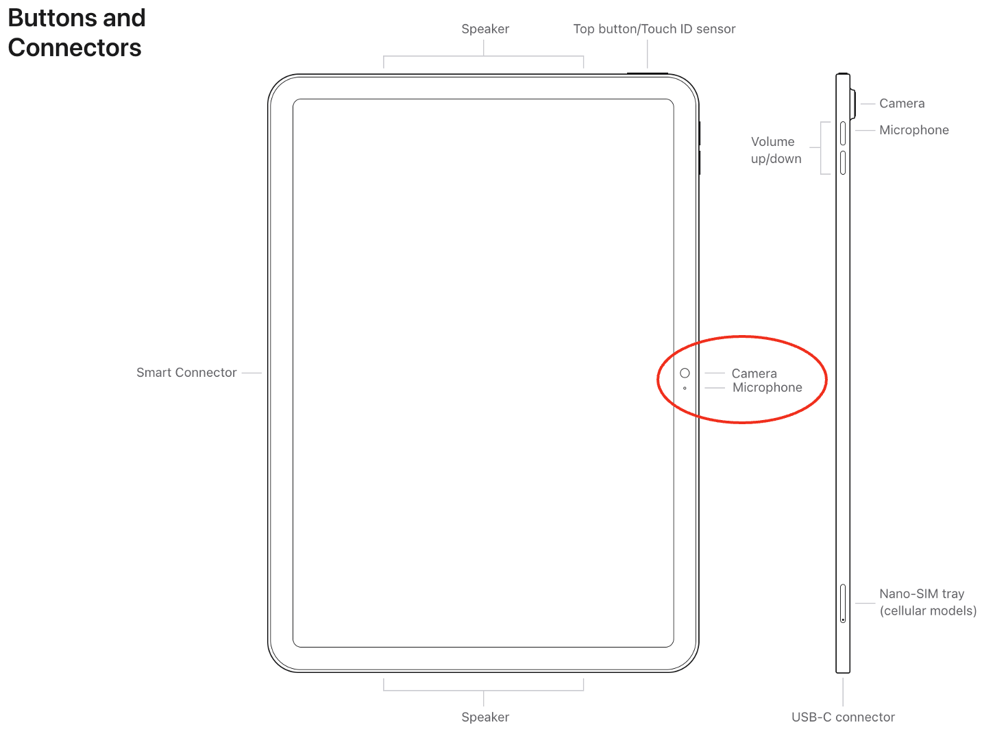

Btw I found out that there is indeed a microphone, just on the right of the front camera.

Just thought I would chime in. I had the same problem and I can confirm the issue was a screen protector I bought that blocked the microphone up by the camera. Once I removed it, the problem went way. I didn’t even know the microphone was there. And of course they sell notched screen protectors, which I bought and am waiting for. I wonder if I can get my money back for the other one I didn’t use.
Reactions: LeoG277
Yea, that pinhole mic is damn near invisible.. I dislike notched screen covers, this one seems unavoidable.
Yep - as you guys discovered:
I almost thought something wrong with my ipad 😭 glad i found this thread. I bought an ipad air 5 screen protector because 10th gen screen protectors isnt available at my country yet… And as soon as take off the protector i tried the microphone immediately and IT WORKED GOD.
