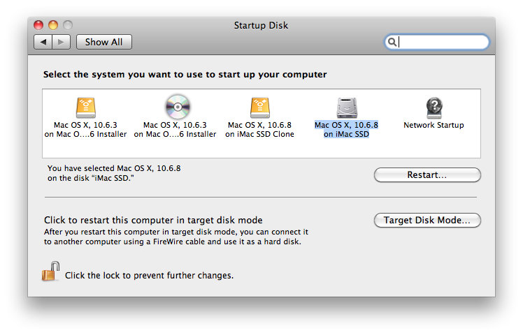

What happens, when you boot into OS X 10.8 Mountain Lion and go to System Preferences > Startup Disk*?

When I go to "Start up disk" in ML, I only see the ML disk, not the Leopard disk.
