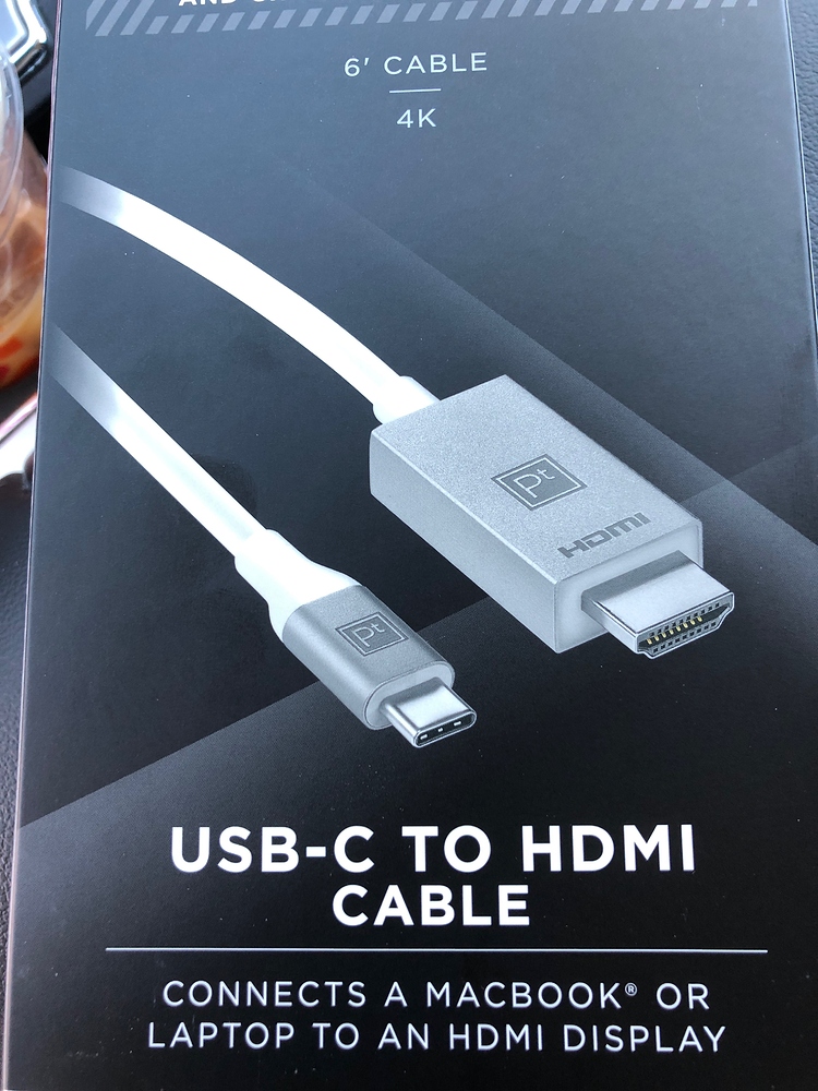

I ended up buying this cable.
https://www.bestbuy.com/site/platin...k-or-laptops-with-a-usb-c-port-gray/6367410.p
I’ll pick it up today and tell you how it is.
I picked up the cable earlier today, but I’ll test it tomorrow.
I have succeeded in linking my MacBook Pro to two monitors by using one USB-C to USB-C cable and the other cable being USB-C to HDMI. Both monitors are now fully operational.
