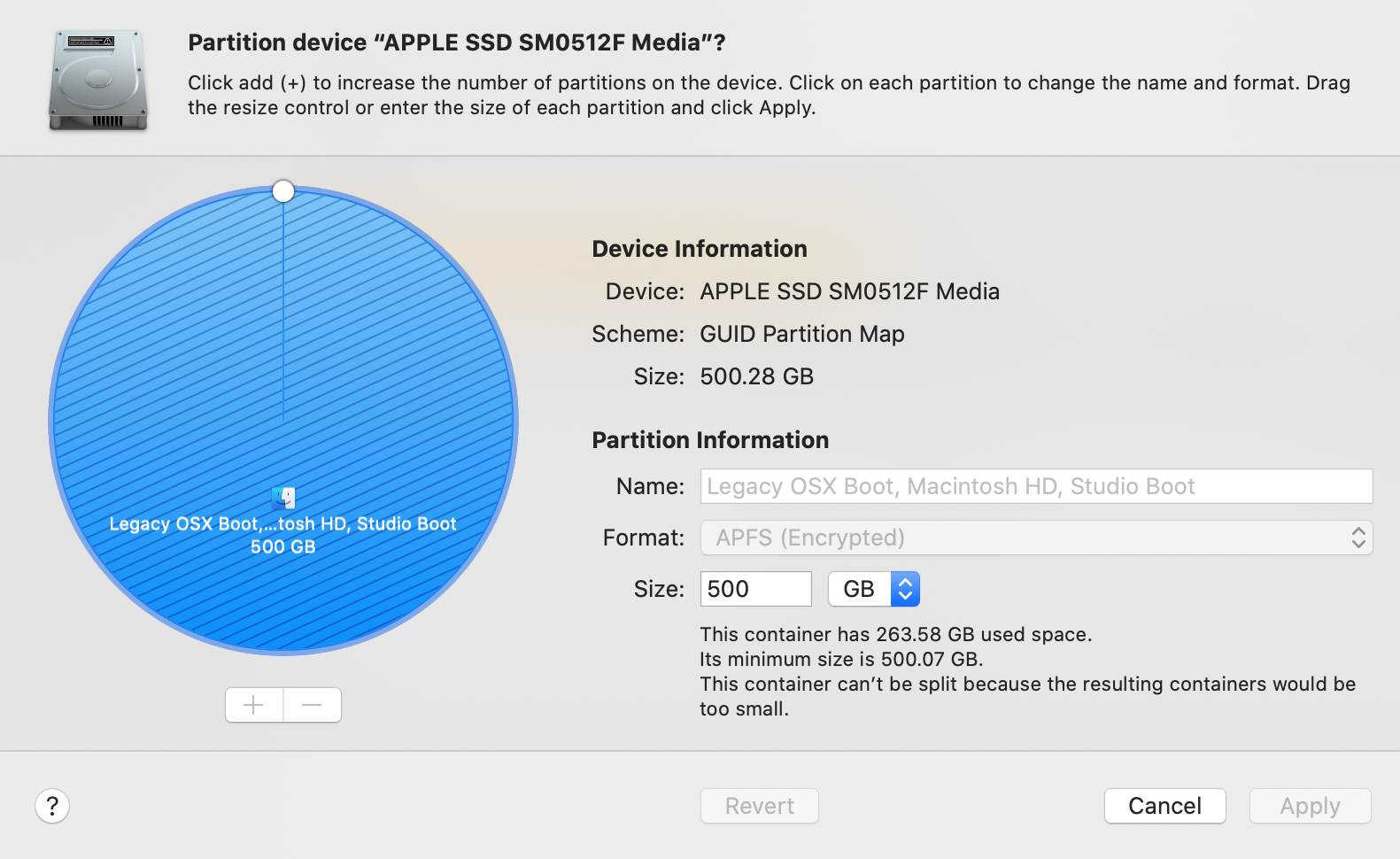

Partitioning my hard drive - went through disk utility and tried to partition but all of the buttons are greyed out, it says "This container can’t be split because the resulting containers would be too small", as you can see below i'm using just over half of a 500GB drive so plenty of space?

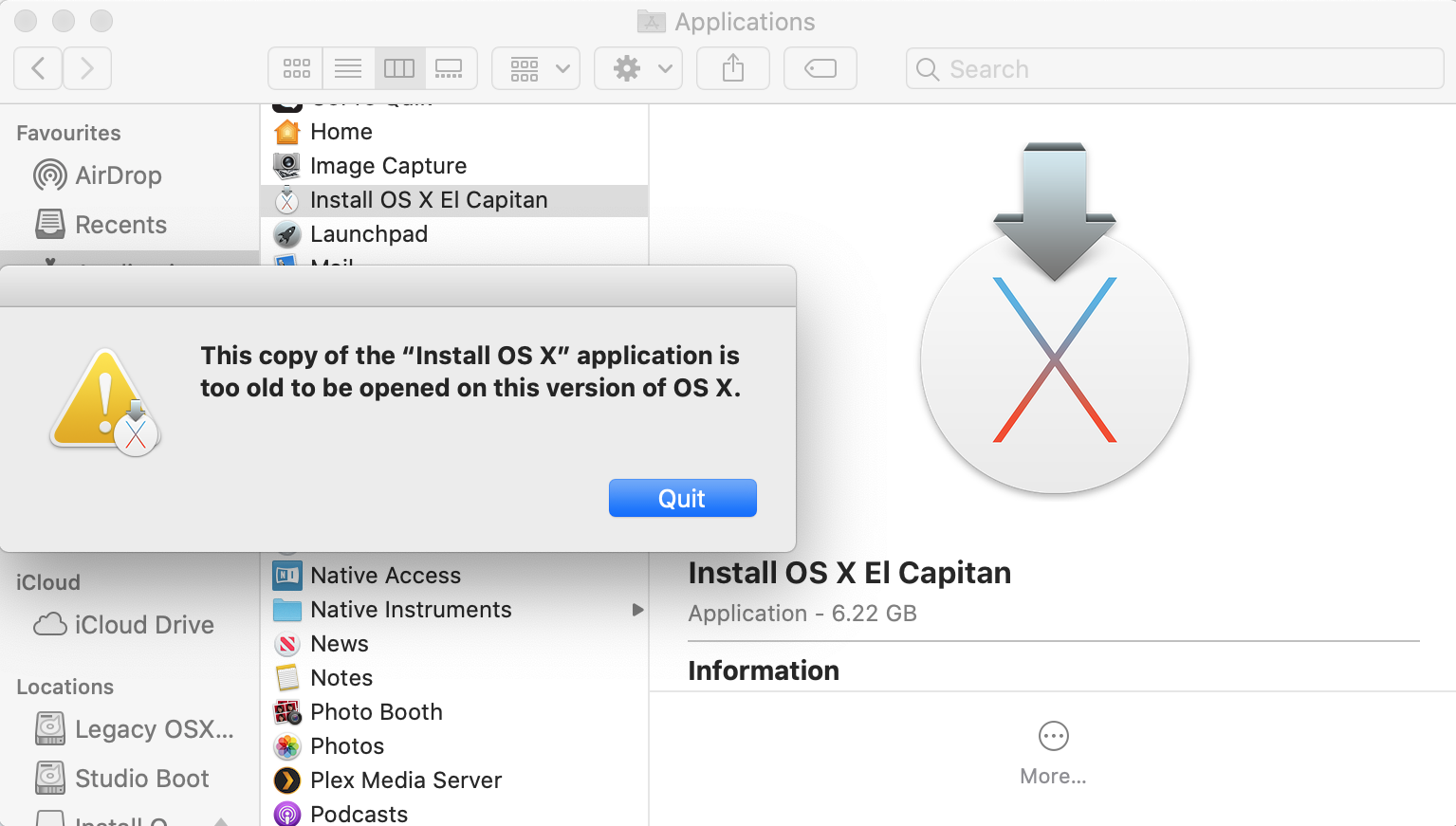

Next I try the El Capitan install (I'm in Catalina, but assuming I will get a prompt screen where I can select my new volume to install to) but get an error message that my copy of El Capitan OS is "too old to be opened on this version of OS X (i.e. Catalina), note I D/L the install file from the Apple site.

As per the first image i posted though, I can only seem to create new volumes (which have no option for HFS). When I try to create a partition it says the container can't be split as the resulting containers would be too small and i'm unable to adjust anything in the partition creation screen? any ideas?

You can't use the El Capitan installer within Catalina to install to the partition. You'd need to create a bootable installer USB (which CAN be done within Catalina) to then boot to in order to install to the second partition. This is assuming that the machine is old enough to have support in that older OS.
You might be able to resize the hard drive by shrinking the APFS partition and create a new partition for HFS+. According to the picture, your APFS is using about 263GB.
