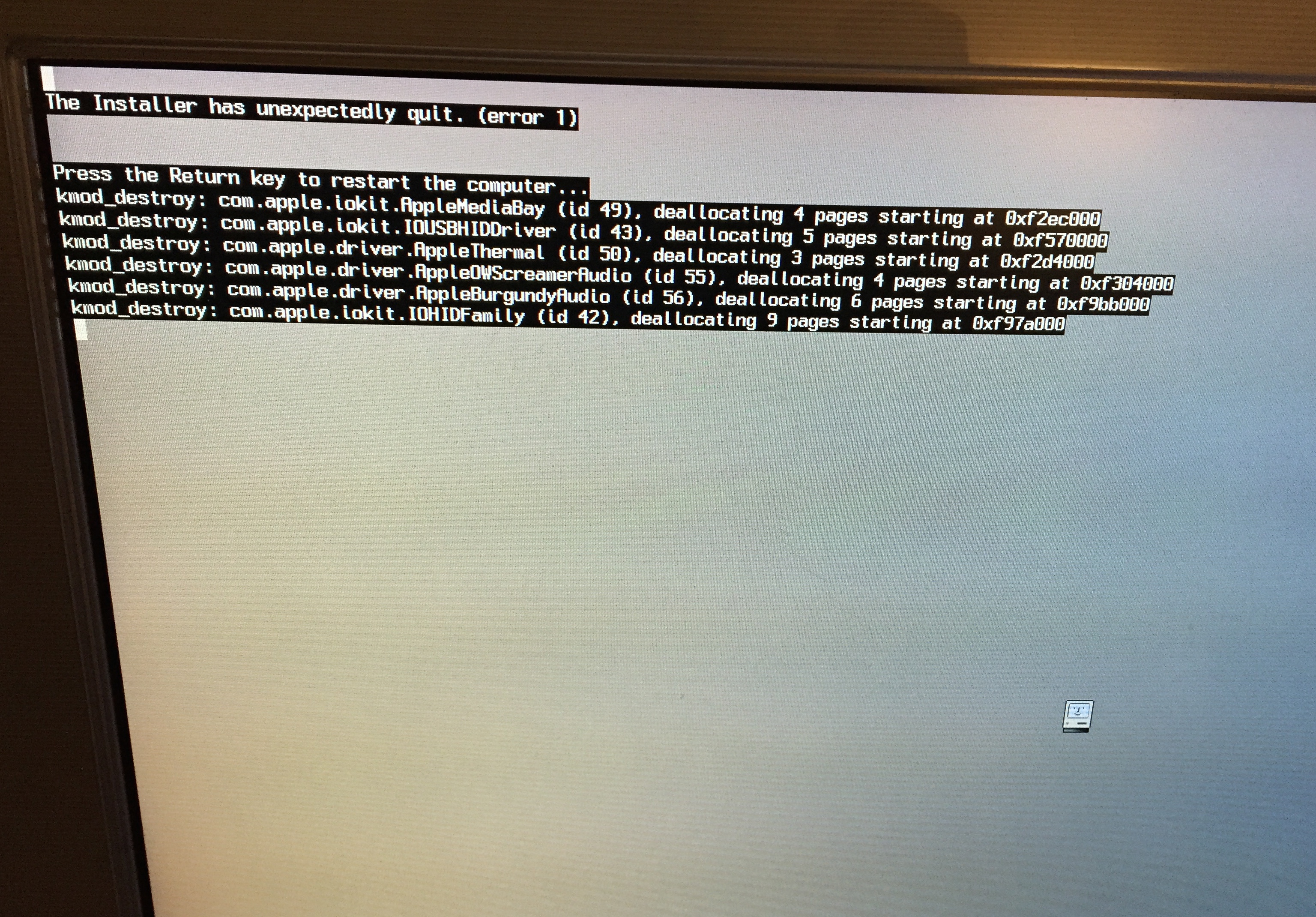

I'm running this in parallel to my GigE thread about OS installs, but thought I'd post this problem separately to see if anyone has any ideas.
Whenever I try to run the 10.0.3 install disk, I get the below error during booting. I'm using an original 10.0.3 pressed install disk.
The same error has appeared on two different system configurations:
1. Sawtooth 400mhz w/2gb RAM, Radeon 8500
2. GigE dual 500mhz, 2gb RAM, GEForce 2MX Twin-View. I've run AHT(short test) on this computer, and everything passed. I've also successfully installed OS 9.2.2, Panther, and Leopard(using LeopardAssist) on this computer. It runs fine on Tiger the Tiger install that was done on the Sawtooth.
I've done the standard stuff-PMU reset, PRAM reset, etc. I updated the firmware to the most current version-4.2.8.
Does anyone have any ideas about what could be going on here?

I didn't have problems with any of my Powerbooks that I installed it on and Apple's notes only warn of software modifications that could affect installations of updates. The only other thing to watch for is sufficient RAM, which is not an issue here.
It seems to be hanging before the GUI kicks in so could you try in verbose mode and see what particular bit of hardware is freaking it out?

it Looks like window-Server is failing to load I had a Very similar problem when I was Trying to install early versions of OS X on my sawtooth with a ATI Radeon 9200 it. Try installing on your sawtooth with a Rage 128 in it.

It's on the GigE. Unfortunately, all may not be well, as the installer hung in the very first stages of installation(installing BSD subsystem). I'm trying again.
I know early versions of OS X can be quite unstable (esp 10.0) if it keeps crashing try removing all but 1 ram stick and try again...
I think I have a stick of OEM Apple PC-100 128mb that I pulled out of a B&W-since I seem to be getting nowhere with it at the moment, I'll put that in the system and try installing again.
Sucess, although I did have a few "false starts" even with the single stick of RAM installed.
