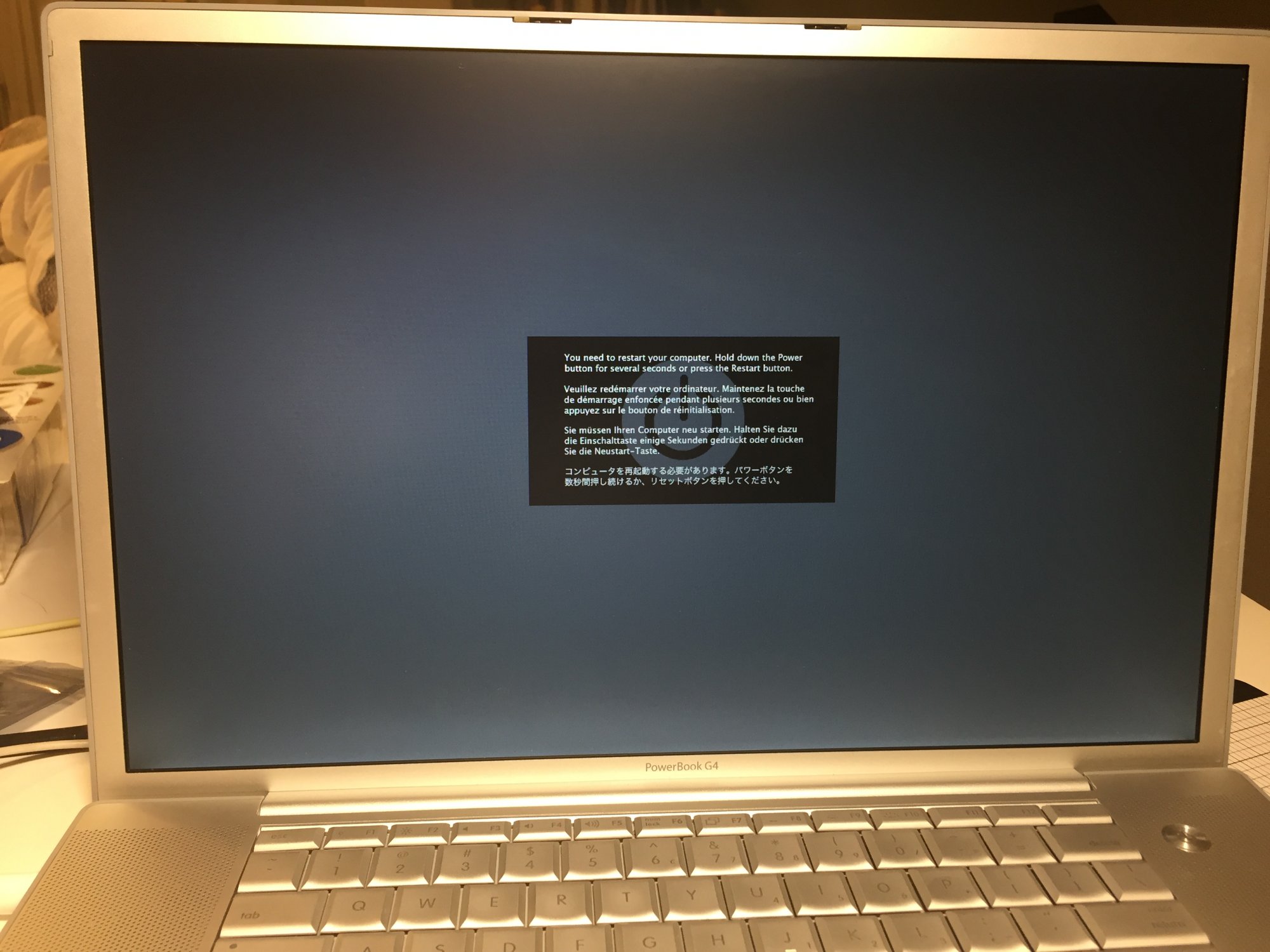

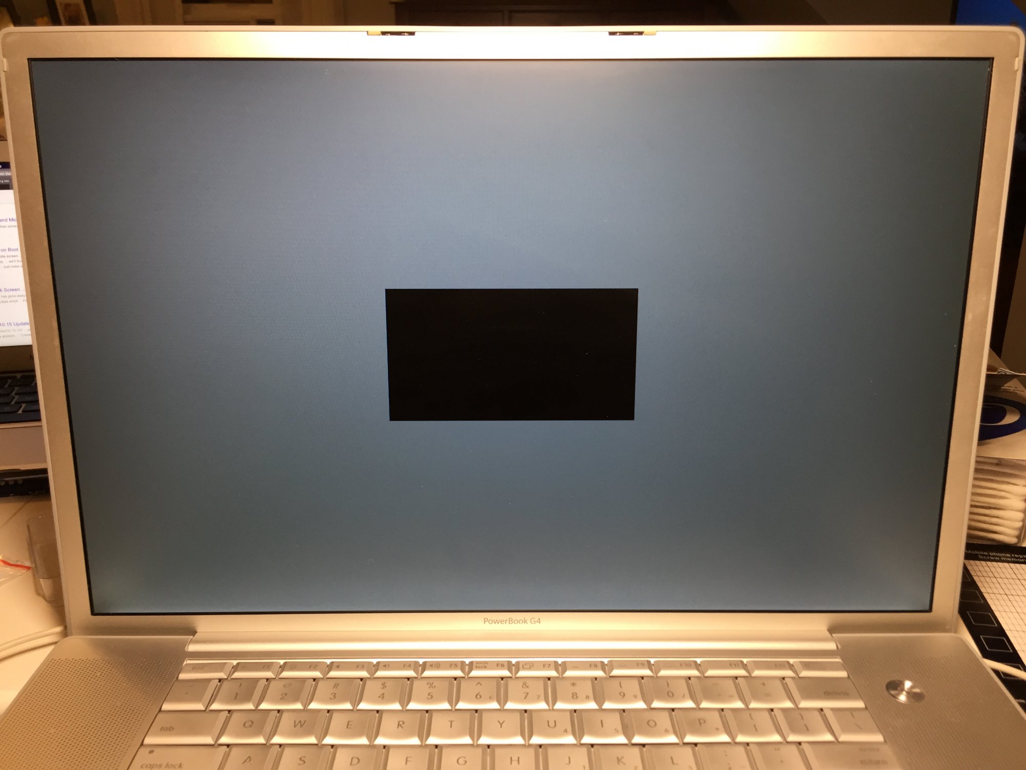

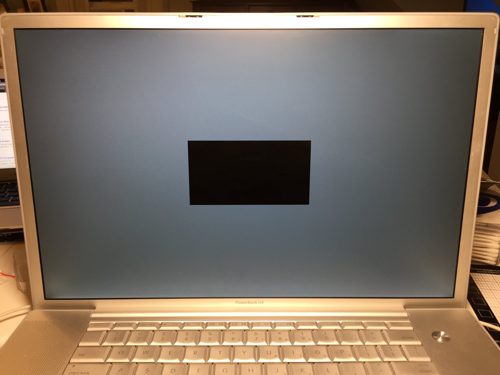

I just installed a new zheino ssd in my Powerbook G4 (A1139) and went about setting it up. I inserted the OS X disk, powered the computer on while holding down the option key, selected the install disk and then I got this screen.
What did I do wrong?
Wow, never ran across that before. Maybe a PRAM reset might help? What about cloning the old drive to the Zhenio & then reinstalling the Zhenio?
No luck with resetting the pram. I did notice another detail. It does go to the apple screen and then the black box comes down over the apple, almost like a curtain. I may end up cloning, but I was hoping to do a clean install.

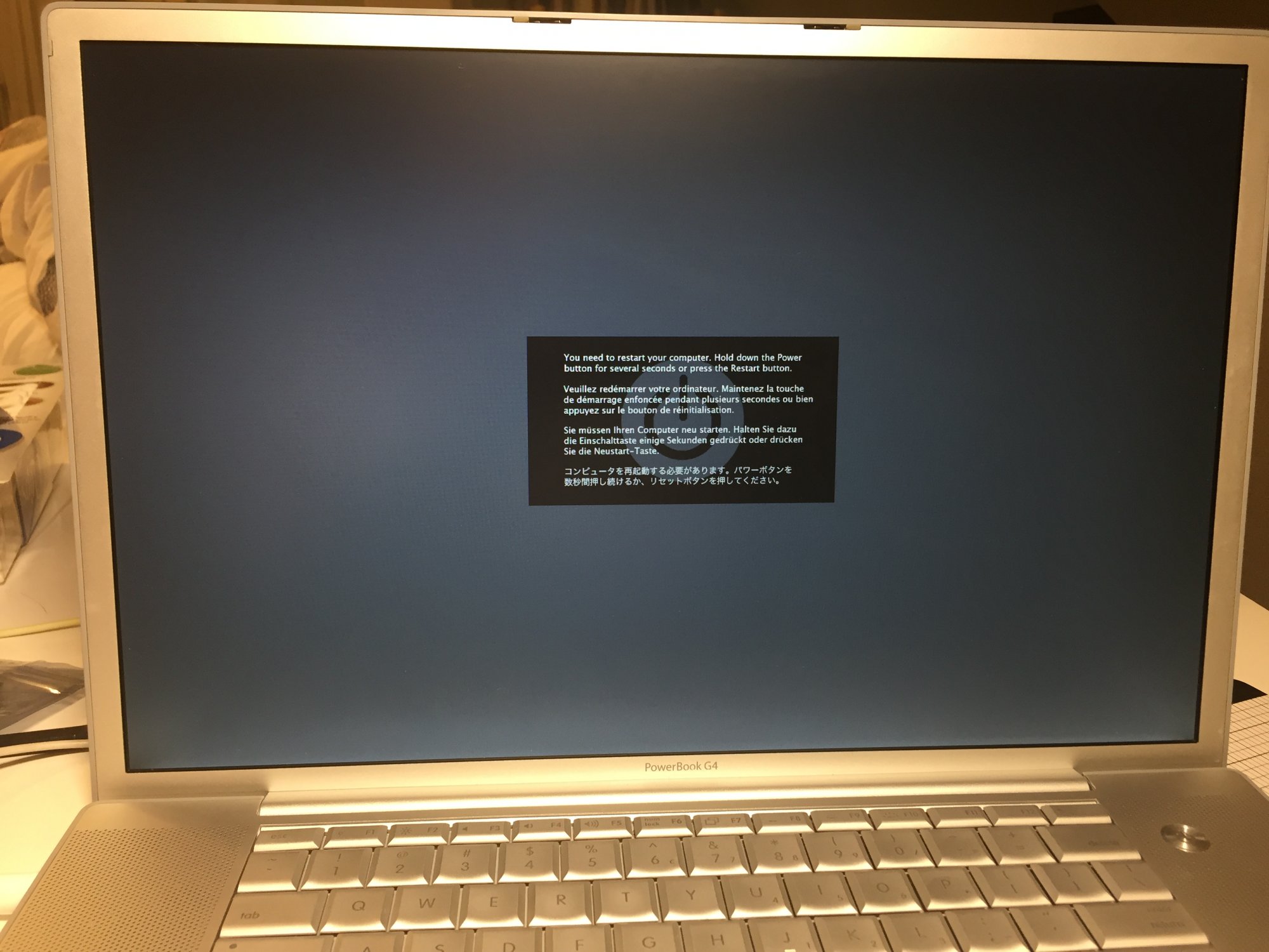

an update:
I swapped out the new hard drive for the old one and powered on the computer only to get this screen. I think this must have been what it was trying to display when I had the new hard drive in it and for whatever reason the words weren't displaying.
I tried to reset the pram and only got one chime before it booted on.
I tried taking out one of the ram sticks, tried to turn it on, and then swapped them and tried to turn it on and that didn't work either.
I have a Lion install disk in the optical drive and tried to eject it by holding down the trackpad button while it booted on and that didn't work either.
I'm not sure where to go from here. I'm getting really worried that I may have seriously messed something up when i was replacing the hard drive and thermal paste, and cleaning the dust out. I had to take out almost every-art to get at the thermal paste so I feel there was alot of opportunity for me to mess something up. I really hope I didn't. It was working fine before I opened it up. Please help. Thanks.

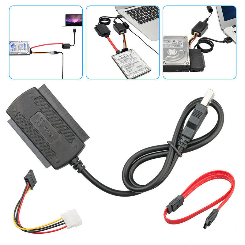

Do you have a recommendation for a reliable external HD enclosure? I don't have one yet and I'm having trouble figuring out which ones will work with these SSD's
I think I may be reaching the end of my ability with this computer. Does anyone have recommendations for reliable repair services?

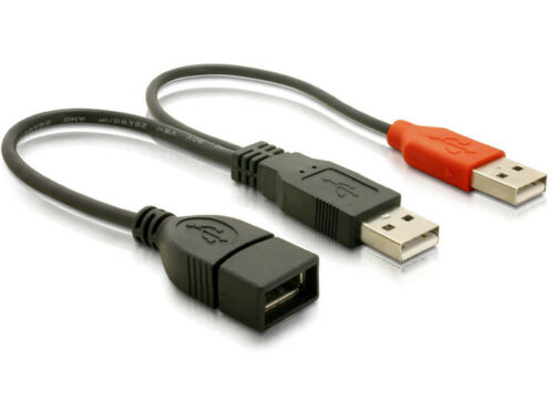

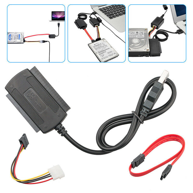

Oh, I forgot, it's an IDE-drive. There are probably no external-USB/FireWire-cases, like those ones, available for SATA-drives. I always use an USB-IDE-converter-cable for that purpose. Comes at about 5-10 bucks.
You need the big black connector and an maybe a Y-USB-cable for extra-power through the 2nd USB-port.
If you happen to get kernel-panics with the PowerBook's old internal-drive, then I'd try to boot the Book or any other PPC from that old drive via IDE-USB-cable, just to check, that drive and OSX-installation is ok.
If you're able to boot the PB from the USB-attached drive (booting while pressing the ALT-key to see / select from all attached bootable drives), the there might be something wrong with the internal IDE-drive-cable etc.
I bought a replacement external 2.5" HD enclosure earlier this year from OWC, called Mercury-on-the-Go Pro, which was reasonably priced and is probably the only remaining enclosure still being sold OEM new which has FireWire 800 (and also has a USB 3.1 port, which is of course backward-compatible to USB 2.0). Edited to add: but this is only for SATA 2.5" drives. Yours is PATA/IDE.

as for the IDE converter, would this do the trick?
If think it has both the conversion and the power built in?
Yes, that would work, per the suggestion @bobesch offered.

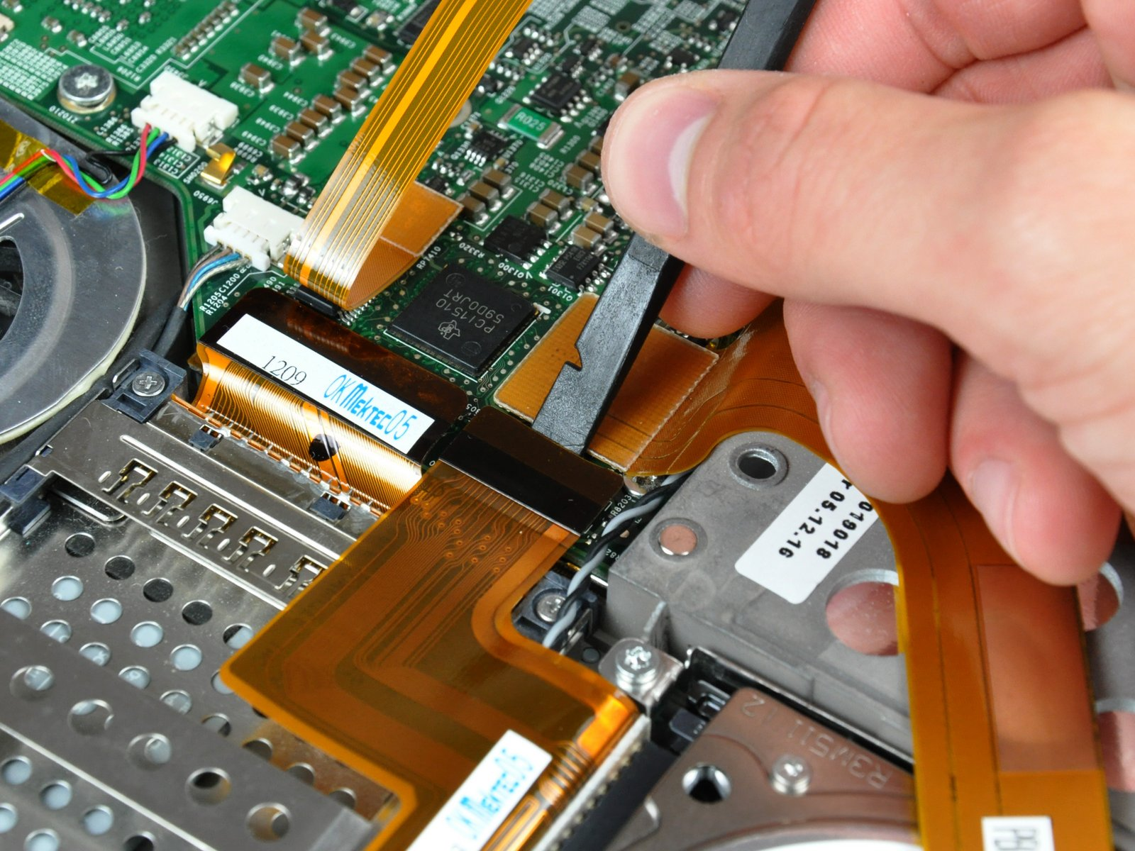

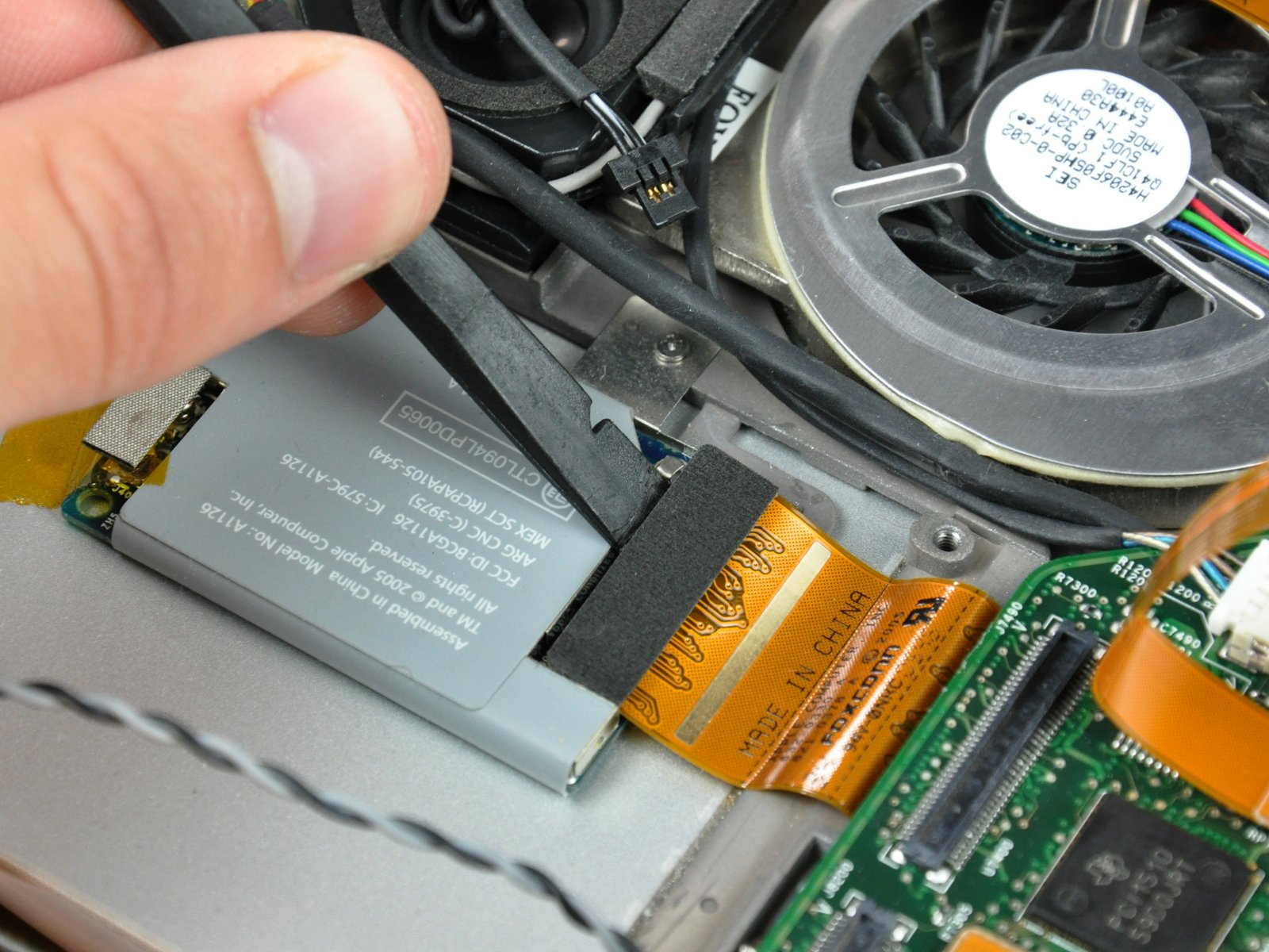

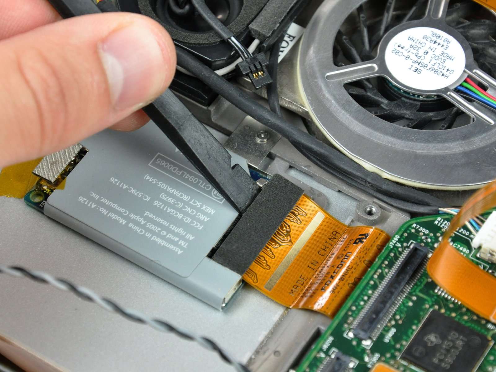

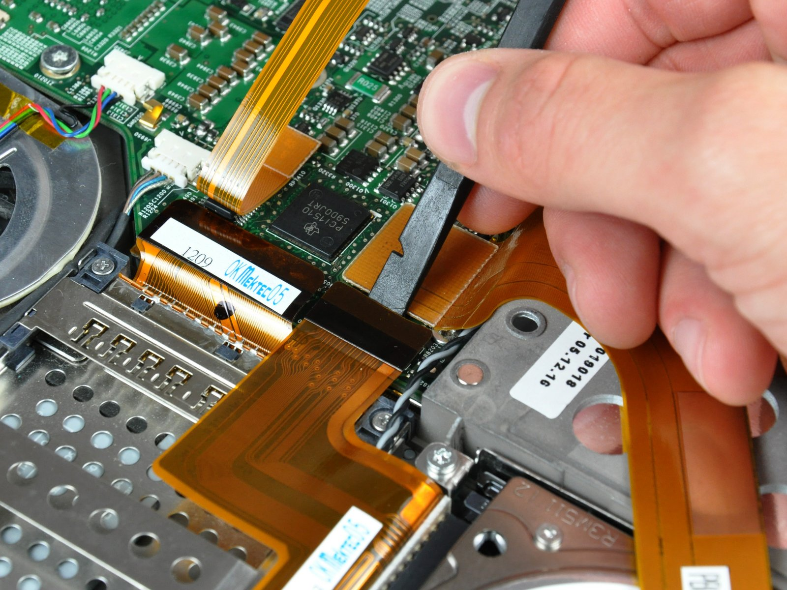

iFixit is an excellent resource. I’m going to paste below two pics from their respective guides the things I would suggest to just leave disconnected for now, while you’re troubleshooting. (Neither being disconnected will make the boot-up issues any worse than what you already have.)
Disconnecting the Airport/Bluetooth flat cable, Step 22:
When you get to Step 22 and you disconnect the cable from the Airport/Bluetooth card from the logic board, use the next guide to disconnect the PC Card cage from the logic board
PC Card cage replacement, Step 16
After you’ve disconnected those two flat cables, just leave them where they are, as-is, and reassemble the laptop. Once you’ve put it back together and you’ve got the keyboard reconnected, try powering it on again and hold down either the Opt key or the T key until the display shows up — hopefully in a shade of blue.
If you don’t get a blue screen of any kind and instead you get the same grey kernel panic screen, then the problem may be more involved. But I’m keeping my fingers crossed for you.

What happens if you disconnect the HDD cable and attempt to boot? It should get stuck on a blinking disk drive icon.
If so, I suspect your HDD cable/connector is borked. You can further confirm this by attempting to boot via an external HDD or another mac in Firewire Target Disk mode (as mentioned above).
["How to disconnect the two flat cables in question for testing (iFixit)"]
I finally got the energy up to revisit this project and I think I have figured out the problem!
I took your advice and disconnected the airport card and Hard drive and voila! No more kernel panic! I plugged the hard rive back in and it booted on properly! I plugged the airport card back in and once again it went into kernel panic. so it seems that that is the culprit!
Since the airport card is not working properly, should I just remove it? Is there way to fix it or do I need to replace it if I want to access wifi from this computer again?
You can either remove it, replace it or boot into Safe Mode and remove the Airport kext extension (then reboot).
