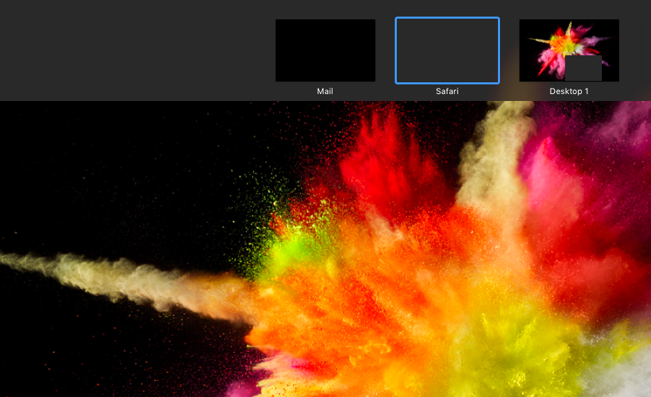

Here are some of the issues I've seen so far with the HooToo hub. My configuration is MBP 15" TB -> HooToo (for power + HDMI) and an external monitor (Dell 2405 FPW).
  • [NOT FIXED in Beta] Plugging in HooToo with HDMI occasionally doesn't extend the monitor (this works flawlessly on my old 2011 MBP so it may be just support for this monitor or HooToo or MBP). Need to unplug both the power and the HDMI cable to reset this.
  • [FIXED in Mac OS Sierra 10.12.2 Beta 6] Occasionally Mission Control stops giving me previews at the top. Only way to reset this is to put the system to sleep (I think) or reboot. See attached screenshot.

I'm seeing the same thing in Mission Control after connecting my Apple Thunderbolt Display via Apple's TB3<->TB adaptor. Putting the machine to sleep doesn't fix it. In fact, it's still happening right now after disconnecting from the display and using the machine standalone at another location.
I just installed the latest Beta to see if this problem is fixed. Will update this thread if there's any improvement.
