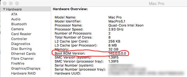

Theoretically. . it's impossible that your Mac Pro has that Boot ROM !
Go to ( Black Apple top left of screen 0
1. About this Mac.
2. Select "System Report"
3. In the next screen select "Hardware" ( top of the list ).
4. Look for "Boot ROM Version.
Take a Screenshot of all the hardware list except for your Serial number ( private )
Start Preview & in the Preview File menu . .at the bottom . .select "Take Screenshot".
Draw a rectangle around the info shown in the Hardware list ( don't show your Serial Number ).
Save it as a JPEG.
Post the resulting pic here please.
Example : This is from my 4,1>5,1 cMP

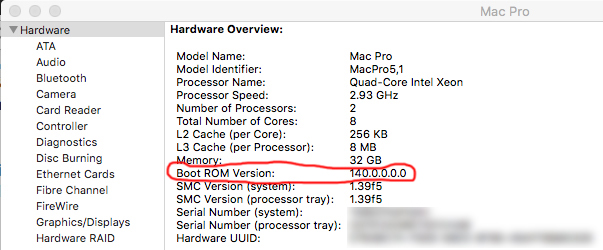

1. About this Mac.
Save it as a JPEG.
17G2208 is the OS build number, OP only said he has the latest 4,1 Boot ROM, which I assume is the version B07.
OK, I stand corrected. But including the BootROM version would have been useful. 🙂
To troubleshoot why he can’t flash his cMP to 5,1, yes, that’s critical.
And IMO, flash it to 5,1 is way easier and better than running a patched OS.
I wholeheartedly agree. he needs to show us step by step how he ran the 4,1>5,1 update.
It's easy to make a mistake .. .I did . 🙄. .
