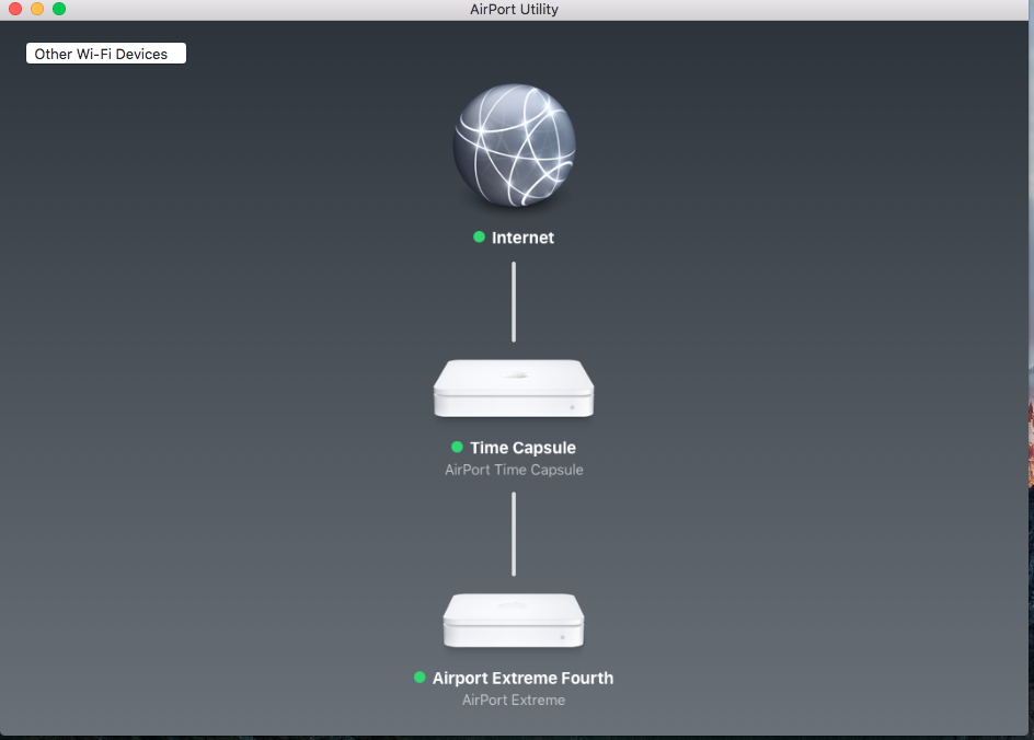

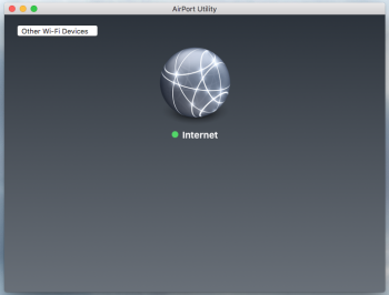

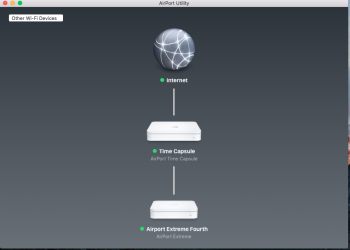

I'm not able to see my time capsule or my other router on my iMac. I'm connected to my TC via wireless. But with my laptop, I'm able to see them. Also connected to my TC via wireless.
The pic of just the internet is my iMac. The pic with both the routers is my laptop.
I've tried deleting the app, but the captain won't let me. I was however able to delete the prefs file.

At this point, you are going to have to set it up from scratch. Connect one of your Macs to it by connecting an ethernet cable to one of the LAN ports on the TC. Turn off wifi on that Mac. Then redo all the settings us Airport Utility.

This did the trick.... Sorta...
I only re-connected the ethernet cable to my iMac and turned off the wifi. I ran the utility and my routers popped up 🙂🙂. (I say re-connected cause I was having issues with Yosemite where my wifi connection was dropping. So I connected via ethernet and all was fine.) So I didn't have to reset anything and start from scratch!
So when I upgraded to El Capitan (fresh install) I kept the ethernet. But then removed it to test out the dropping issue. But with the captain, everything is stable. So maybe the switching caused something to get outta place.
But all is good now!!! Thanks to all for your input!!
