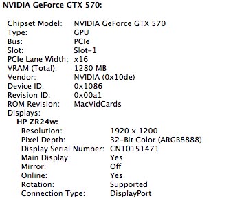

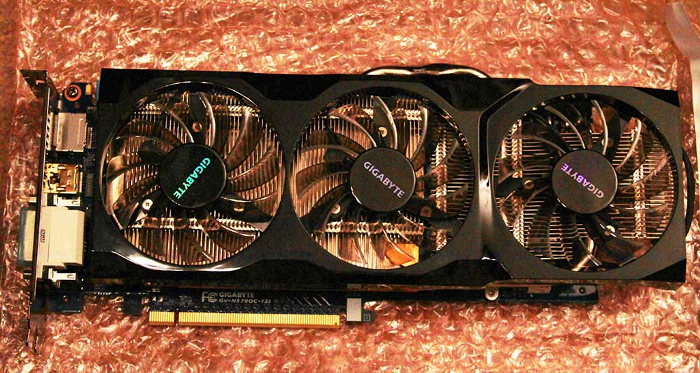

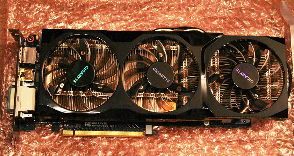

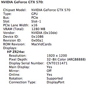

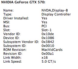

If you're interested, I have a MVC Flashed Gigabyte Nvidia GTX 570 that I was using in a Mac Pro 3,1 with good results. The Card is listed in the For Sale Section of this forum. I could let it go very cheaply.
Lou
