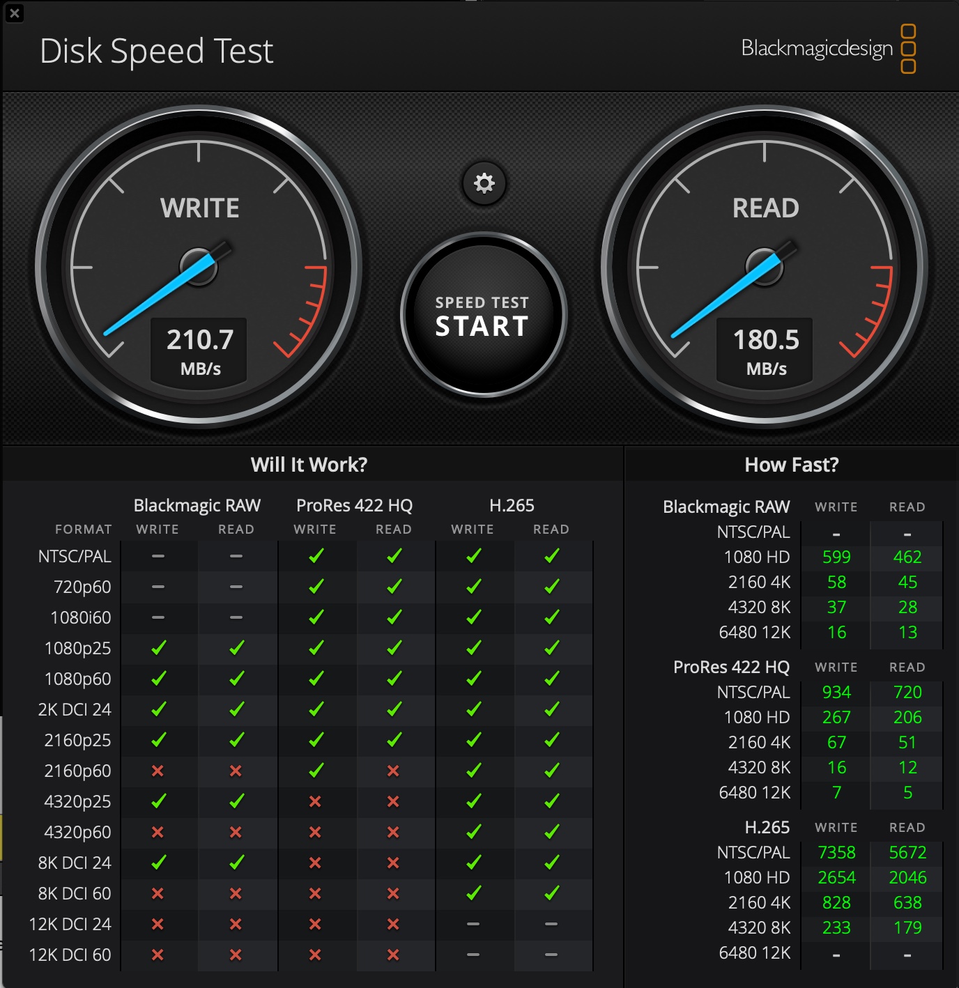

I'm having a miserable time trying to get an external M.2 SSD to work for me at all. I have a 4TB M.2 SSD and I picked up this ORICO enclosure (https://www.amazon.com/dp/B08G14NBCS?psc=1&ref=ppx_yo2ov_dt_b_product_details) with the Realtek 9210 which I'd read was the chipset most compatible with Macs in general. My issues are twofold:
- First, the drive disconnects constantly. Sometimes I'll get an hour or two, but often times it's less than 30 seconds before it disconnects. It always reconnects immediately, but that interrupts the file transfer. I've been trying to move a couple terabytes to it for a few days now and I haven't gotten more than 500 GB successfully transferred. I've tried formatting the drive both as APFS and as exFAT with the same result.
- Second, I can't get consistent performance even when it does stay connected. On large transfers either to or from the internal SSD on my 2019 16" MacBook Pro I'll see transfer speeds bouncing around from 300 MB/s to 50 MB/s. Transfers to an from a hard drive are similar. Blackmagic disk speed test will sometimes show around 200 mbps and sometimes almost nothing, see the attached screenshot, and often the speed rises and falls dramatically during the run as observed with iStat menus. I did have one instance when it wrote at 100 MB/s and read at 950 MB/s, with the read speed being what I'd expect from a 10 Gb/s bus width and an SSD that should be capable in excess of 2000 MB/s, but that's the exception to the rule.
In general I've had better luck with the disconnection problem by plugging it into my CalDigit Thunderbolt 3+ dock but that's not a complete fix, it just reduces the frequency of the problem. The performance is just as bad there as it is connected directly.
I've tried updating the firmware on the enclosure to the latest but that doesn't appear to have helped. If anyone has any idea what I can do please let me know. I'm going insane trying to figure out how to get this supposedly high performance solution to work anywhere near as well as the spinning rust I'd like to move away from!
Edit: I'm using a 2019 16" MacBook Pro with the 8 core 2.3 GHz i9 processor. The drive's an ADATA 8100 and I get similar results with the drive stone cold, so it's not an overheating problem. I've tried about a half dozen cables I have kicking around all with the same results.

Those speeds aren't good.
Tell us which Mac you have and what OS is on it.
Who made the blade drive inside?
I have an nvme blade SSD in an Orico enclosure (not the same one), and it can get 800+MBps reads.
Be aware that under HEAVY write loads, nvme blades can get hot. When they do, this seems to impair read/write speeds, and the enclosure/drive may "throttle down" to lower speeds to compensate.
You might try a different cable.
I would get a "high speed" cable that also is rated for charging.
(Yes, I know a cable may have come with it, but sometimes a different cable works better)
You might try a different enclosure.
There are several threads here in the MR forums regarding external drive disconnects with macOS Monterey. I haven't followed them, so I don't know if there is any rhyme or reason to the problem nor if there is a solution to this issue.
From the speeds you are generally seeing, I would still suspect your cables. USB-C cables are notorious for not being the actual cable that you need spec wise. So, first of all, I'd make sure that you have a cable rated for USB 3.1 Gen 2 (10 Gbps). If you're still not able to get better speeds you could always take it along with your MacBook to an Apple Genius and see if they can troubleshoot for you. Assuming, of course, that there's an Apple store nearby.
