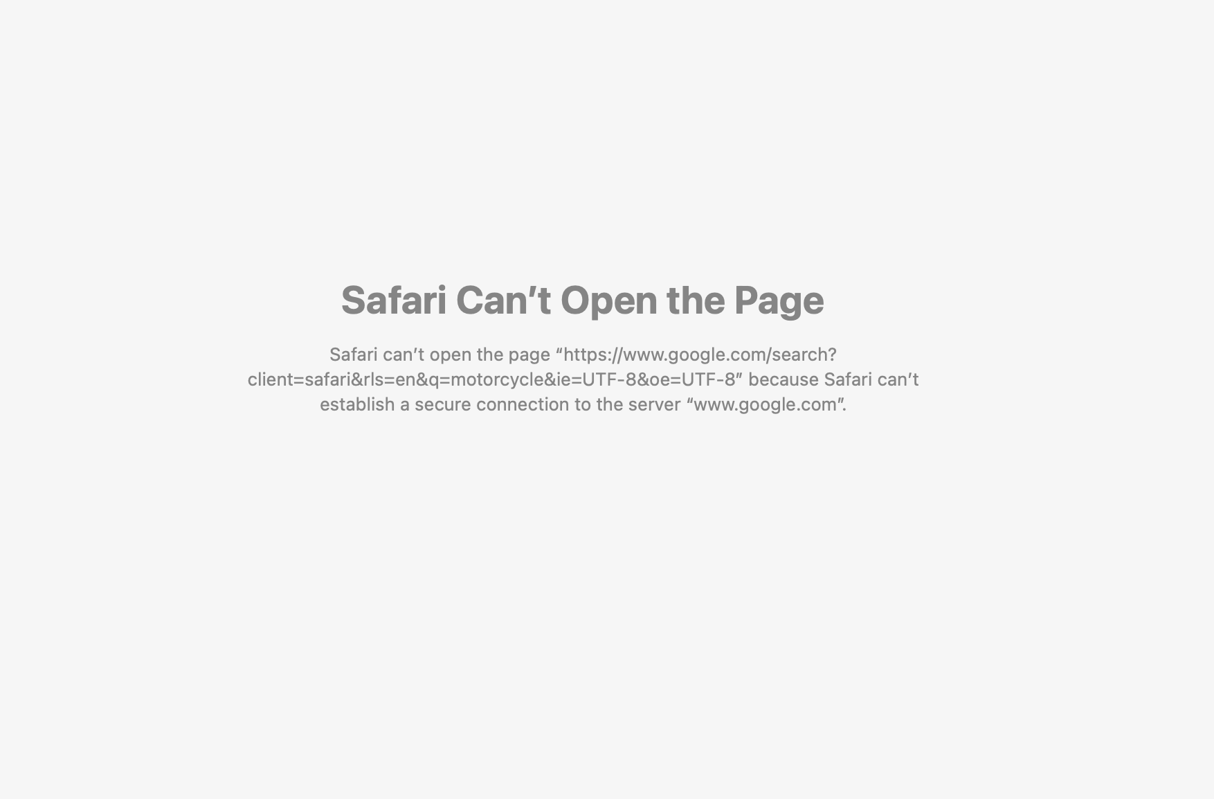

At work there are 2 of us on Macs and there is an issue on our main network. If I use the guest network everything works fine. On our secure network when I do a google search I get this:
Anyone have an idea of what is going on here? Safari does the same thing, just different verbiage:
Seems to be google specific. I can't load hangouts, gmail, etc. But other websites will load like this forum, CNN, CNET, Engadget, etc.

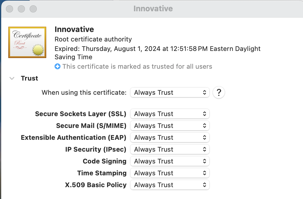

So back at this. I am in the admin account looking in keychain. Looking at my companies certificate in keychain to shows that it is always trusted

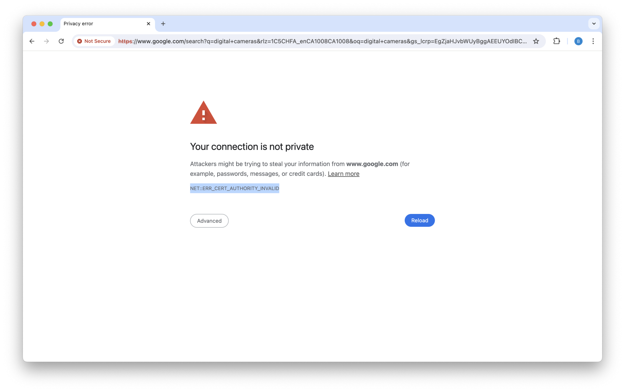

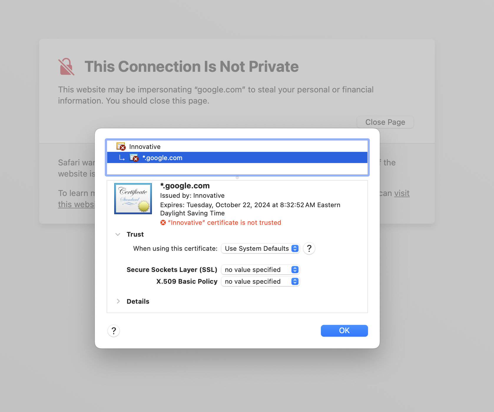

In Safari (and chrome) it comes up like this for anything google related:
Any ideas on why in keychain it is marked as always trust, but in Safari it comes in with the certificate not trusted?
The certificate in keychain is different for each user. Can you open keychain as your regular non-admin user and see if it's trusted there or not?
Found out the issue and it was a simple one. The certificate expired on August 1st so just had to get a new one. All is working as it should now.
