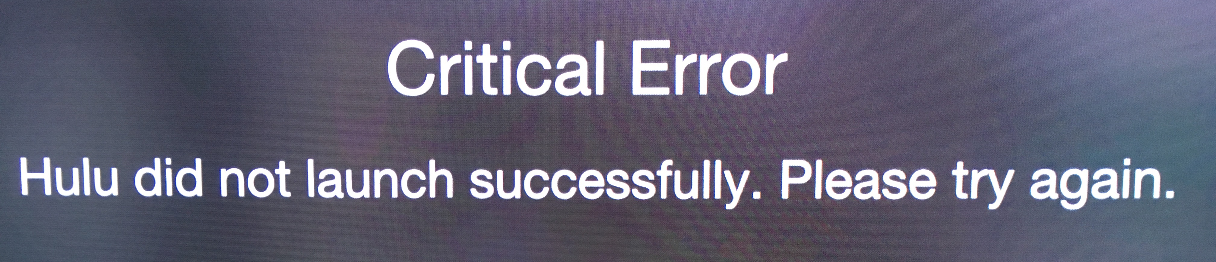

Anyone else having issues with Hulu on the new Apple TV? Using Unlocator to successfully use HBO Now and US Netflix but having issues with Hulu. When logging into my Hulu account I see a critical error and it freezes. Interestingly authentication is occurring as it warns me when I enter an incorrect password.
If I quit the app and return I see the same critical error message saying Hulu couldn't be launched. The only way to return to the 'welcome screen' is to uninstall and download the app again.
iTunes Store set to US etc so wonder whether Hulu is being geoblocked. Tried with UnoTelly and Unblockus to no avail.
Thanks

Think the issue must be at my end. Can't get it to work with any DNS service including those suggested above. Went as far as doing a factory reset and everything but no joy. All other apps working perfectly, just not hulu. Logged into my hulu account and under 'Manage Your Devices' I've seemingly activated no less than 20 Apple TVs in 24 hrs 😳. Maybe that's red flagged somewhere leading to the device itself being blacklisted? Reactivated on xbox one and a 3rd gen Apple TV again this evening so doesn't appear to be an IP issue. Contacted hulu support from my account and will see what they say. Can juggle between devices for now, but hope for a quick fix

Thanks for the feedback/suggestions guys. Still not working for me. Really can't see where the issue is after exhausting the possiblilities. Tried uninstalling, redownloading, restoring, logging into different hulu accounts, closing and removing hulu from other devices etc. Don't understand why this is the only app that is failing me, while my home network and DNS setup allow me to access content from HBO, FXNow, etc. and Hulu itself works fine on other devices. Still maintaining dialogue with Hulu Support to explore my options so fingers crossed. In the meantime I'll carry on watching on my other devices.

Well, after a few days of troubleshooting, I FINALLY have a solution to this problem and am posting it here in the event that others experiencing the issue stumble across this thread in the future. As a final throw of the dice, today I went out and bought a new third party router. Turns out the root of my problem was my BT Home Hub. It simply doesn't play nicely with Hulu on the new Apple TV, yet all other streaming services (incl. HBO Go and Netflix) were unaffected. The new router is working great, so if you'll excuse me, I've got some catching up to do!
