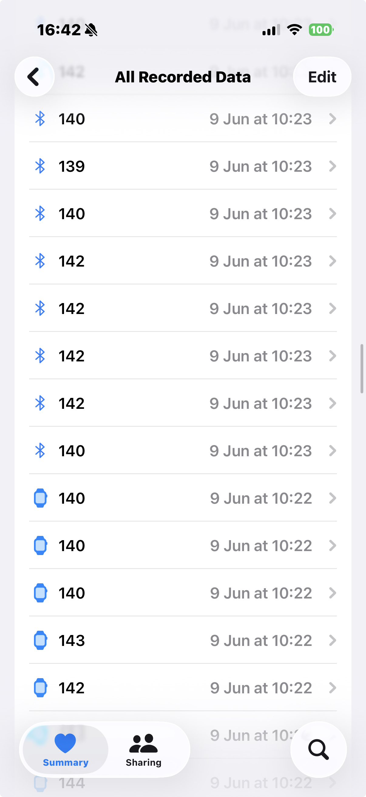

Just checked my run this morning in the Health app: source for heart rate monitoring switches repeatedly (for longer durations) between my AWU2 and connected airpods pro 3 (bluetooth symbol is used). Values seem to correspond, no anomalies.
I must say that I am impressed by the accuracy of the heart rate monitoring. I often run with a Garmin connected to an HRM strap and average heart rate recorded by my AWU2 is usually exactly the same as the Garmin. I know Garmin switches between optical heart rate and chest strap depending on what it considers most accurate. I would presume AWU does the same?

Apple Health contains two data stream showing that I was around 100 bpm and 190 at the same time. Both values cannot be correct.

That's a MASSIVE difference in heart rate readings. I went on a 2 mile run this morning and maxed out at 174 - but for about 20% of the run my band was too loose and it wasn't reading heart rate for that time. 😛 (Not normal for me, but I wore the watch on a looser notch than usual).
Hopefully someone can help. Maybe it is a defective unit on the AW?
