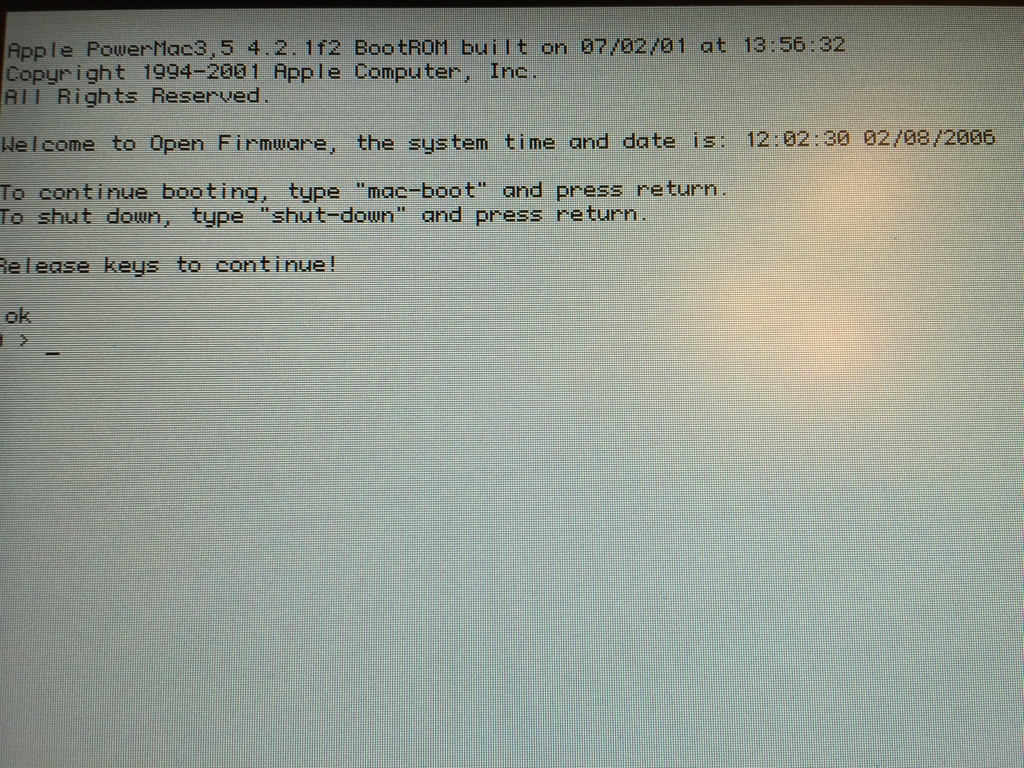

At least half a dozen combos of files and file formats and still nothing doing. I hold the programmers button and power, hear the beep and let go of the programmers button and press c. Mac reboots into open firmware and doesn't boot the disks.

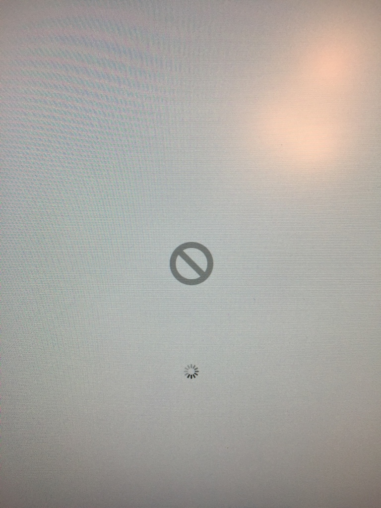

Used dropdmg to make ISO disks. First one for 7445/7447 cpu's. Try that boots to Apple logo after flashing everything and then I get the symbol saying nothing is there. Un flash put back original cpu, try whole process again with 7447/7448 version of software. This is what I get

Thanks, this is the firmware I was using and yes I installed it before putting in the cpu. It boots to an apple logo and after what seems like forever it puts the circle with the line through it. I even tried another hard drive and using my tiger disks to erase the hdd and it shows the same symbol.
