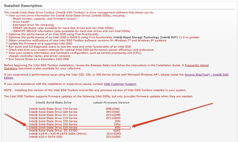

I have noticed a few reports on the web that the drive is not being seen on the SATA cable at boot time. I have not seen loads of these reports, just a few here and there. This would seem to make you think that the issue is not widespread otherwise we would have seen a firmware update from Intel. As of now the firmware version available from Intel still seems to be 400i, which is the one that came with the drive. A couple of PC builders (Lenovo and HP) are issuing their own firmware updates:
http://support.lenovo.com/en_US/downloads/detail.page?DocID=HT076644
http://h10025.www1.hp.com/ewfrf/wc/softwareDownloadIndex?cc=us&lc=en&softwareitem=ob-118158-1
I have exactly the same setup as you (see my sig.) and I have had zero issues with it, I know this does not help your situation. Probably your best bet is to return the drive. If you had good luck with the vertex 3 then maybe stick with that brand.
