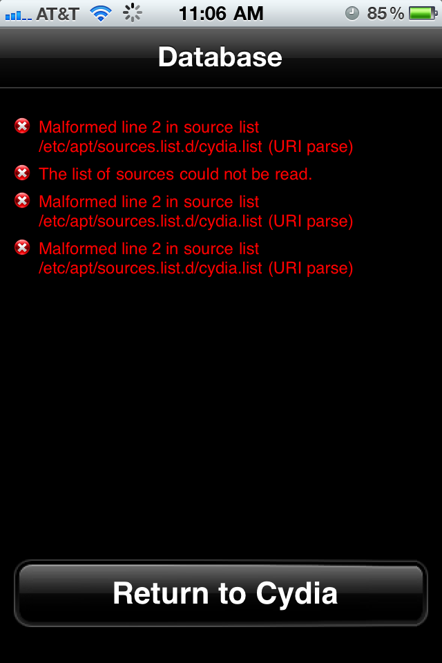

Okkkk.. So heres where I am..
I restore to fresh iOS 4.3.2. Synced.. Apps all working good. I then jailbroke with redsn0w and everything was working good. I ran Pkgbackup to restore my jailbreak apps and game/app saved data. It did restore the data but now when I open Cydia i am getting "Malformed line 2 in source list & the list of sources could not be read"
I attached a snapshot of it. I am just so tired of restoring and re-jailbreaking. Now that everything besides Cydia is working I really dont want to start over. I did NOT have open SSH on my iphone so Im not sure how I can fix Cydia. I do have iFile though..
Do this: Use PkgBackup now and restore ONLY your "user sources". This is the second line under Options on your main PkgBackup screen. Be sure to zero out everything else as you don't need to restore packages, Apple Default Apps, Preference Files, etc.
Important: You should get a message during this process that asks if you want to "merge" or "overwrite" your sources. Be sure to "overwrite".
Now I know this was my issue and worked for me, but I use Dropbox and was able to select the "good backup". If you still have the backup you used to restore your phone and haven't re-backed up, you should have the right one.
The good news about this is it can't hurt and you don't have to restore your phone to do it. Just re-install those sources and overwrite. Good luck!
do a search for ifile. i had the same issue and fixed it. you have to use ifile to delete some currupted files. easy to do and works prefectly.
So when i run pkgbackup even though i only choose sources, it restores everything. not sure how else to get it to run.. trying another restore.
