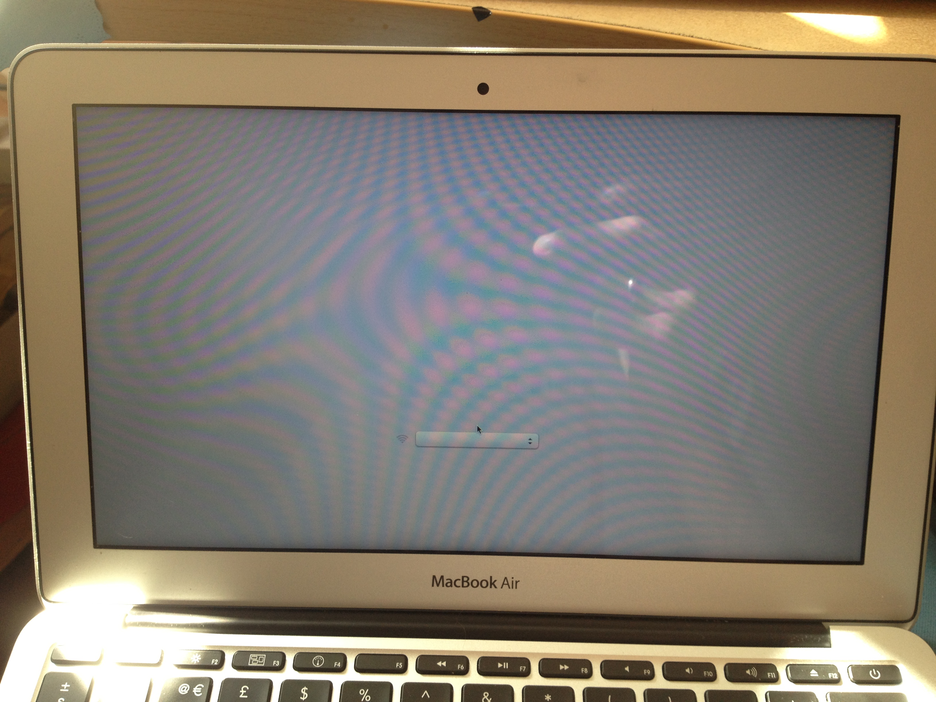

Hi, I've just purchased a 11" Macbook Air which came with no hard drive, I have fitted a 64gb SSD but am having issues.
On start up the screen just shows a folder with flashing question mark. I've done some research and this is common, I have tried all the button combinations on start up but they all just show the same, accept for power and option key which takes me to a blank page with a drop down box at the bottom to connect to WIFI. All great I thought accept my WIFI is not showing on the list! I have just done the same start up with a MBP and the same, my WIFI is not on the list.
Any ideas please? I presume if I can connect to the WIFI I can go through recovery and re-stall the OS?

Thanks for the replies, I have just connected to my neighbours WIFI, it connects, shows a signal and then that is it, no option to go any further. I have just read that the Air should have come with USB reinstall drive, which surprise surprise I don't have. It looks like I can't go any further without that unfortunately.

If I start up using (command, option and r) it just gives a flashing folder with a question mark. The only start up key combo that does anything other than this is option and power, which gives the wifi connection option but nothing above it like shown in the tutorials. I presume this is because I have fitted a new SSD.
The neighbours wifi is unprotected, it connected straight away with no issues or need for a password, but as there were no disk options above I couldn't go any further. I think if I connected the USB recovery drive sold with the MBA. I would have an option above the wifi connection box to proceed and re-install the OS.

Can you see the screen I posted in my first post? That is the only screen I am getting, I connected to WIFI but that was all I could do.

Your screenshot is the first step of Internet recovery, and that is what is confusing me. After you select a valid wifi connection you should get that spinning globe in my first screen shot, followed by the setup screen in my second shot.
