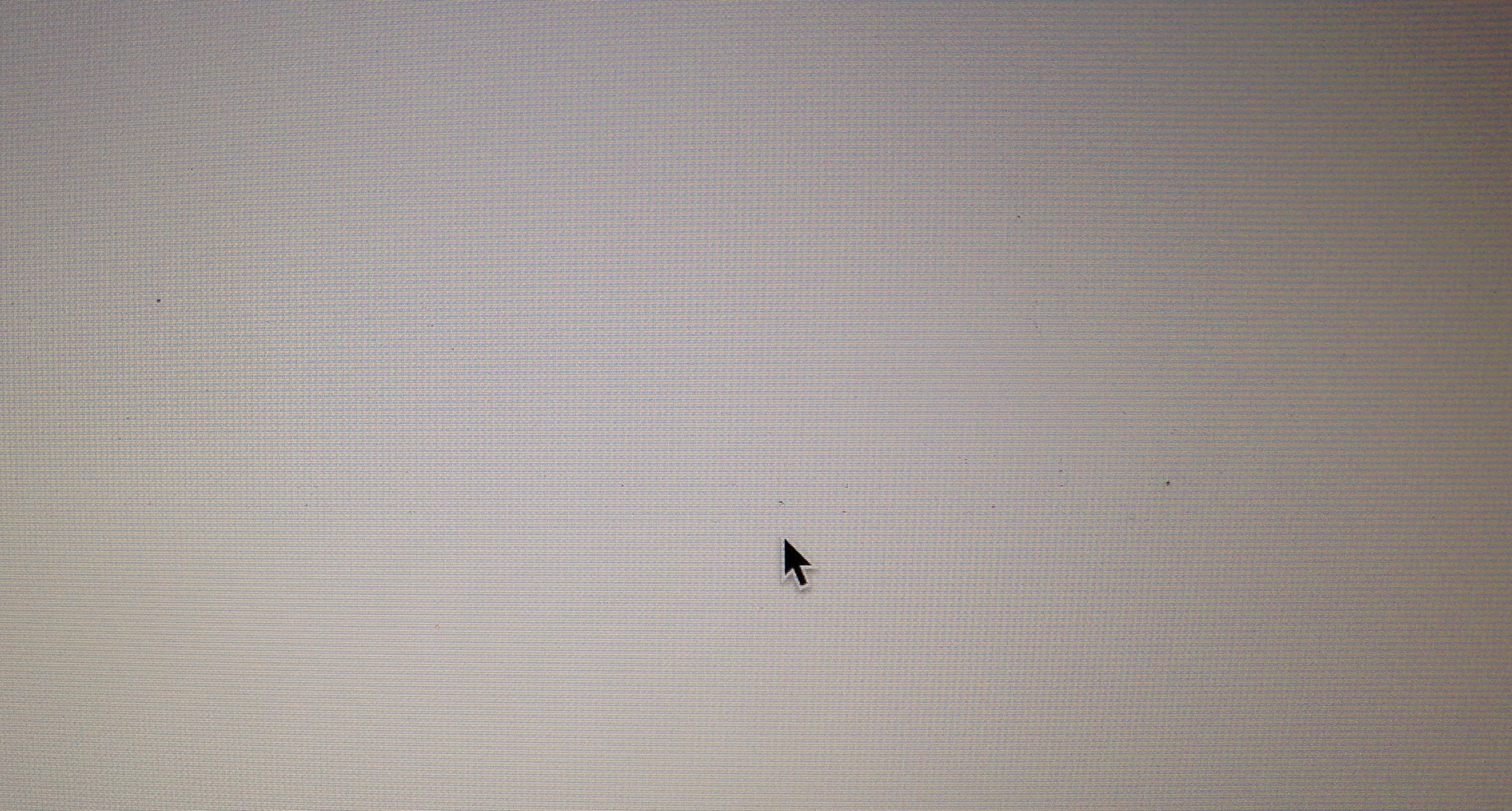

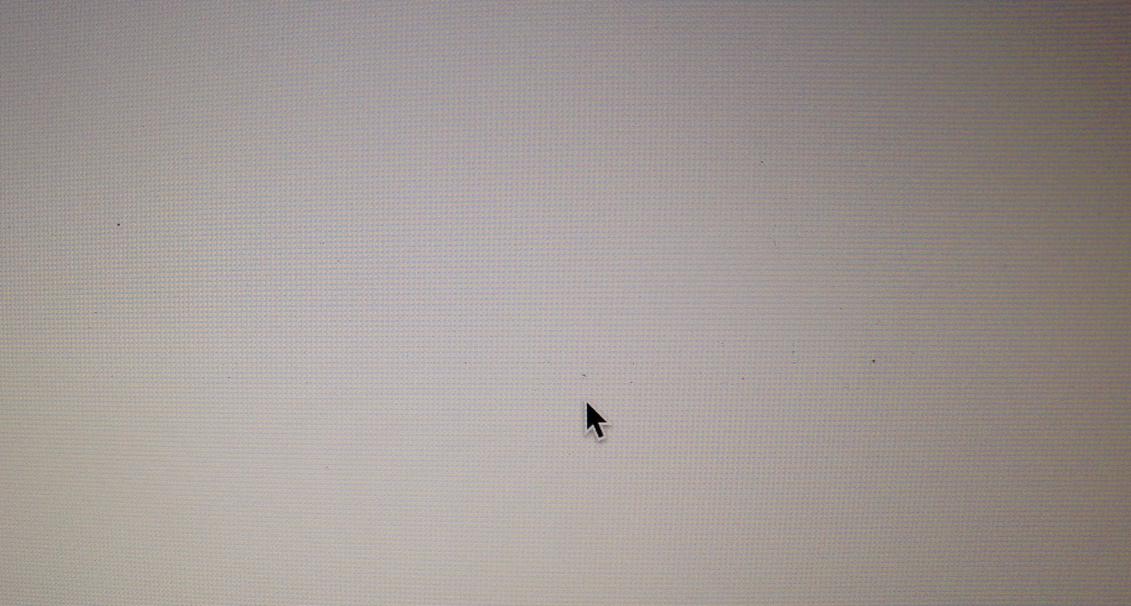

I've got some exploded pixels that showed up in the first 2 weeks of receiving my late 2013 rMBP. I've chosen to not send it in for repair and the problem at least has not grown. Pic attached of the pixels. You can feel them with your fingernail and viewed under a 10x handles it appears to be 4 pixels that popped out the glass. This is not damage I have inflicted.
