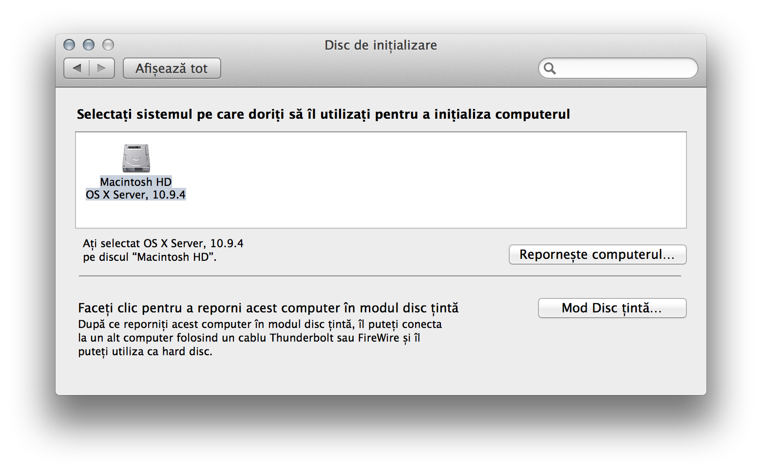

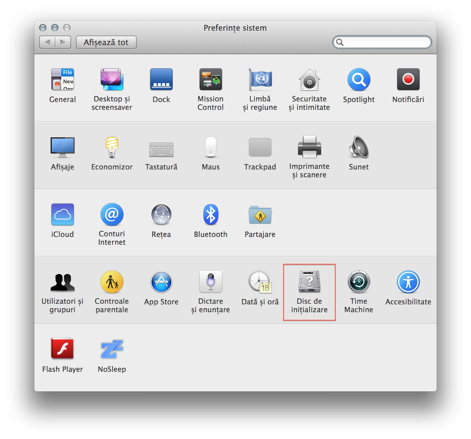

Go to System Preferences and select the SSD as your startup disk.
Thanks for the advice and yes I have tried to do that several times without removing the issue. The issue is only there when I chose "Restart", if I go from turned off to on - It starts absolutely perfect. "Hibernate" is also working perfectly.
I have also tried the resetting of the NVRAM without resolving the issue 🙁
Kind Regards
Karsten
