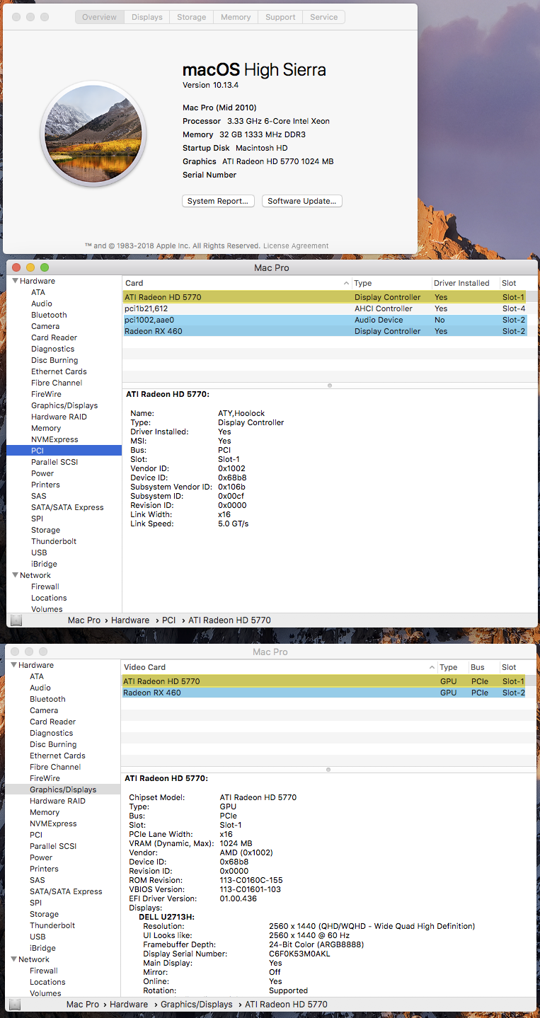

I tested again, with the ATI Radeon HD 5770 is in slot 1, PCIe SSD is in slot 2, and 460 in slot 3. I had a monitor connected to the Radeon via MDP. I saw the kernel panic on the screen at boot.

I swapped my cards around to match your suggestion -- HD5770 = 1, 460 = 2, SSD = 4.
I got the same kernel panic. I tried verbose mode, but the system crashed and rebooted too quickly to capture any info.

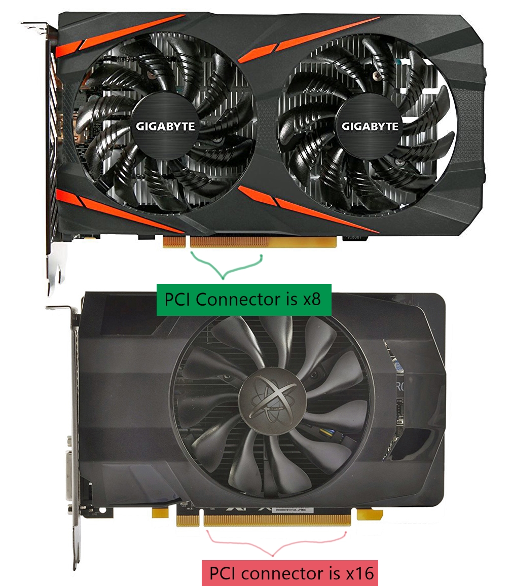

Anyway, not sure if this is why some RX 460 cards work in cMP 5,1 and some don't... but, I pulled a picture of what I think your card is based on the info you linked above and the Gigabyte model, which is the one I have and works.... And, the only difference I see are the physical PCI connectors on the cards. The Gigabyte model is hardwired as a x8 card and your card is hardwired with the full-length x16 connection.
