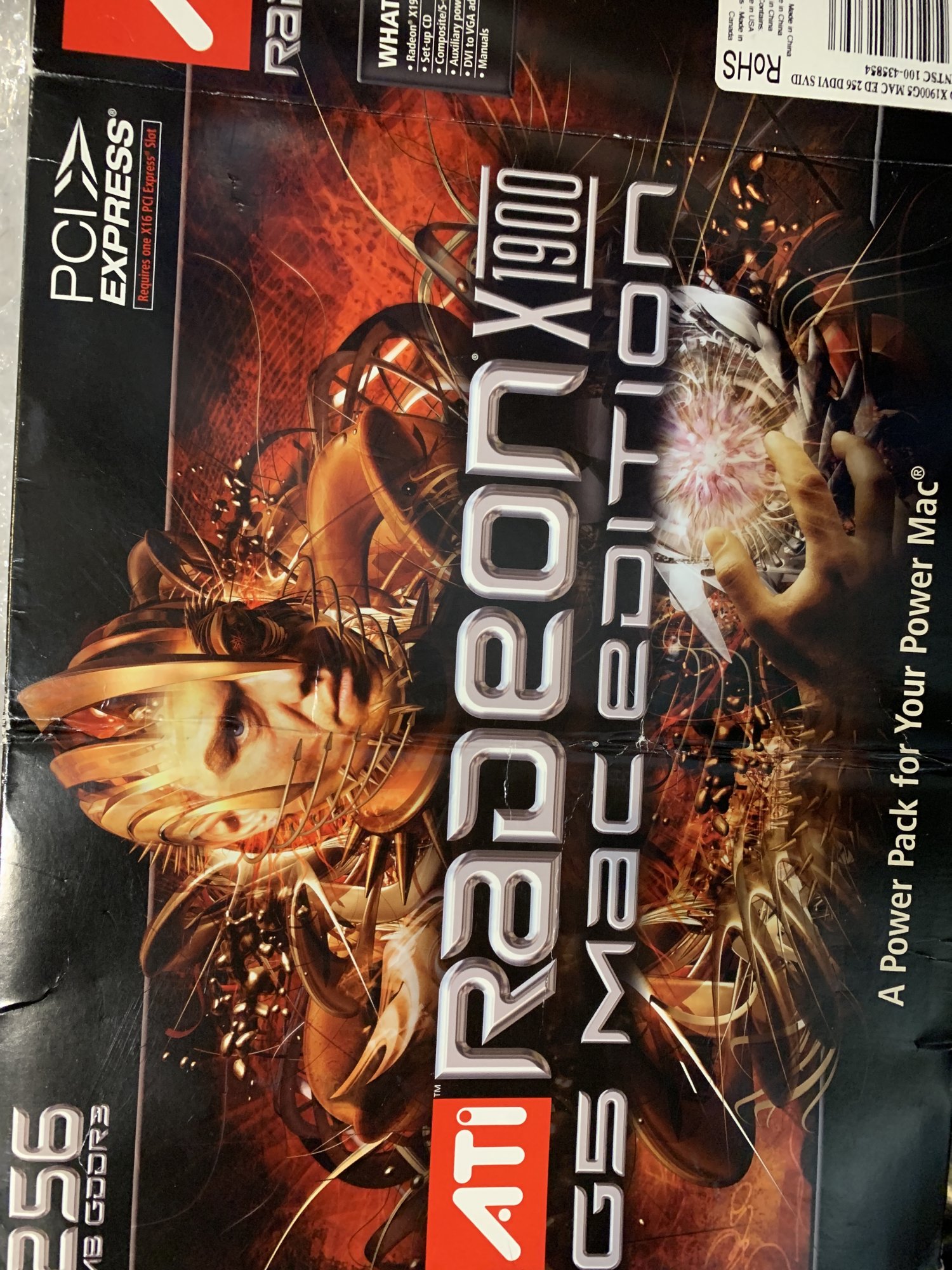

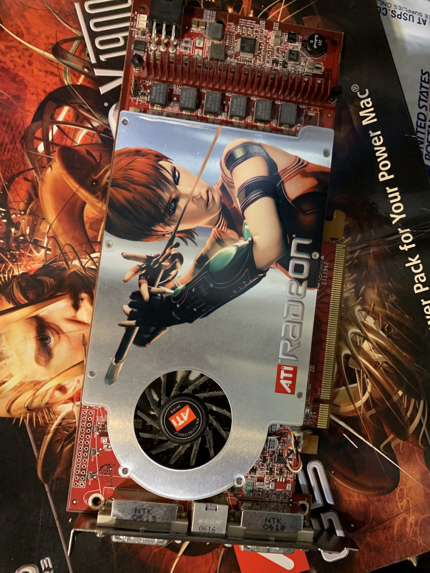

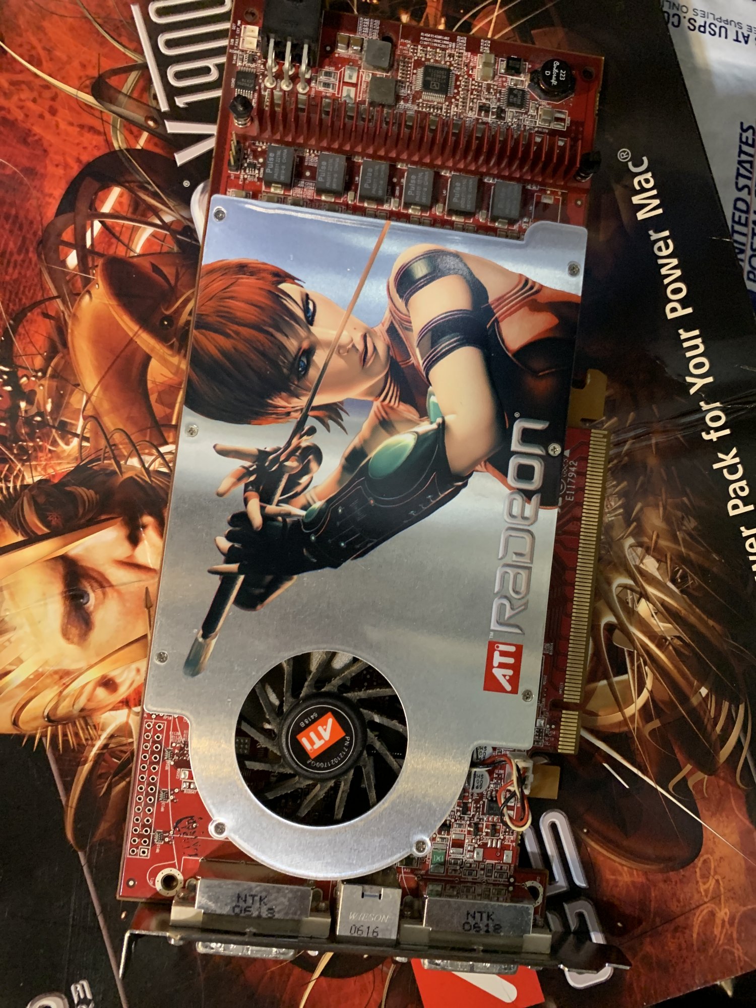

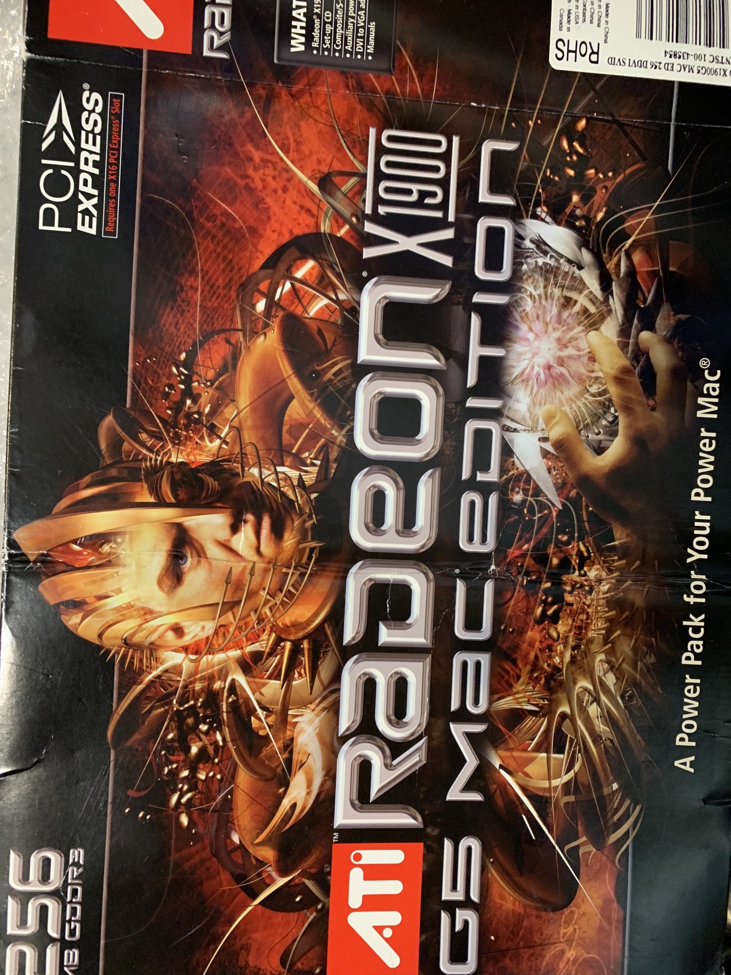

It’s the G5 one. Don’t get any startup screen only chime and then fans turn down when is loads

Remove the card, clean the contacts with rubbing alcohol and a microfiber cloth, use a can of air to blow into the PCIe slot, and reseat it.
What happens when you reset the PRAM (Cmd + Opt + P + R at chime)?
Do you get anything when you hold down Opt at the chime?
Curious if you're replacing your Quadro FX 4500 for performance reasons or just for fun of using the other card?
Ah right, I use an FX 4500 in my quad too. About the best you can get in those models, and the only one with 512MB VRAM. Also just looks a lot cooler imo.
