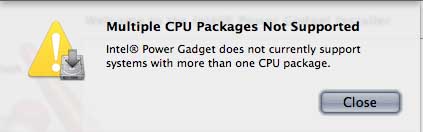

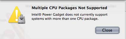

I just tried out v4.2 on my nMP and there's no CPU temperature there... I got 99 temps but my CPU ain't one. Not sure why they can't pull the value if the Intel Power Gadget can. I also only see a single GPU represented in the CPU pane. 🙁

Well they didn't go a very good job guessing. 🙁 As it is, none of the sensors iStat reports are of much use. Fortunately, there's the Intel Power Gadget if you want to know what your CPU temp is.

Yeah, I looked at that too but my CPU proximity shows 40-deg, while Intel Power Gadget says 47-deg... and when it's under load, CPU proximity barely moves, compared to the real CPU temp. So unfortunately, it's useless.
Oh, and when I said it only sees a single GPU, I was referring to the frame count and VRAM buffer under the CPU menu.
