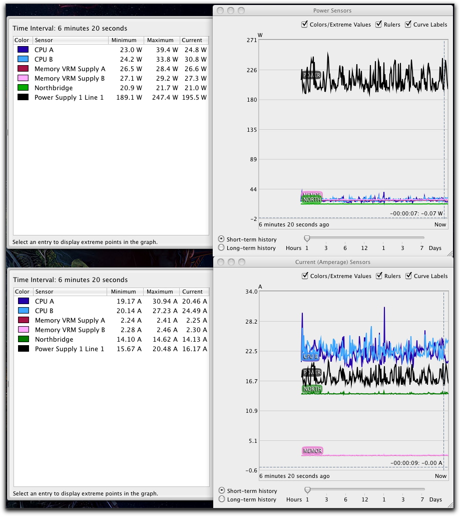

I dunno. Hardware Monitor says I do. <Shrug>
