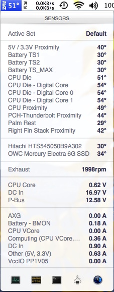

Just installed iStat4 myself. You might need to poke around a little and enable some sensors.
They did change the names, but I have all the same sensors.
CPU Core 1 became CPU Die - Digital Core 1
I have a CPU (aggregate), Digital Core 0 and Digital Core 1. I'm running on my 13" MBP i7 (dual-core). I already like the pop-up graphs (1 hour, 24 hour, 7 days) for each sensor. That's going to save me a lot of trips into Server Manager on the Mini at home.

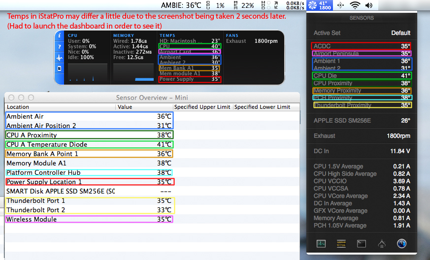

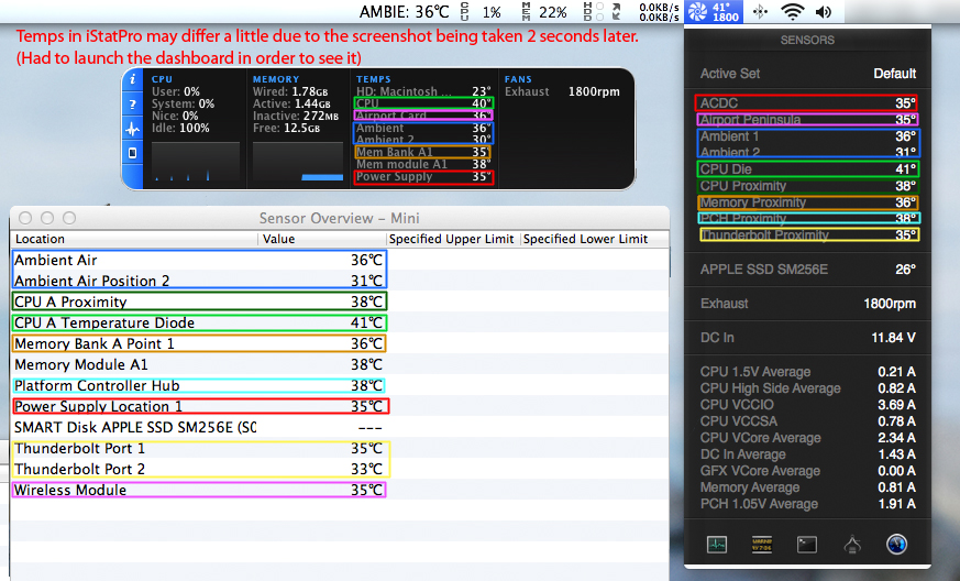

Well. In the case of the 2012 Mini two of them (at least) went away. In iStat 3 there were 4 CPU sensors, as this screenshot from Philip shows:
attachment.php
Now, all CPU sensors available through preferences are:
CPU Die
CPU Proximity
So 2 of them went away. I guess CPU Die is what used to be called CPU A. CPU Proximity stayed the same.
Also, and now that I look at it, a lot of sensors seem to have changed. Dunno what to trust now. 😕
These are all temp sensors that are available.

OK. Downloaded iStat Pro and TempMonitor too. Compared temps with iStat Menu. All of them look pretty legit, so all I can say is that I guess v3 was getting wrong readings from even un-existing sensors. 😕
Anyways, glad this is finally working as expected.
Will have to run some tests again though. 🙄

This is what I get on my 2011 MBP.
DAMN IT. That is what it should look like I guess… See the core0 and 1 temps? They slightly higher than the "CPU Die". I'd like to know what's the most accurate reading for the CPU.

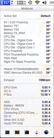

Here's what I get on my 2012 MBP. No temperature gauges for individual cores over here.
WOW. You don't even have one single CPU reading! (Maybe that heatsink B one?)
