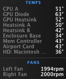

I've got a 2.5 GHz also, and here are my numbers (iStat Pro screenshot attached). Nothing too intensive running right now (Firefox, iTunes, Acrobat Reader), has been on for an hour or so.
Should we expect 2.5 GHz to run almost 10 degC hotter than the 2.4? Because that's what it looks like right now. Unless both amitdoc and I have abnormally warm computers...

No, it looks like you need to put in new thermal paste. Those were the temps I had doing basic stuff; downloading, office 08, acrobat, photoshop, minefield.
Now after a thermal paste replacement and burn-in:

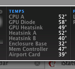

I've definitely noticed that the temperature on my penryn MBP is warmer than on my old merom MBP. Right now I'm running ichat, firefox, and itunes, the computer has been on for about 4 hours.
It's not uncomfortably warm to the touch, but it definitely feels warmer than my old Merom MBP. Wish I could cool it down a bit, but i'm not about to open this thing up to put in paste!
