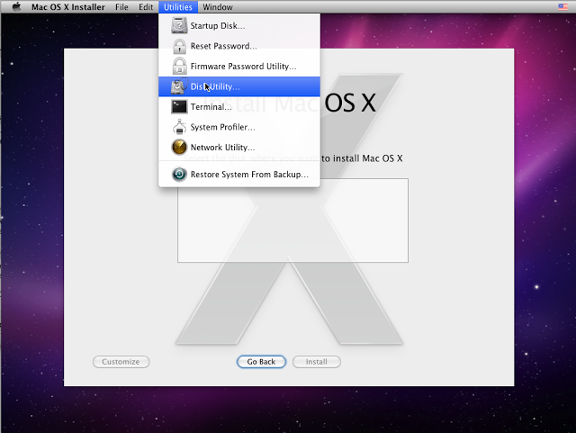

Yes, there is. You have a couple of options...
1) This involves booting to your Snow Leopard disc again. Once you're booted to the Snow Leopard disc you should have a "Utilities" menu in the menubar, under which you will find "Restore System From Backup". This option allows you to restore your entire system from your Time Machine backup, rather than individual files/folders like you currently can. See the below picture for reference, it's the bottom option in the menu.

Thank you thank you!!
Especially thanks for the picture - it really helped!
I have managed it, put the SL disk in, shut down, restarted, the Installer page came up, and instead of installing (which I'd tried/done before) I looked at the top menu, found the restore option and we were away! :)
