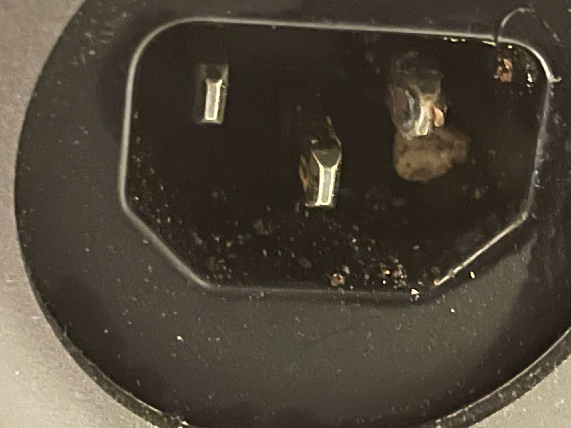

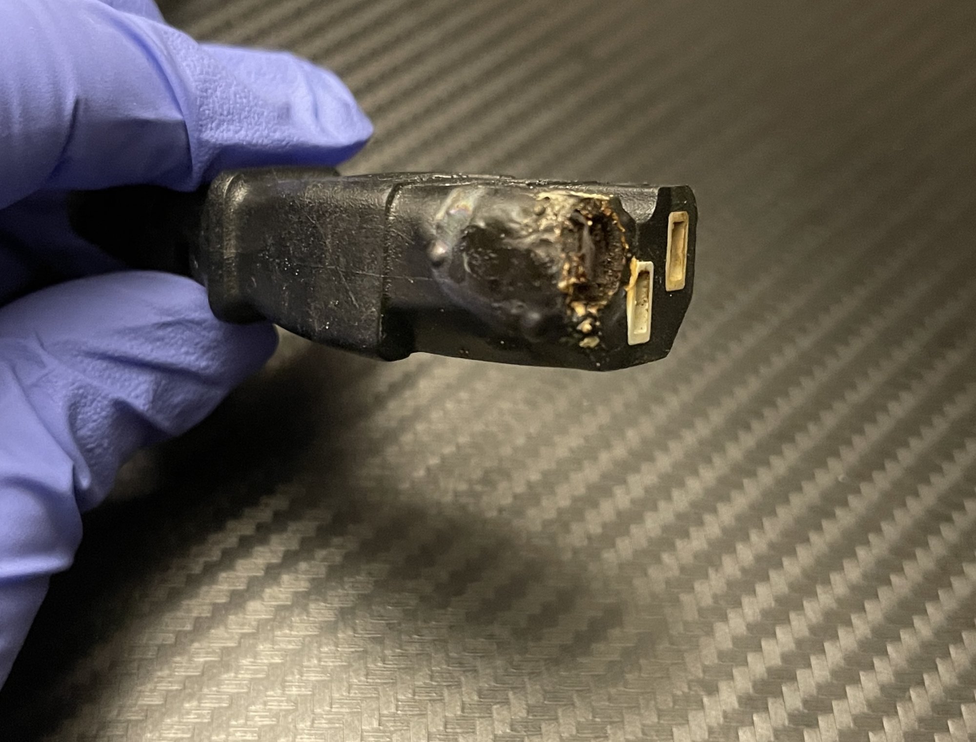

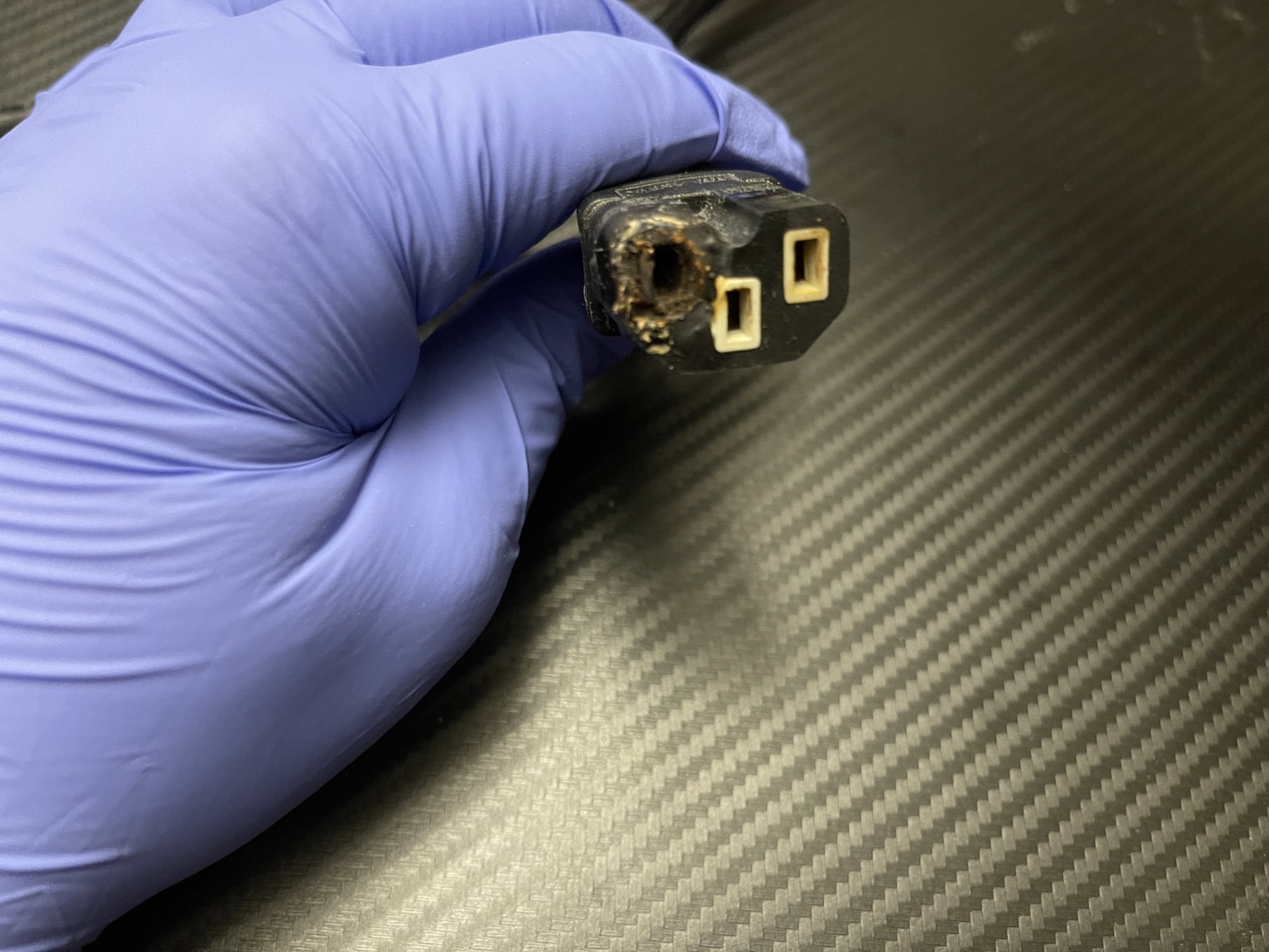

Wellp...found out what was causing that burning smell on my 60-day old refurbished iMac Pro...
I assumed you were using an Apple cord not some aftermarket POS. A lot of those aren't rated for the amps heavier duty computers draw, like that one. Hopefully, the heat didn't permanently damage the plug on the iMac.
I'd just set up a return right away. Rather than risk it. If that computer qualifies for the holiday return window. You should have until January 31st to return it.
"Hopefully, the heat didn't permanently damage the plug on the iMac."
Looking at the pic in reply 5 above, that socket IS "damaged".
I would not attempt to use it with ANY cord, until repaired.

I'm thinking the power socket might be integral to the internal power supply.
Don't know. A power supply "swap" might do it.

I agree with you. I don't see why I have to pay to have it repaired when I am within the company's 90 day warranty. Thankfully they will replace it. But the socket itself is on the back of the iMac, and if you look closely that white stuff is stuck. Permanently. There is no way I would even be able to use a power cord with it.

I used the cable that came in the box from the refurb company. You would think they would be using the equivalent Apple cable with their iMacs...

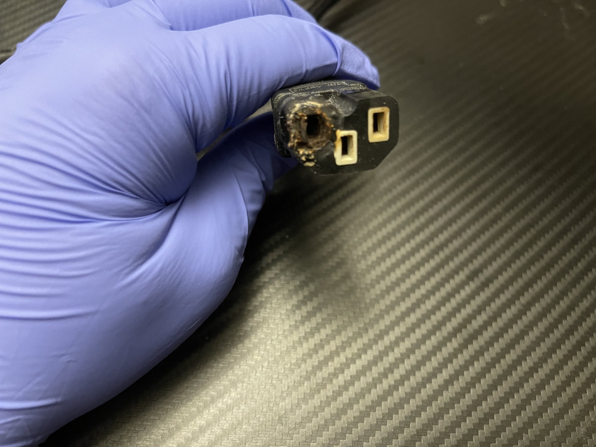

Honestly, from the photo, that looks like the original cable, it has the shroud, which most of those IEC cables don’t have. EDIT: OOPs! Nope, that‘s a generic IEC cable: no shroud. I mistook the last pictrue because I scrolled too fast. That’s a generic cable. Shouldn’t have caused a problem, but if made cheaply enough, maybe it couldn’t handle the iMac power draw. Maybe it’s a knockoff, but seems like a pretty silly part to clone. What, though, could have caused that kind of damage? Some kind of short in the power supply? Anyway, yes, send that sucker back. As for the data, that is a conundrum. Maybe ask Amazon?
Are there any markings on the cable itself indicating its capacity?
The numbers say, on the damaged end: 227 IEC 53.

I wouldn't be shocked if that cable was all rubber and puny 20 AWG aluminum wires. Instead of 14 AWG copper wires. I've read an article before on how bad the cheap ones are. With images of bisected cables.
You want to get a cable from a reputable manufacturer. Rated for 15 Amps and stating it is 14 AWG. Assuming 110V US power.

Yeah the OP probably has one in a box somewhere that would work just fine. I know I do, hell I even have real apples ones in boxes. They’re not hard to find. The idea that a “refurb” company would save 10 cents by giving out a truly subpar cable seems ludicrous, but it is exactly what happens, and yes probably exactly what happened here. My wild guess here is that maybe the pins inside the cable end were making intermittent connections, and finally sparked and blew out. Cheap cable, cheap aluminum wiring, cheap pins on the end.
The problem is, with the damage and the fact that part of the power cord is now fused to the power input on the back of the iMac (notice the white part of the power cable in the photo I posted above - the painted white borders around the plug inputs - is now fused to the power input on the iMac), there is no way to plug something in to even bother wiping my data.

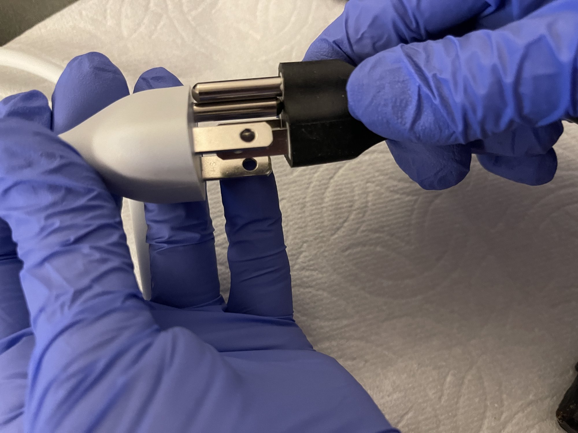

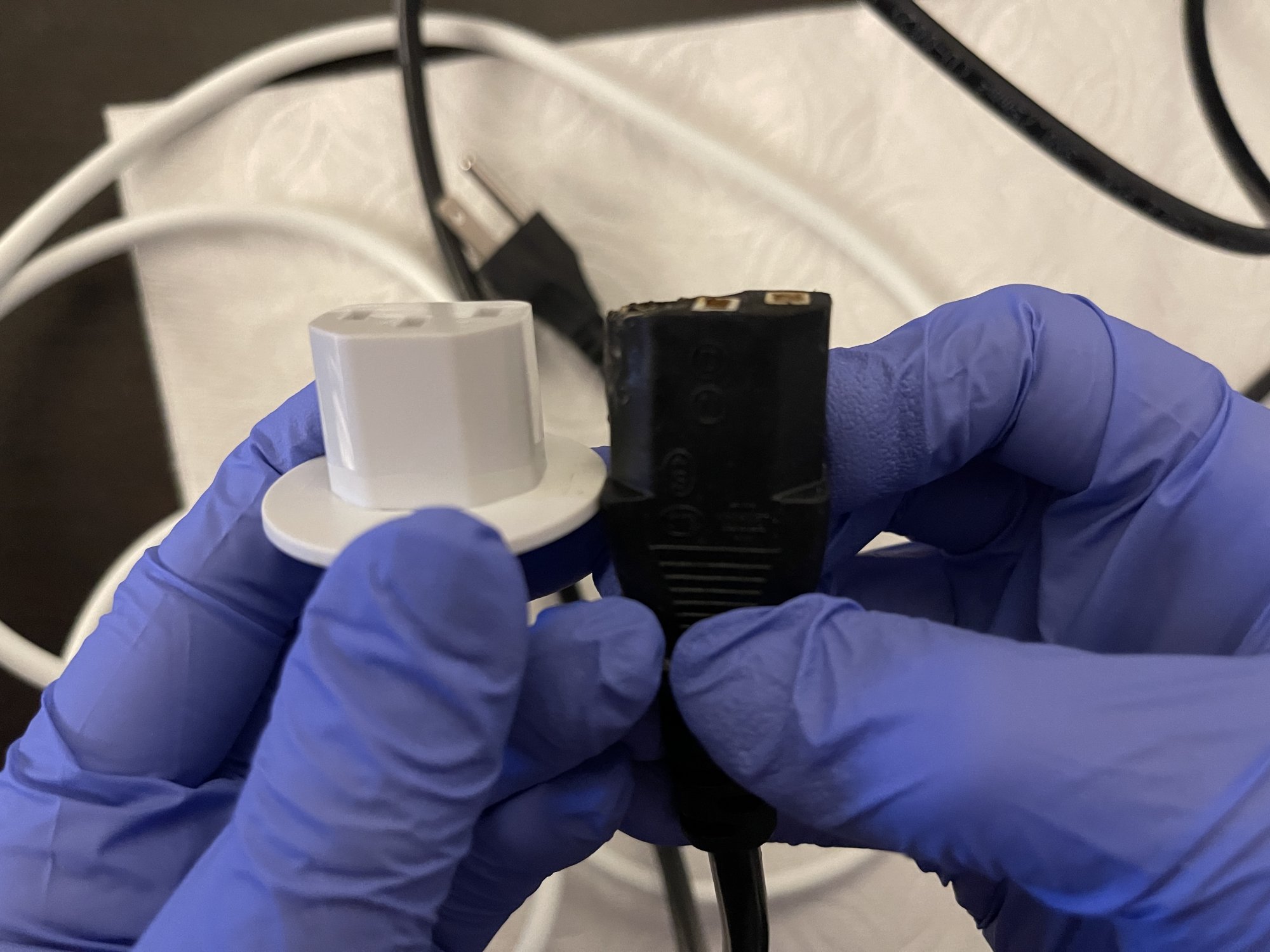

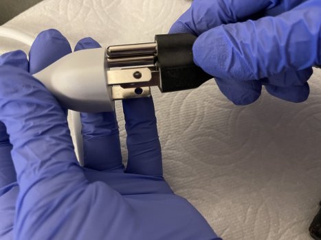

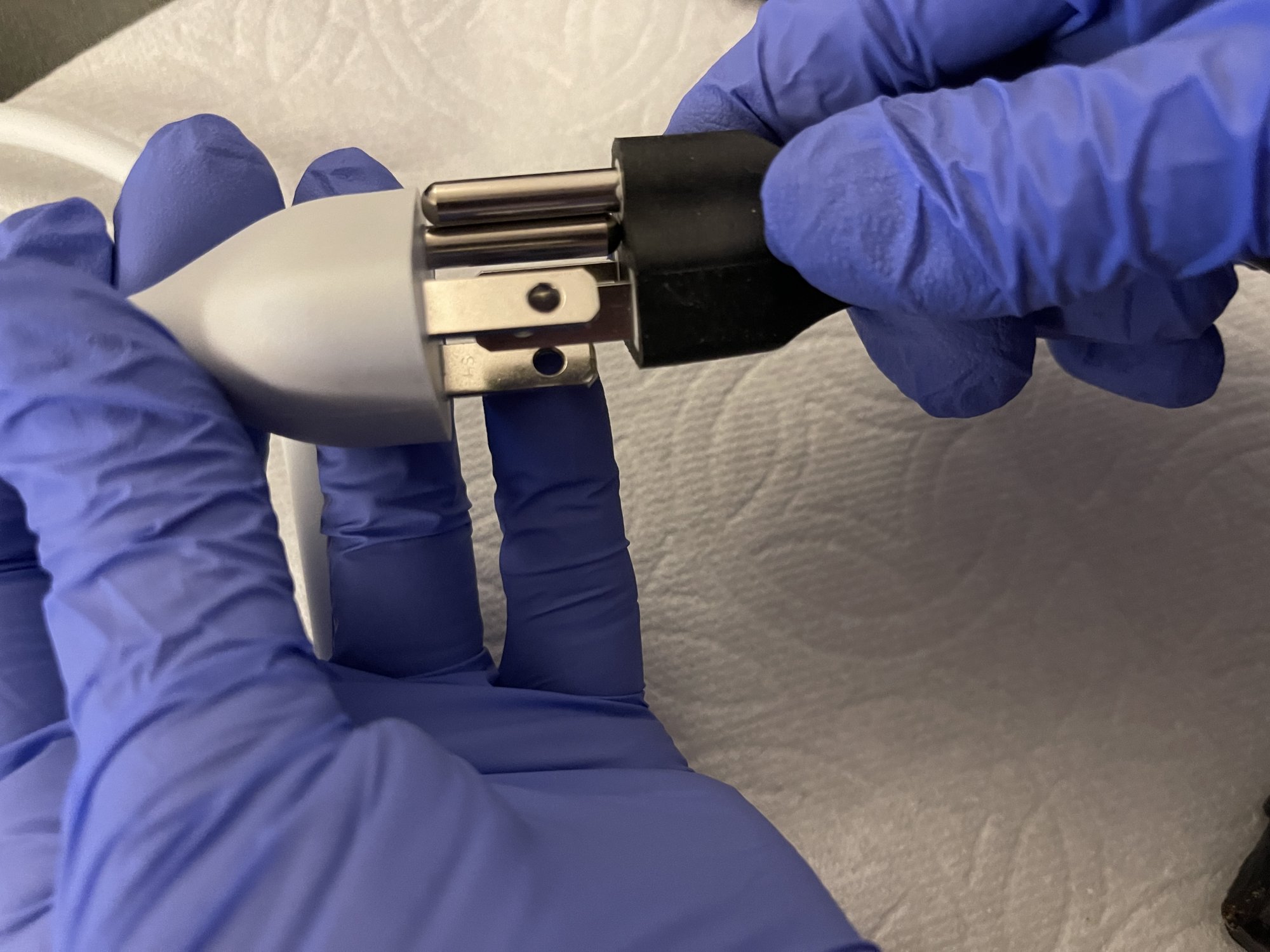

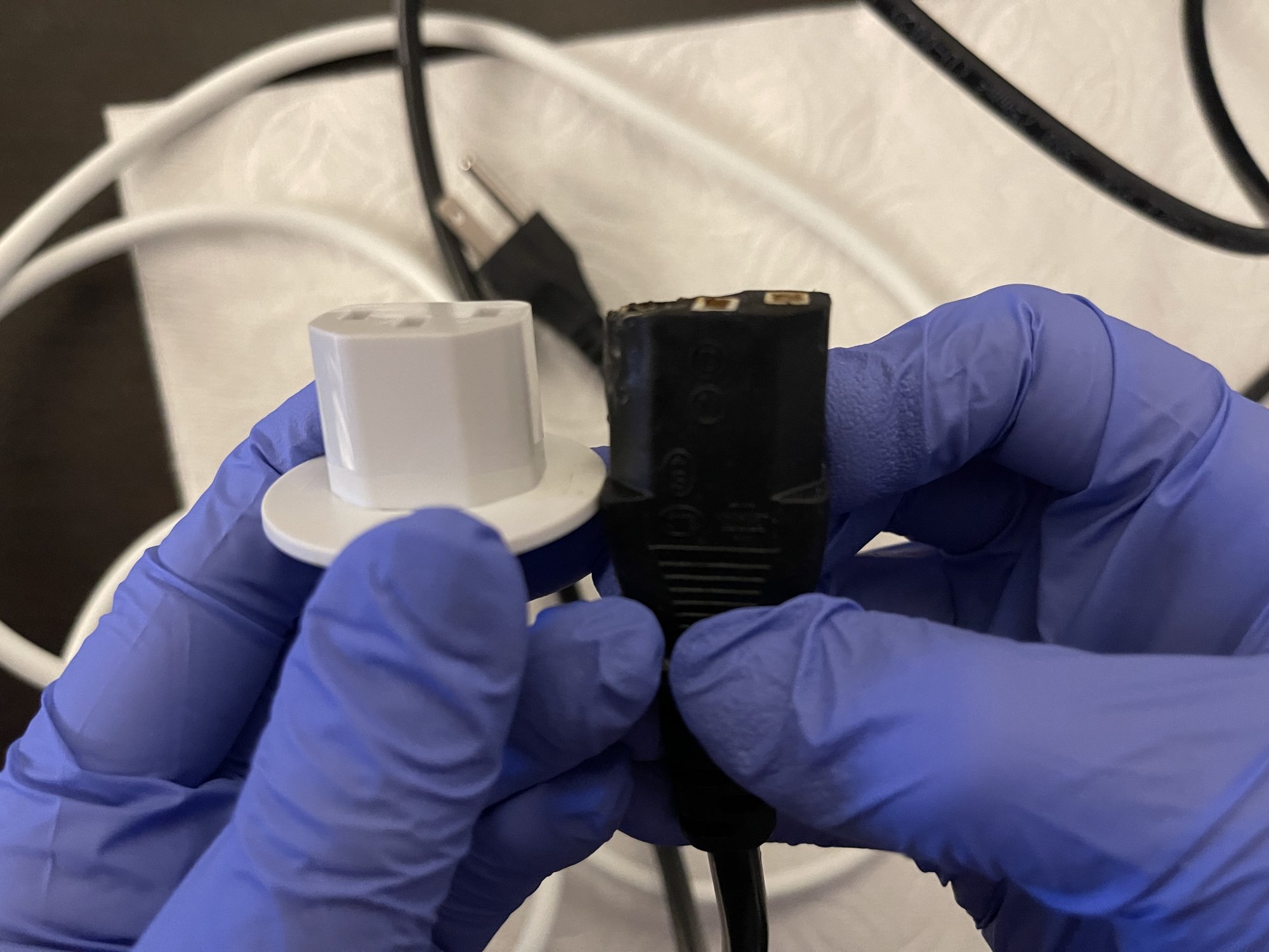

Well, very interesting. Check it out, the difference between the Odysson third-party QUALITY power cable (white) vs the one I received in the box from the refurbishing company (black). Unbelievable.
