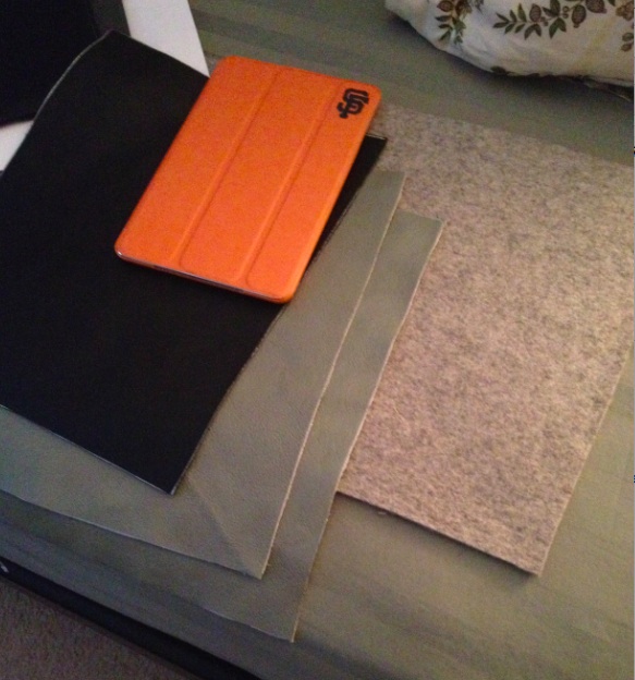

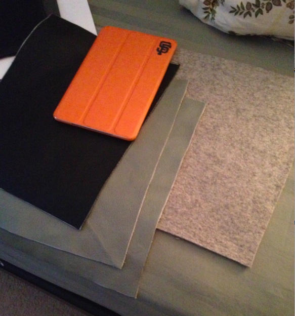

couldn't find an ipad mini sleeve that i like so i decided to embark on a new journey of making my own sleeve. i bought 100% wool felt (1/8' thick) some leather (below pic) and i will see how it goes. i will update you guys on my progress. hopefully it's not as challenging as i thought it is.

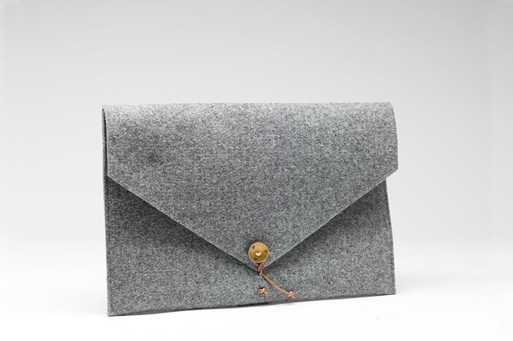

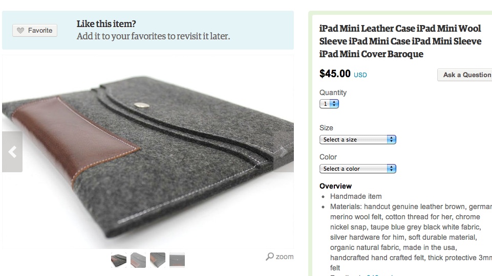

i am thinking of doing something similar to this sleeve. i may mix and match whatever style i could find out there.

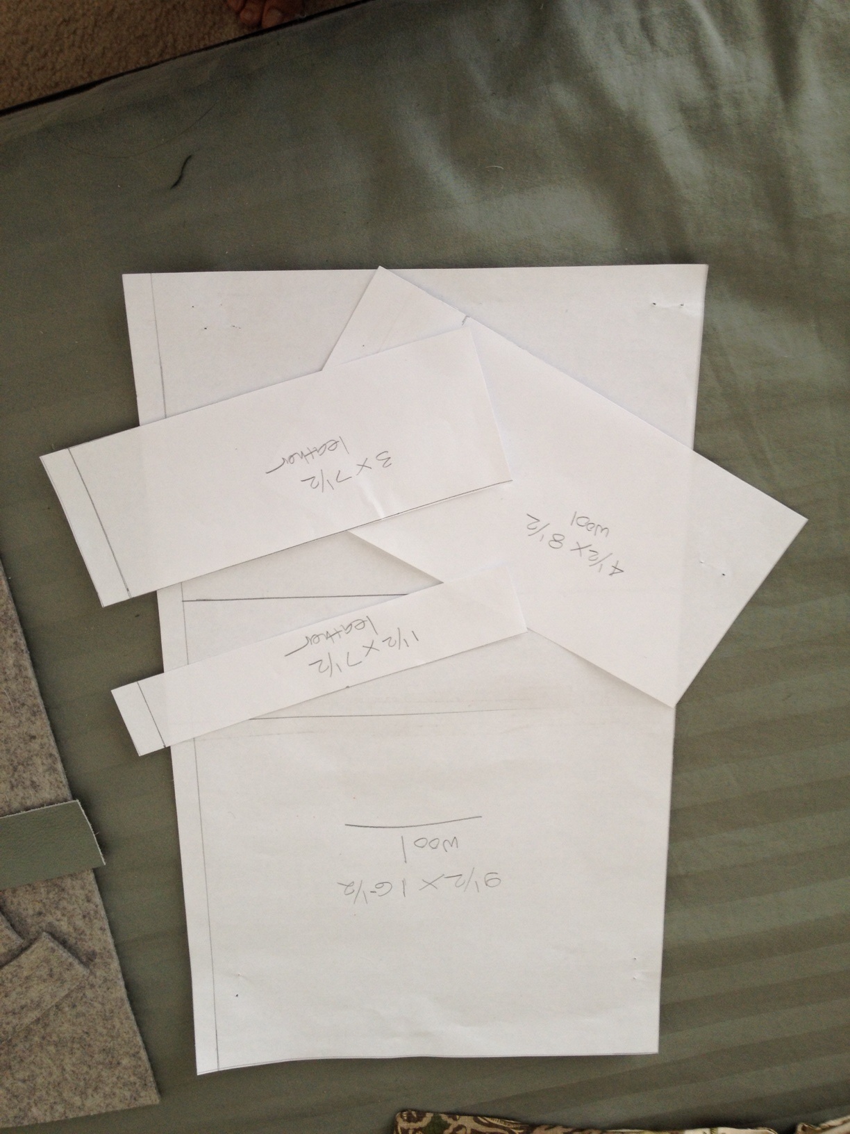

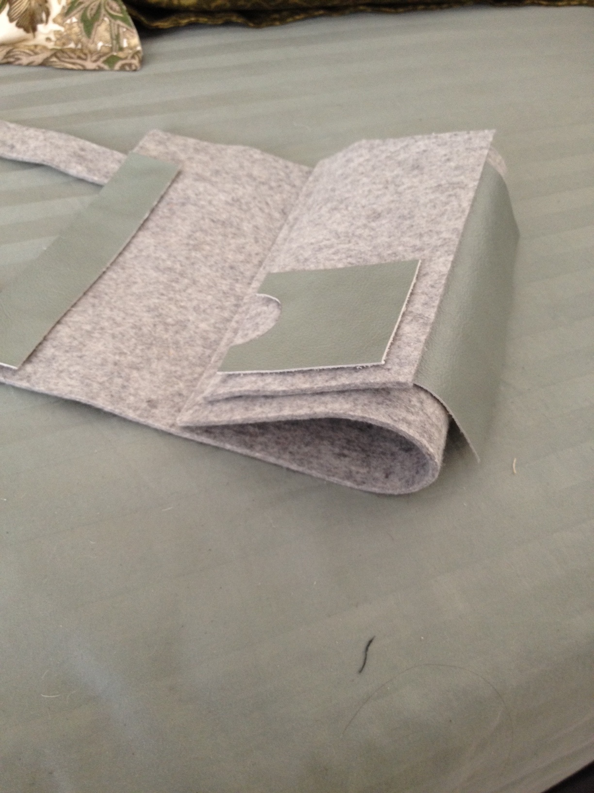

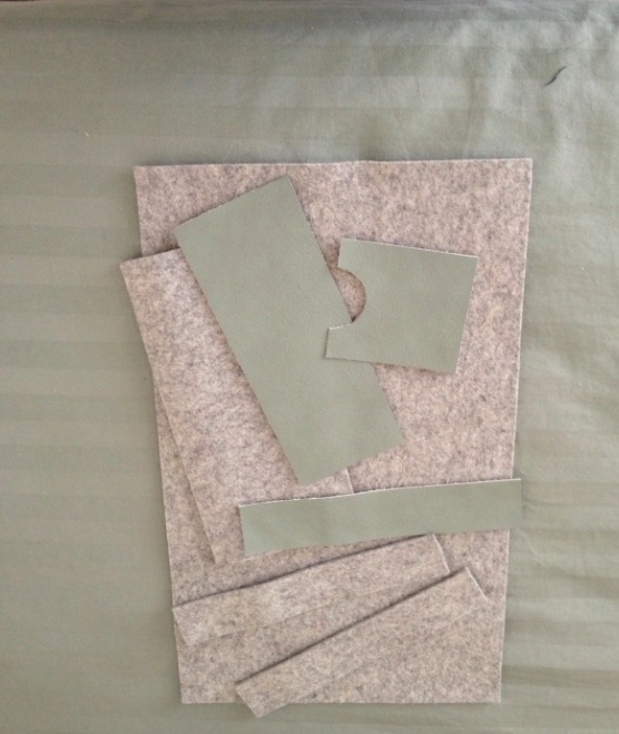

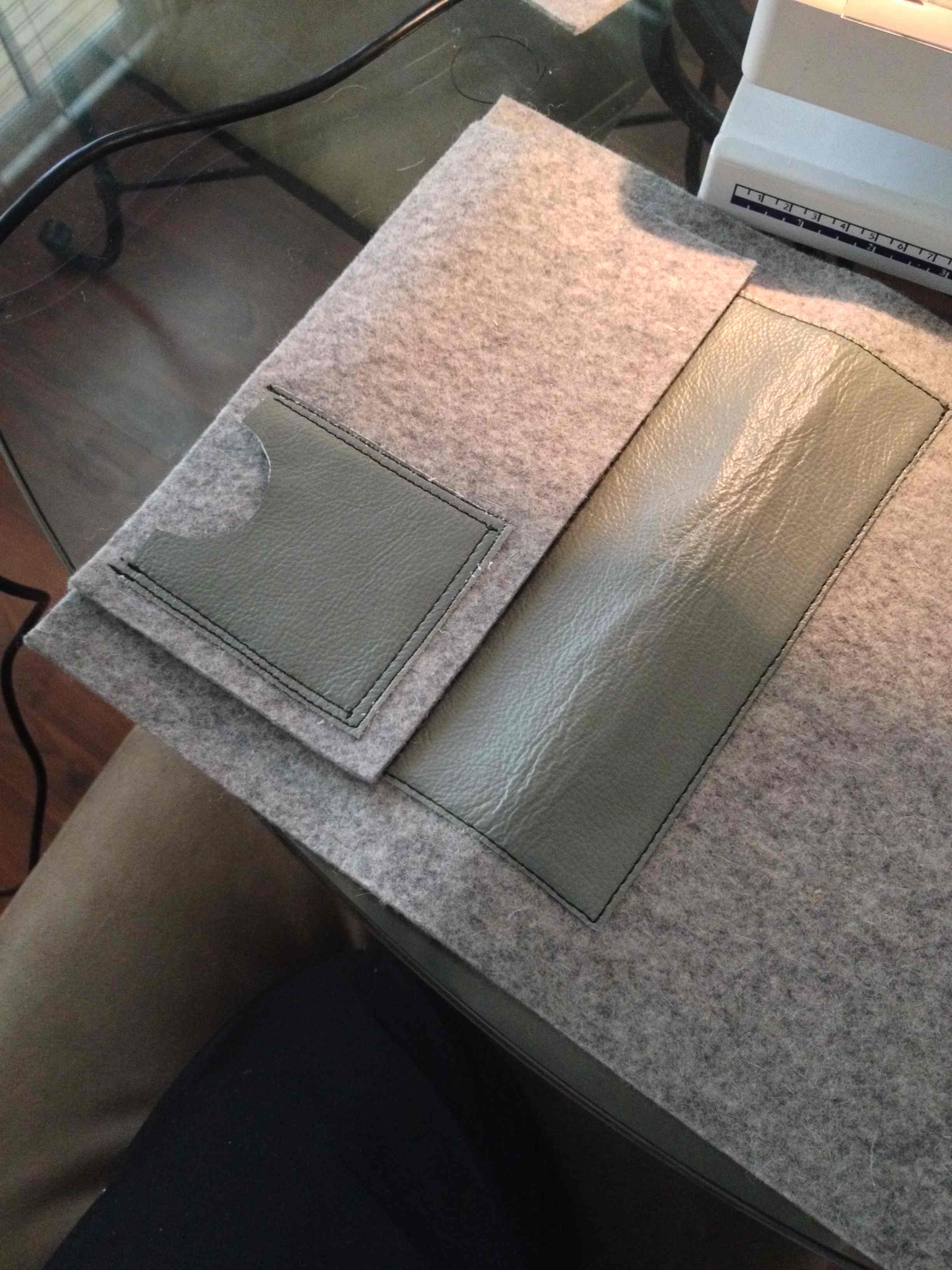

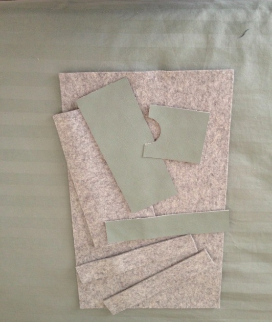

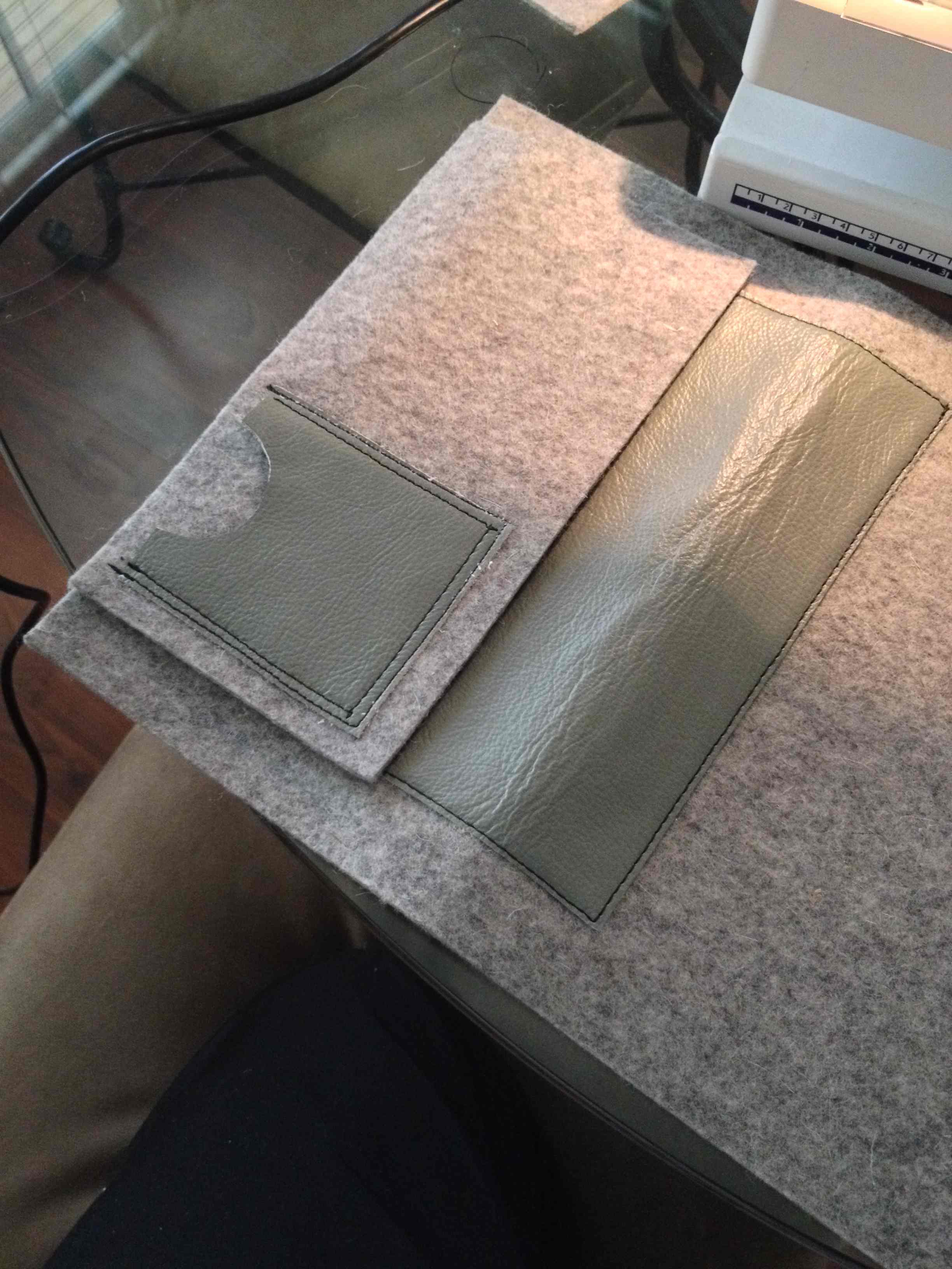

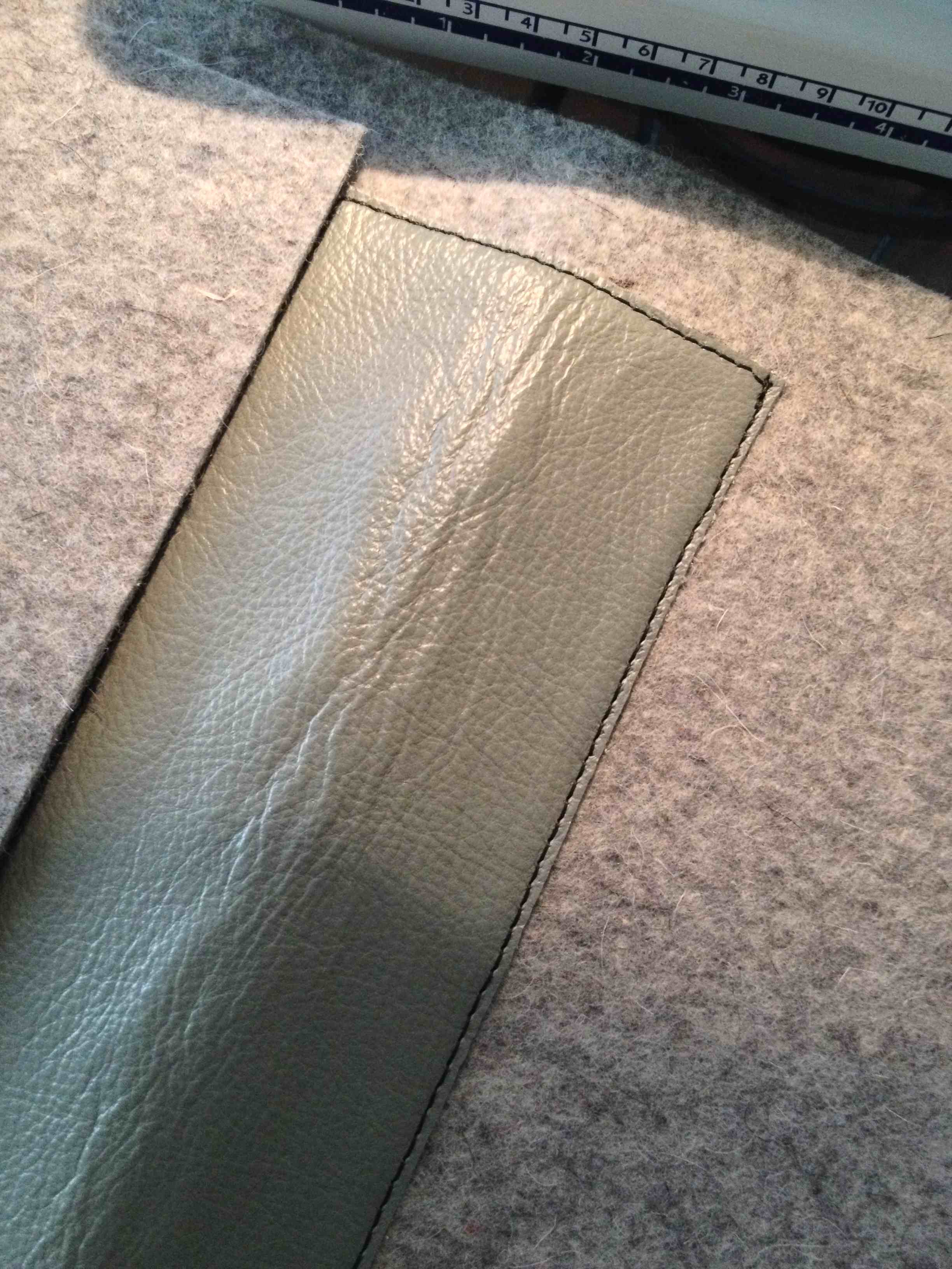

UPDATES on my Ipad Mini Sleeves:

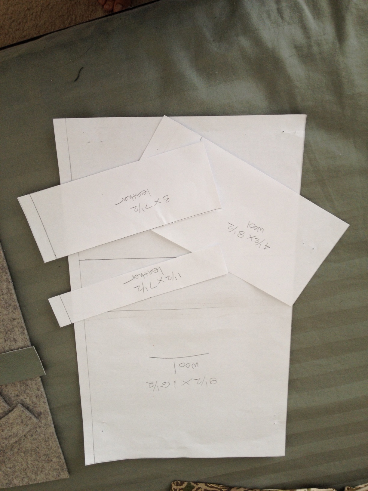

Step 1: make a pattern. i just used standard copy paper and taped them to make one big paper.
Step 2: use a very sharp exacto knife to cut the patterns. using sharp knife will give you a clean cut. especially when cutting leather. i wanted to use black leather for contrast but decided to use my light green leather instead to make mine one of a kind.
Materials:
1) 100% Wool Felt (1/8" Thick Medium F-7 100% Wool)
2) Light Green Genuine Cowhide leather (lightweight)
TIME TO SEW..... thanks.

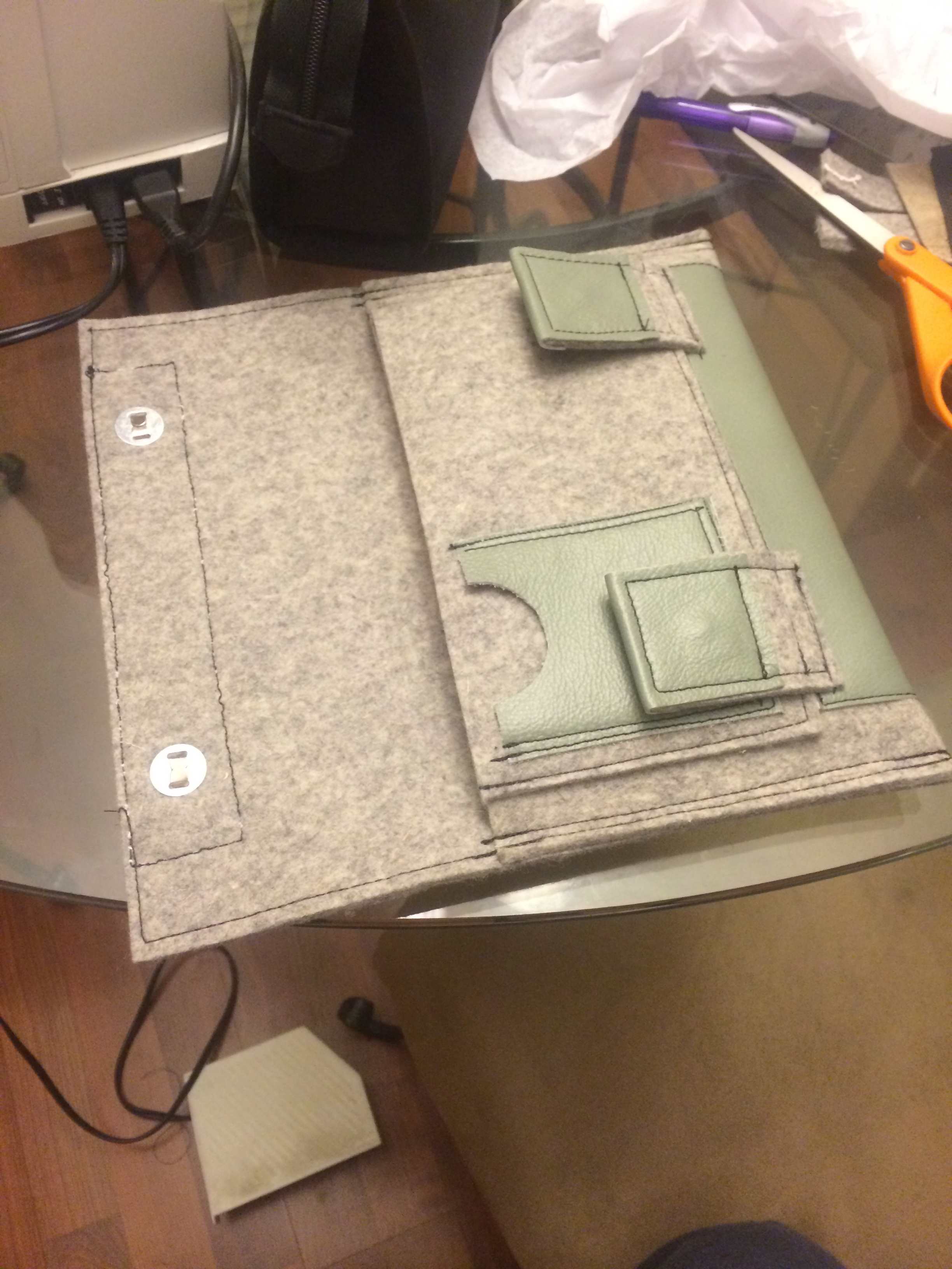

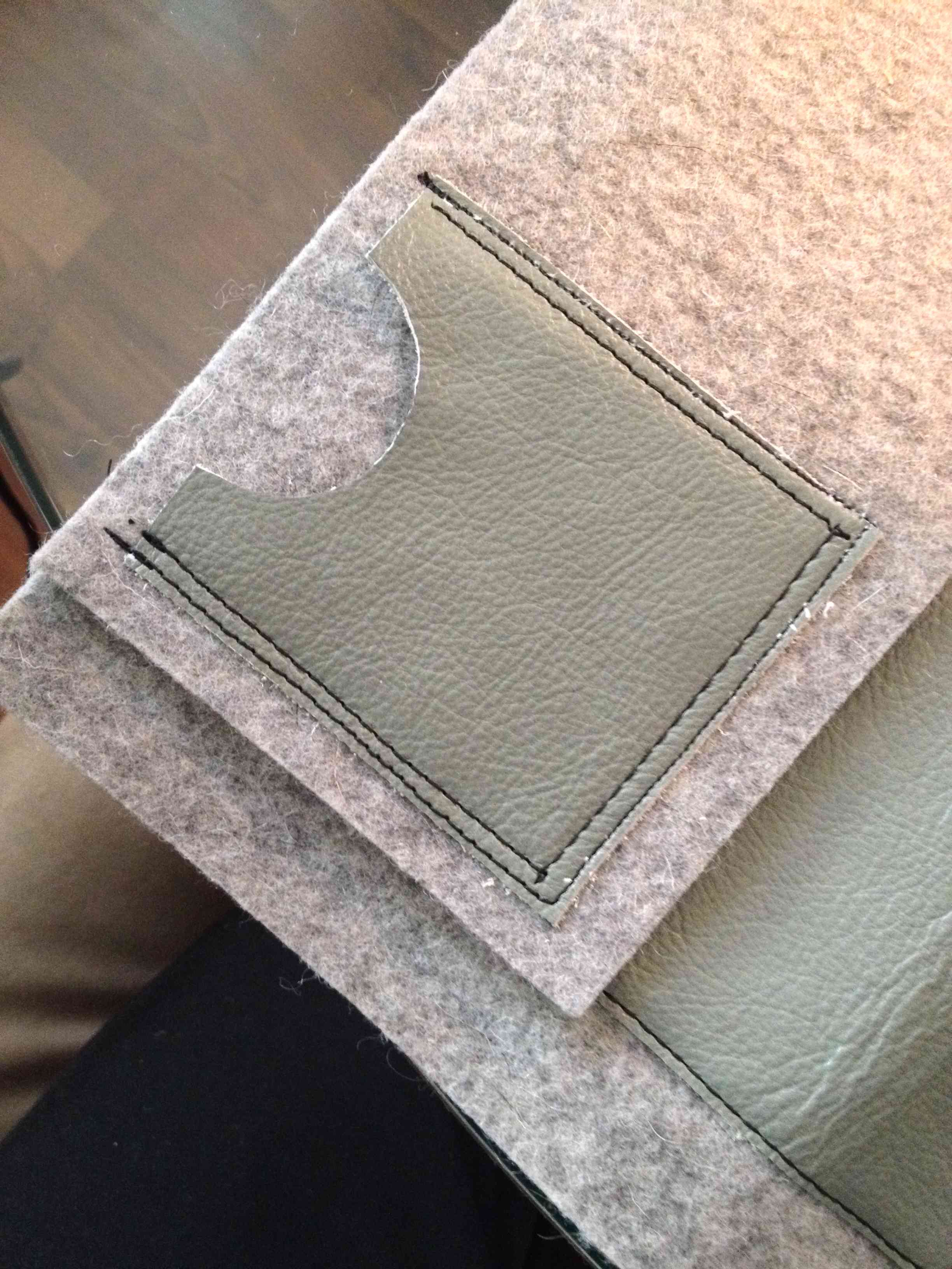

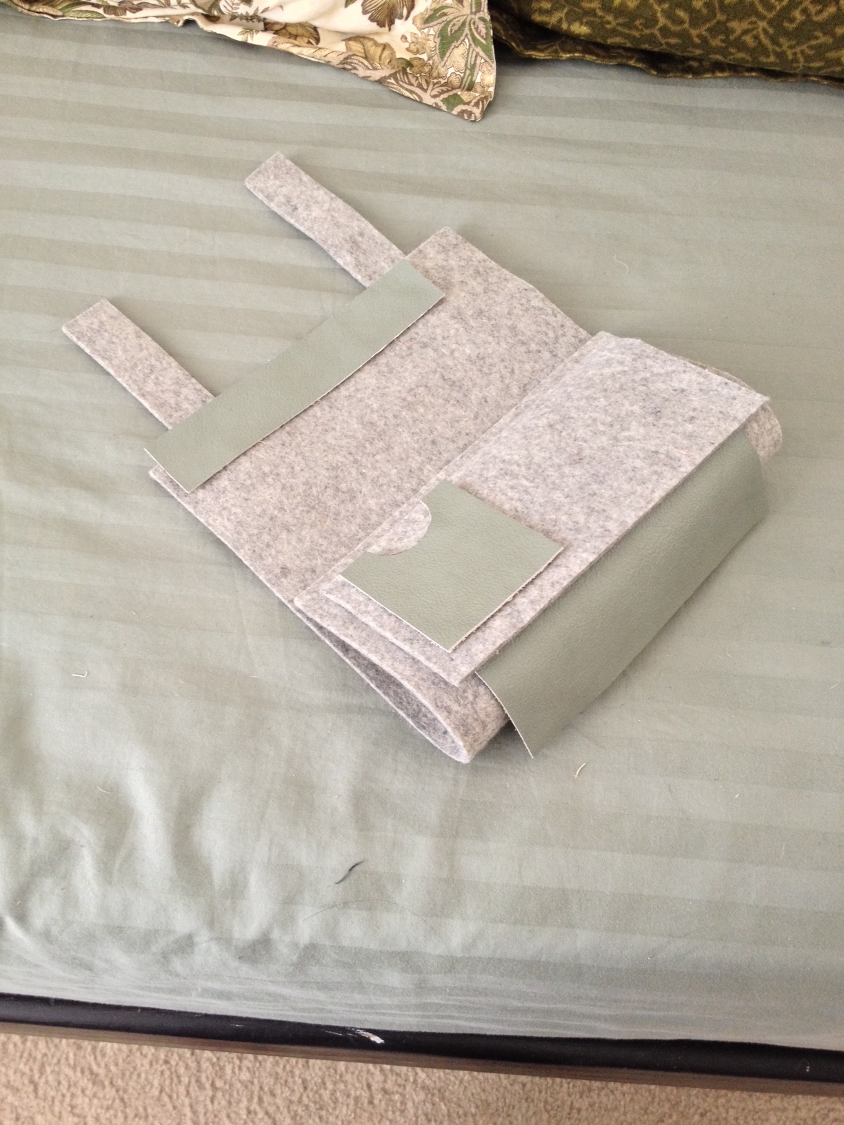

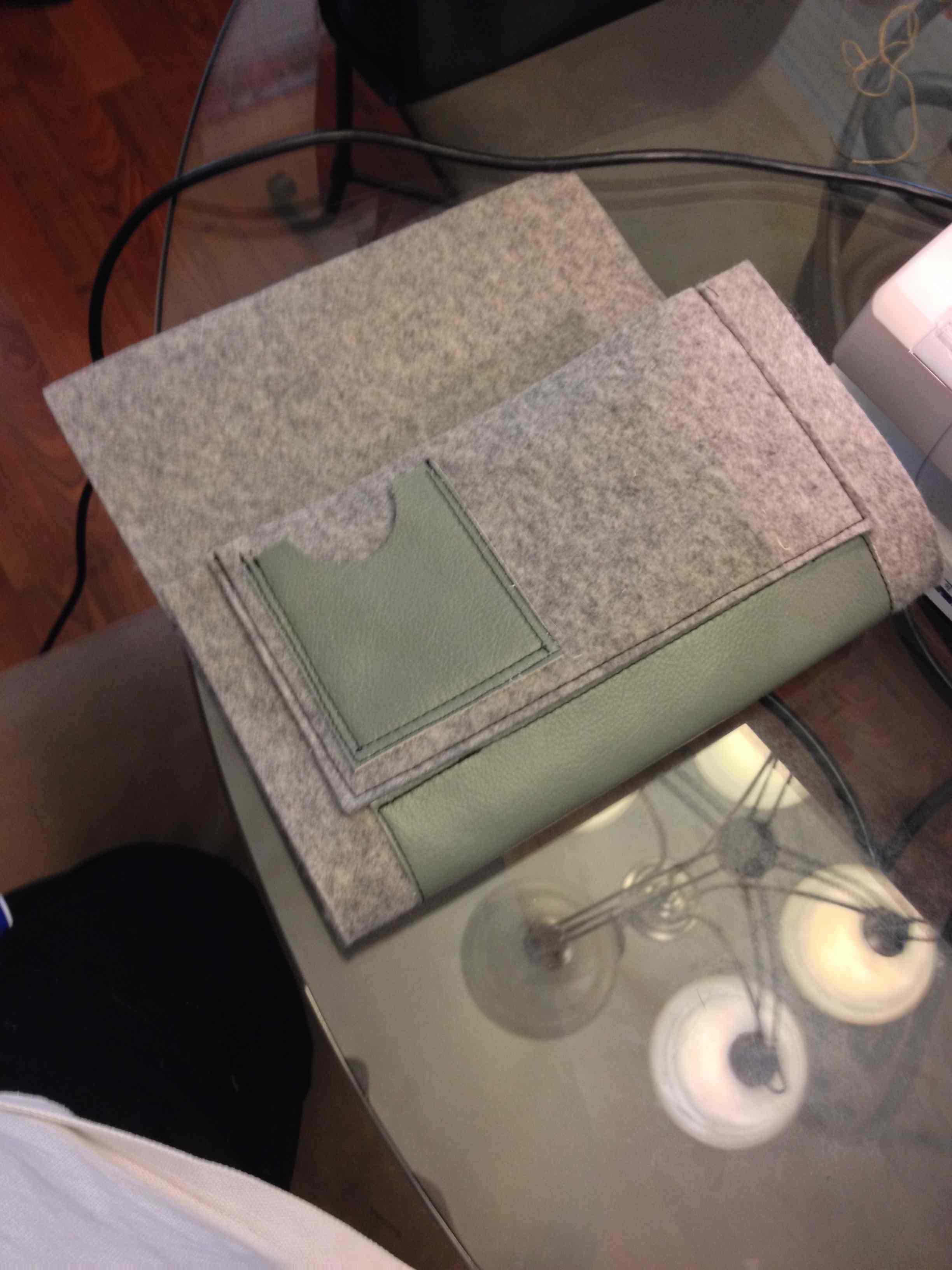

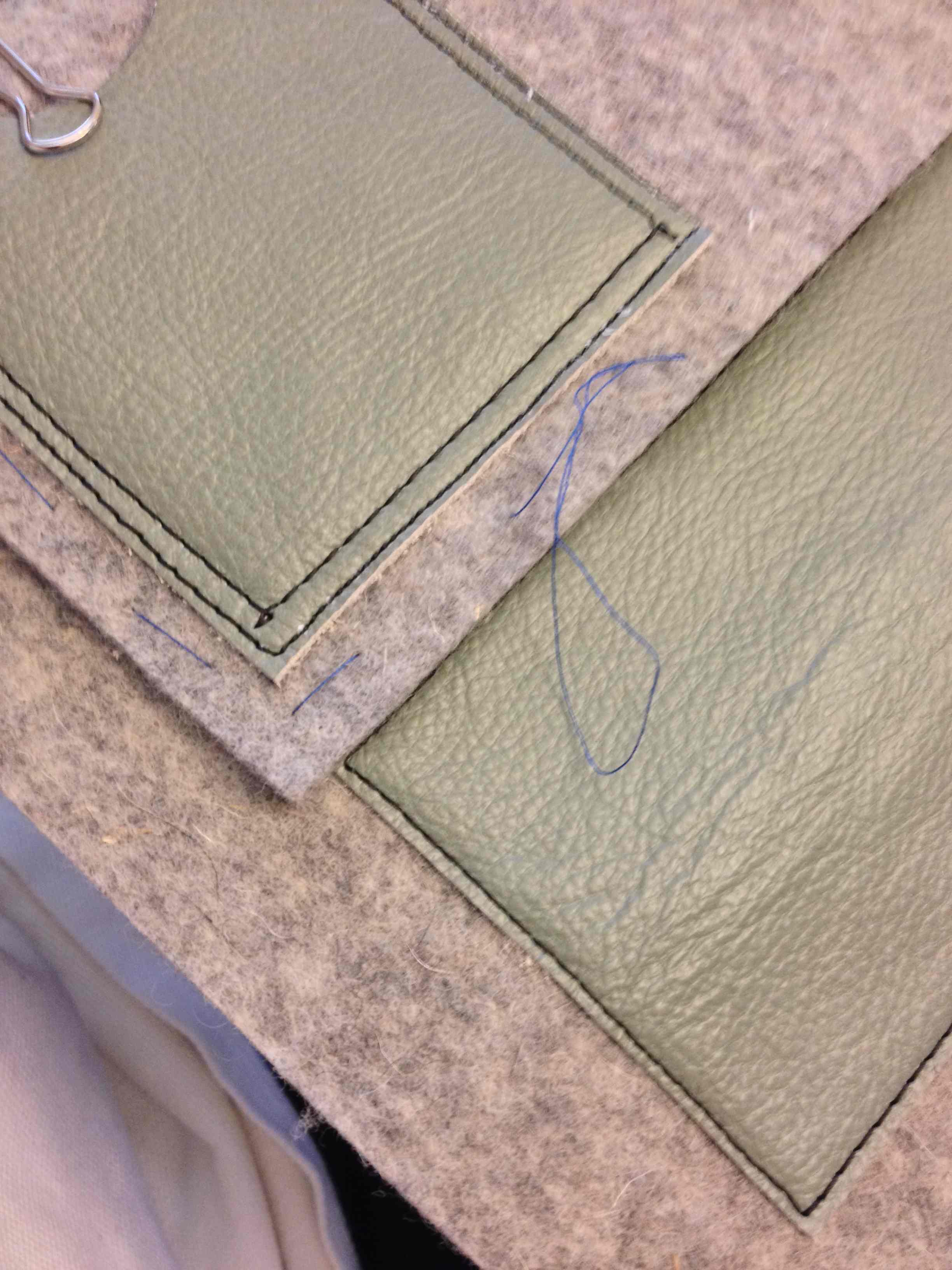

Here's an update:

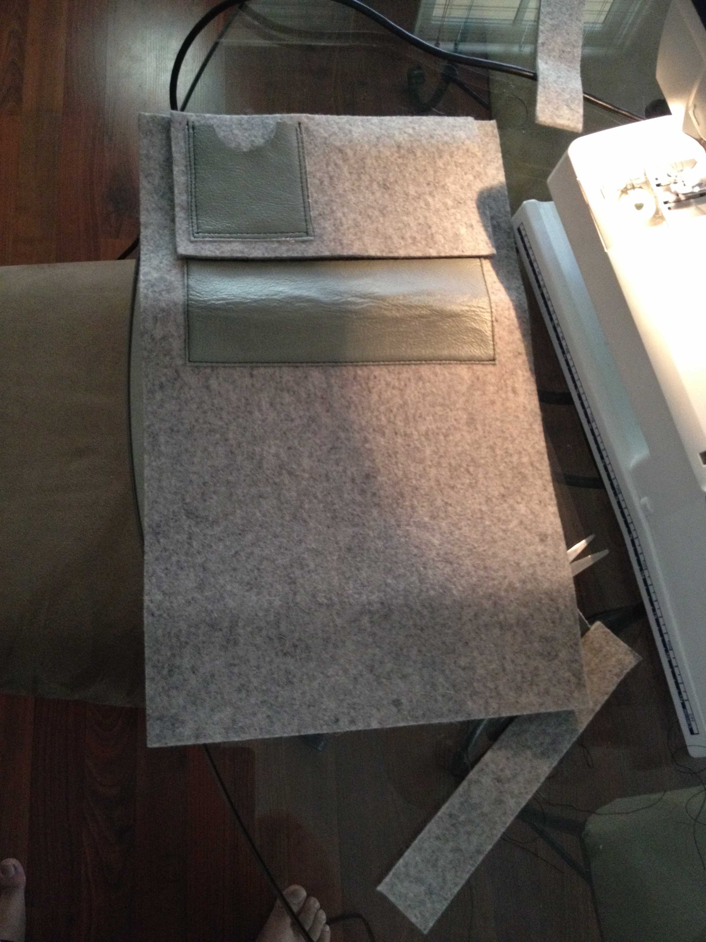

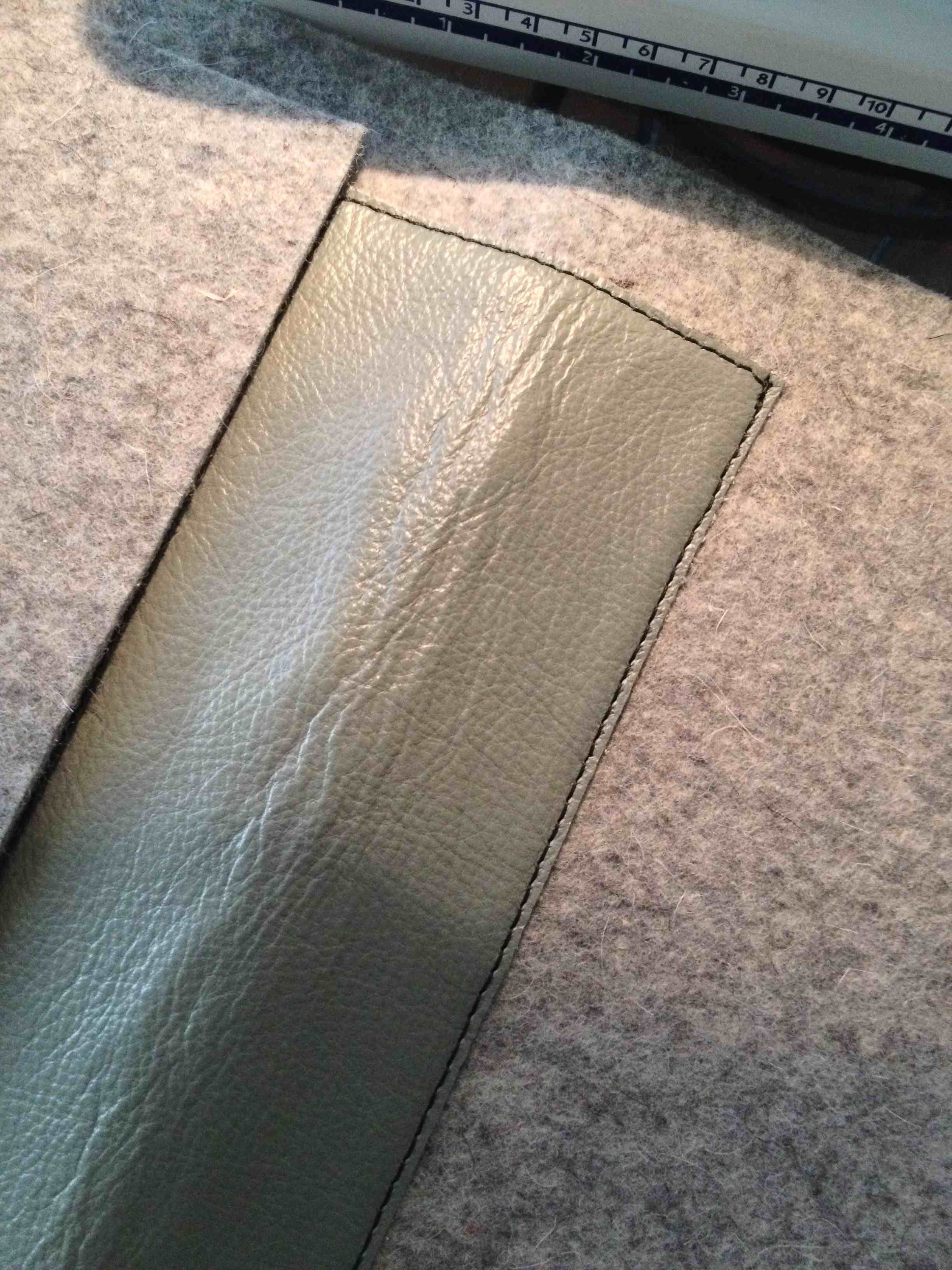

i am using a husqvarna 425 freesia sewing machine with leather needle (a must if you're sewing leather) and an upholstery thread.

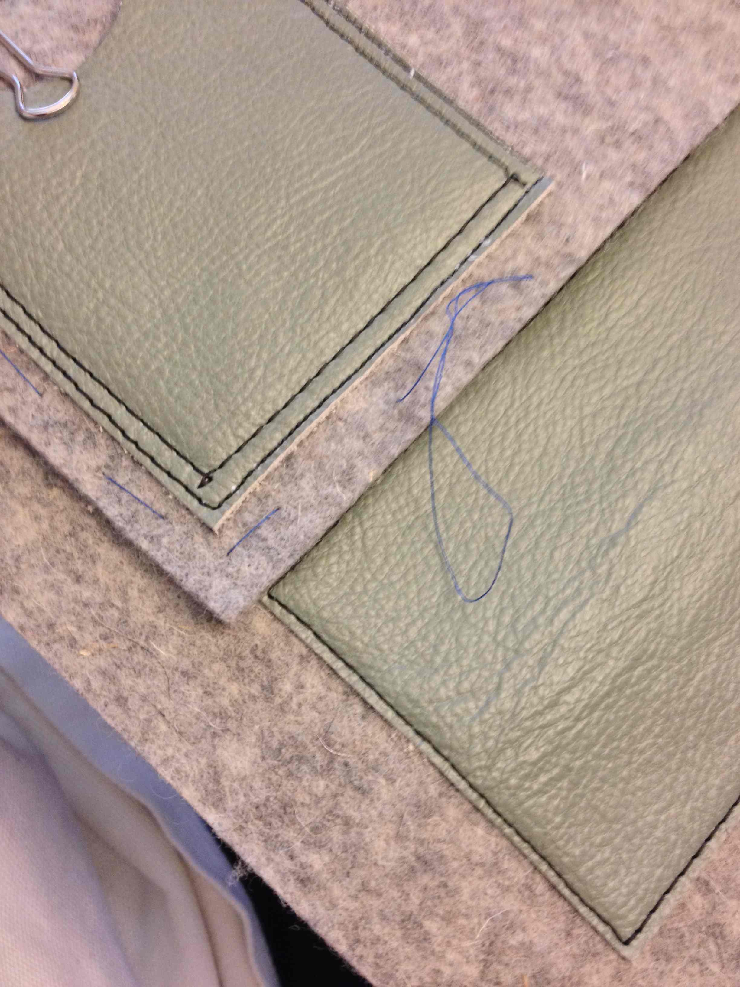

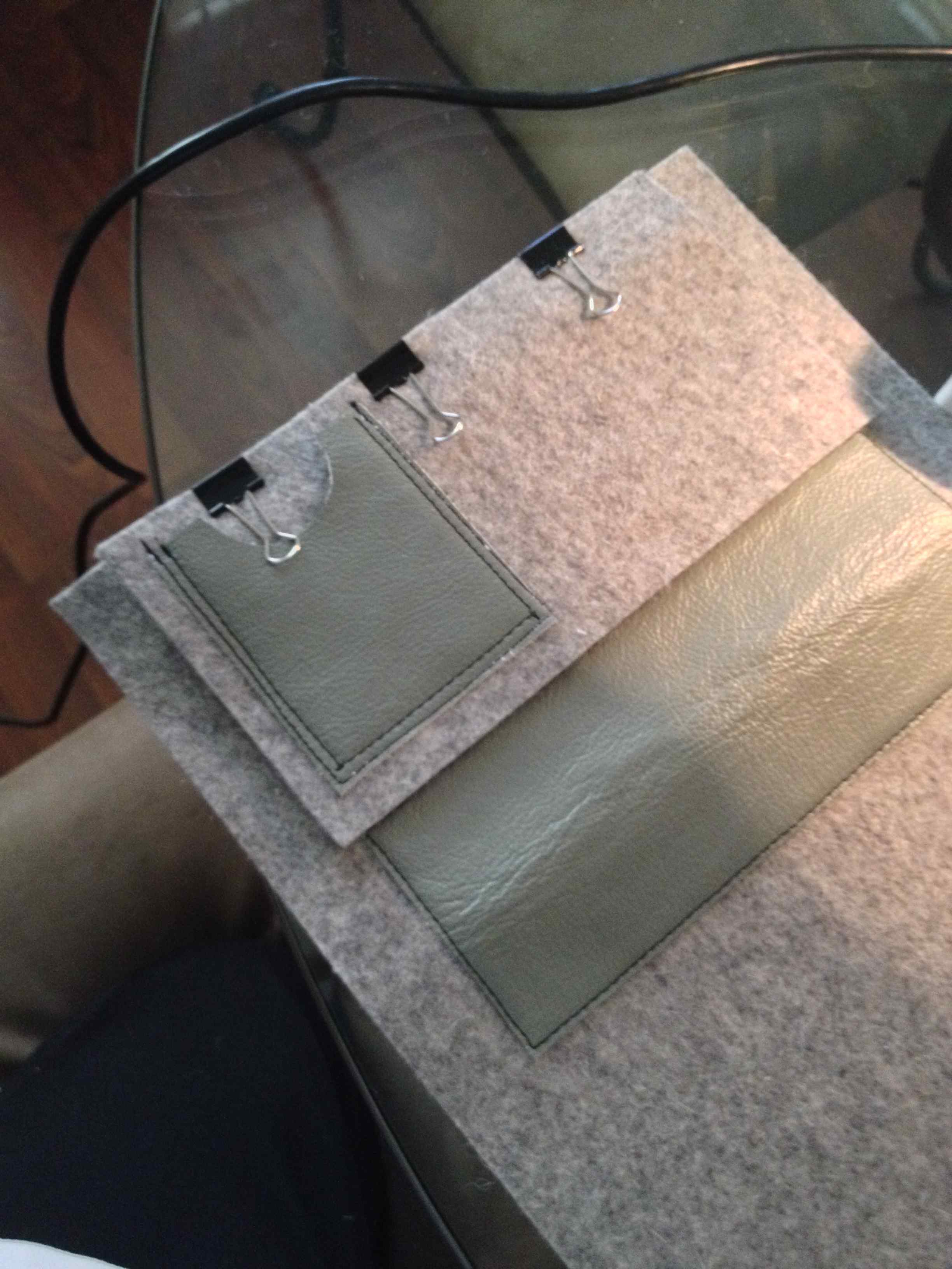

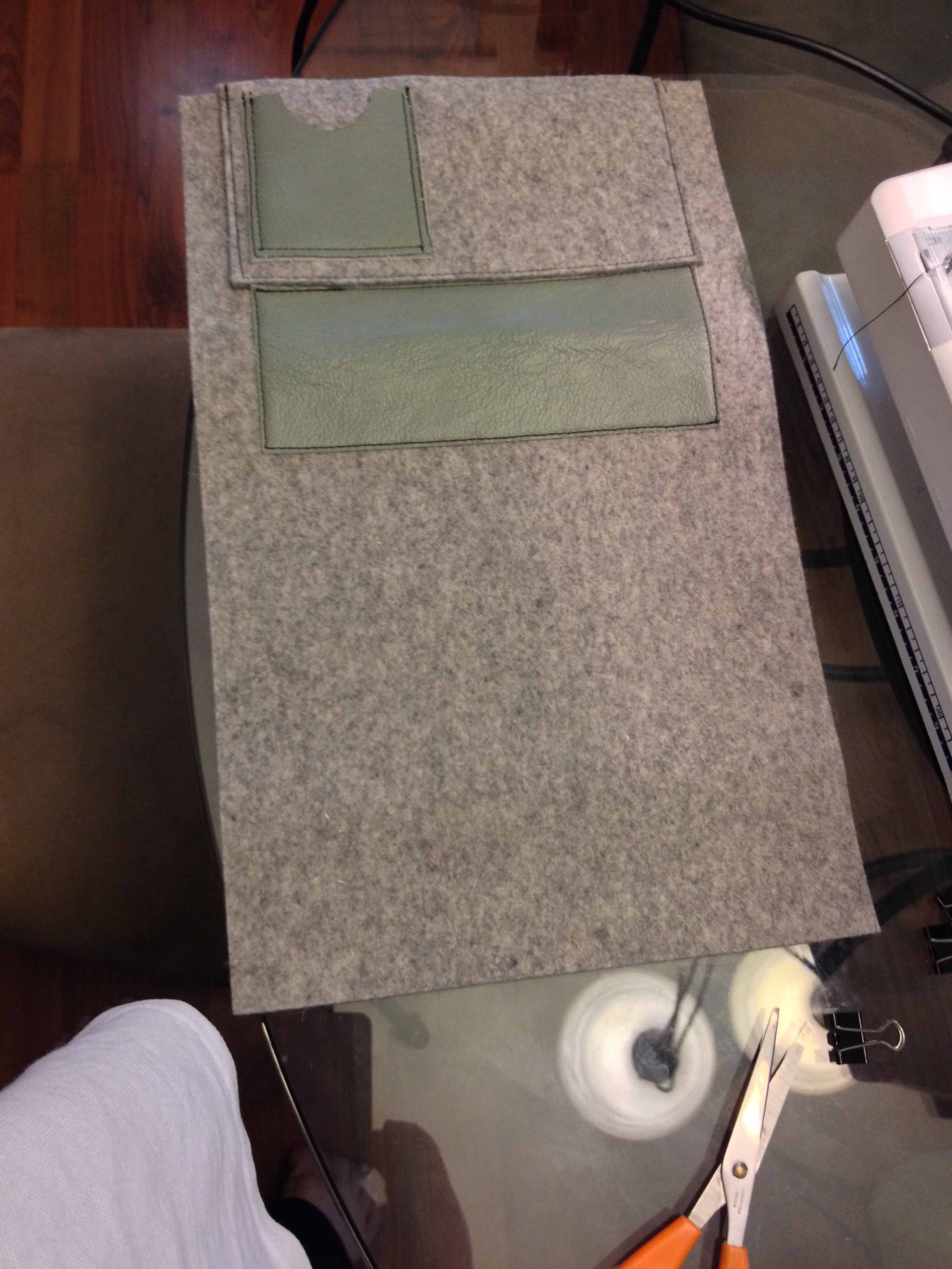

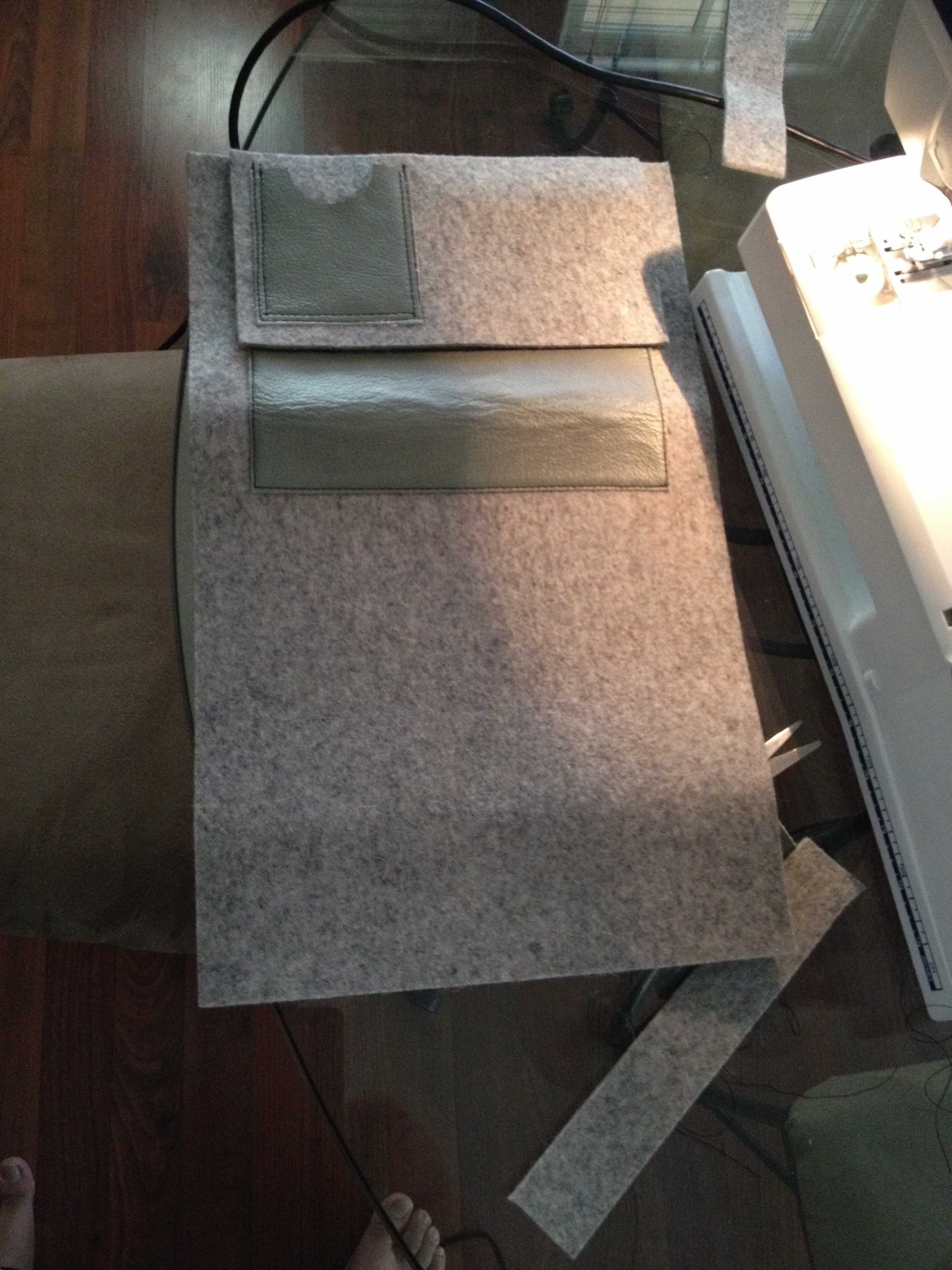

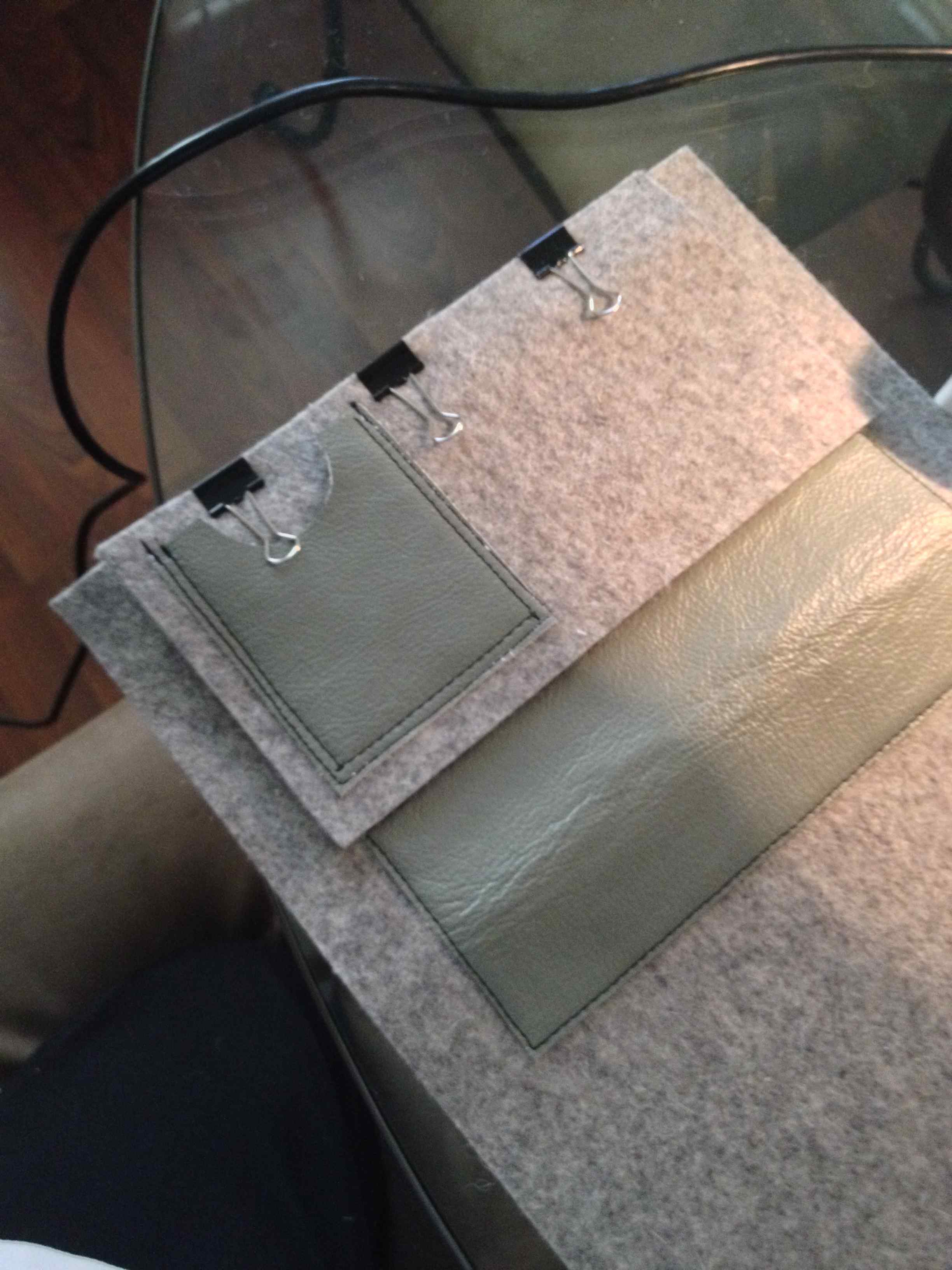

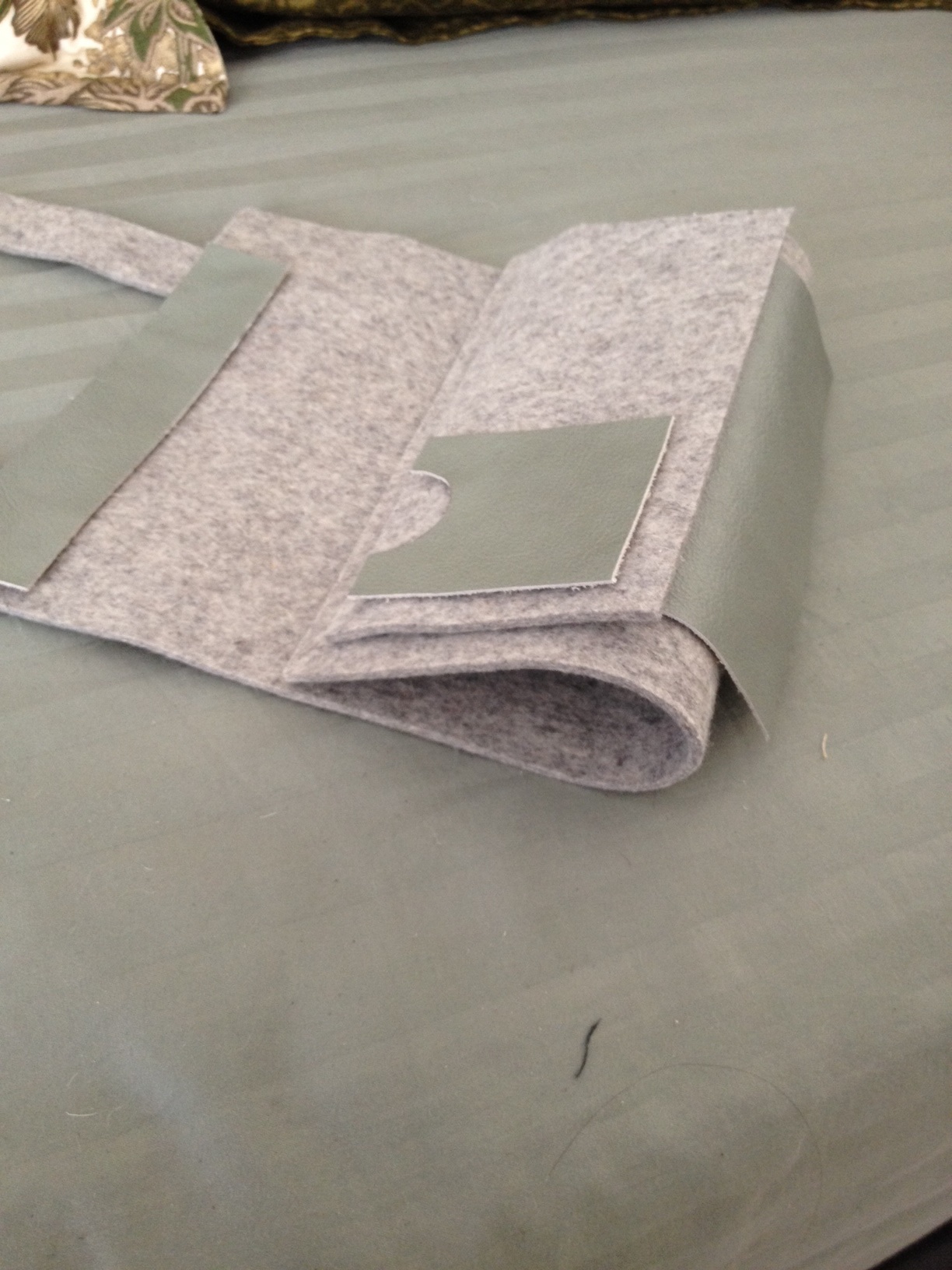

some more pics. i temporarily sew the wool together to keep it from sliding when i use my sewing machine.

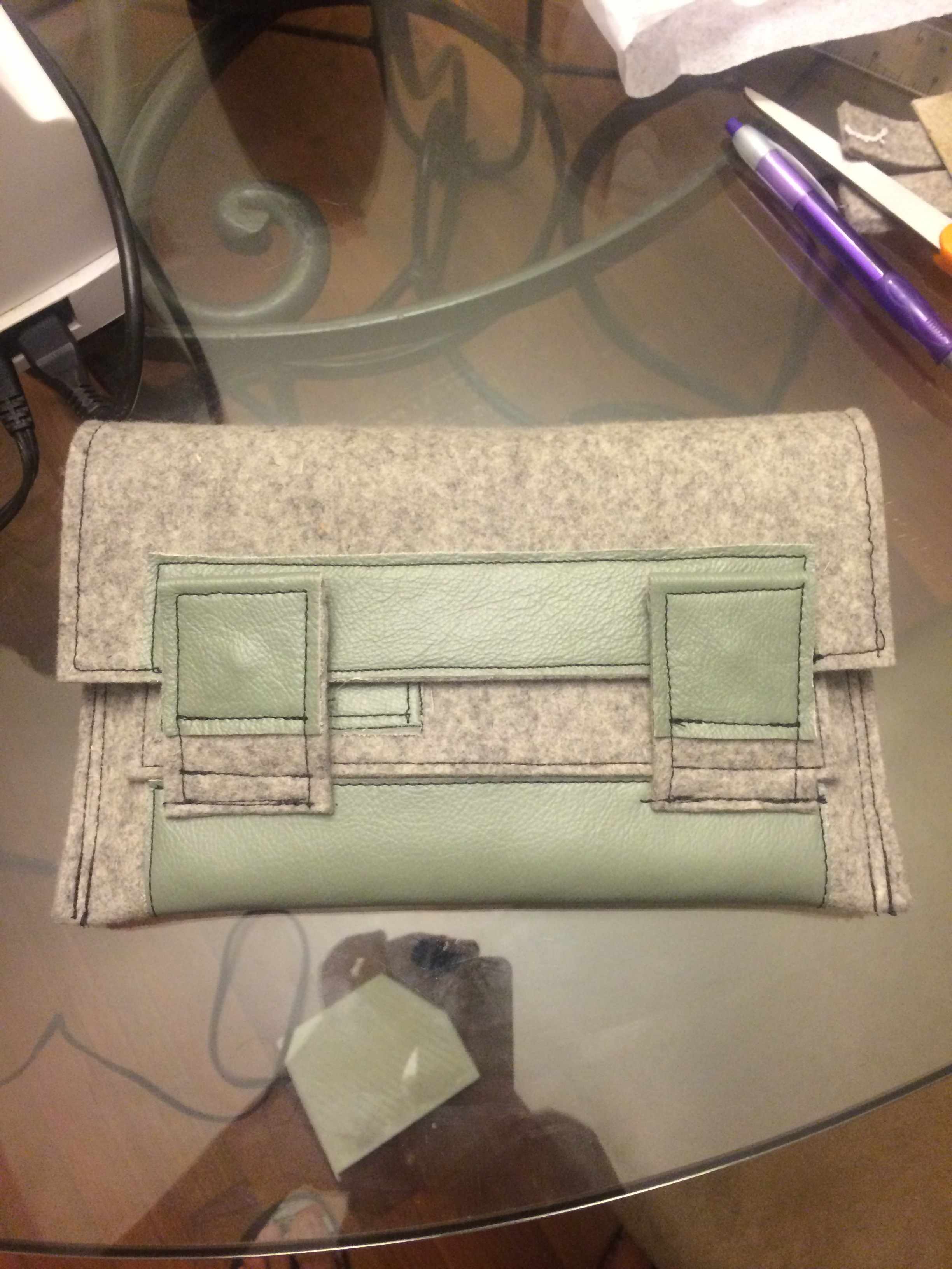

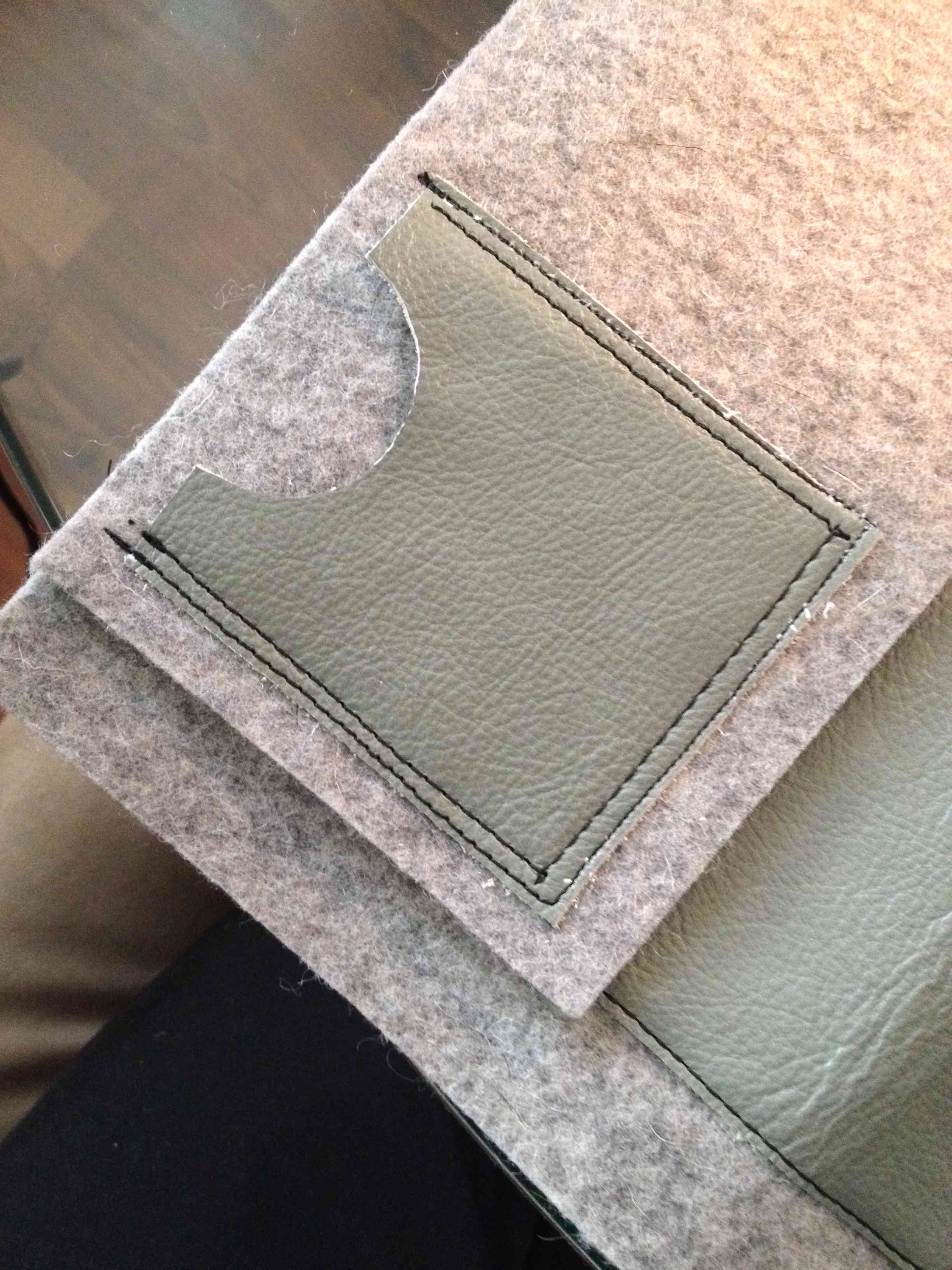

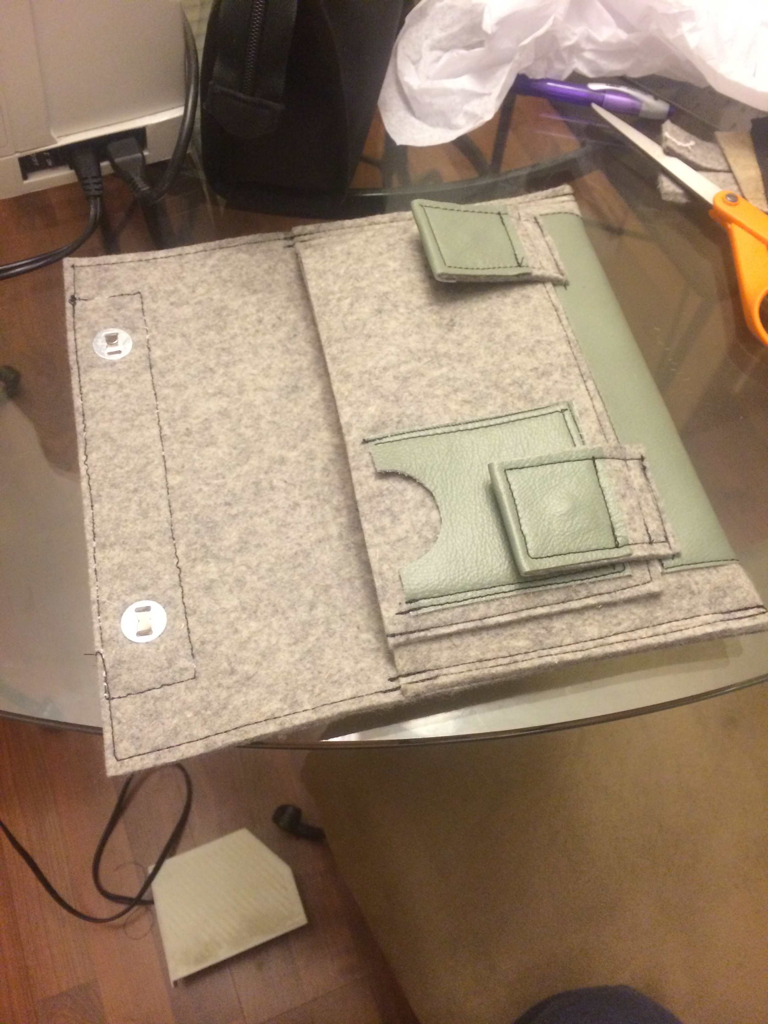

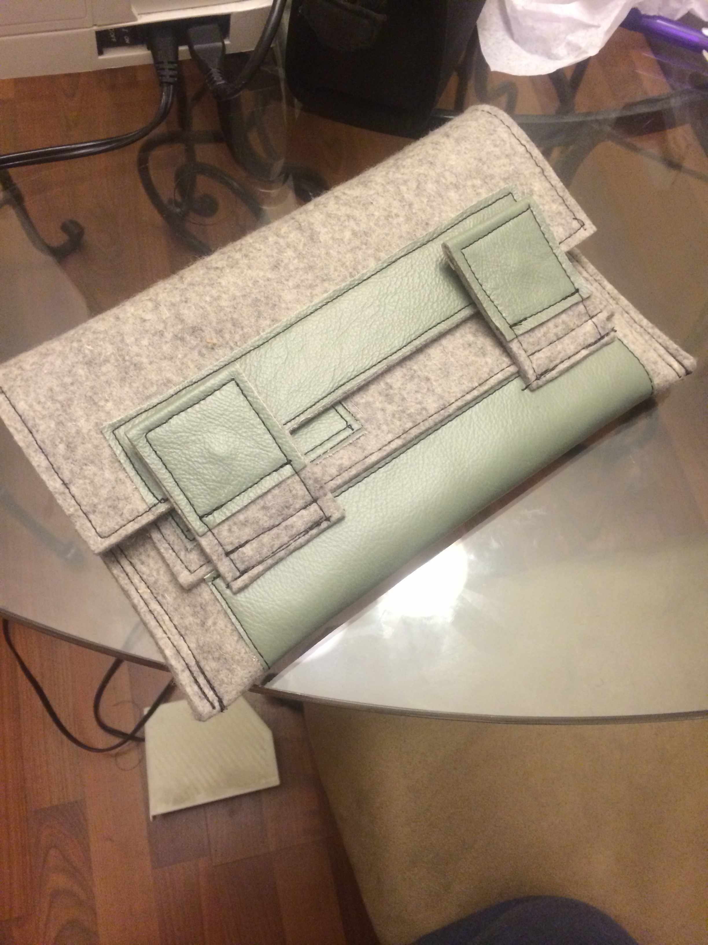

darn. that's awesome to have access to heavy duty sewing machines. i can't find 100% wool felt locally so i ordered online. just get the 1/8" thick as it's really thick enough. it's fun doing it yourself. possibilities are endless. but make sure that you got all your design and templates mad up as once you cut and sew there is no turning back. i made a mistake on the cover lock so i am having a hard time improvising. originally i wanted to have a belt like cover but now i keep on going back and forth. i need to go to joanne's for some supplies and options. will keep you posted.

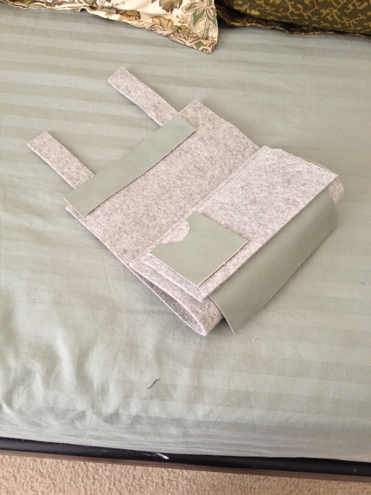

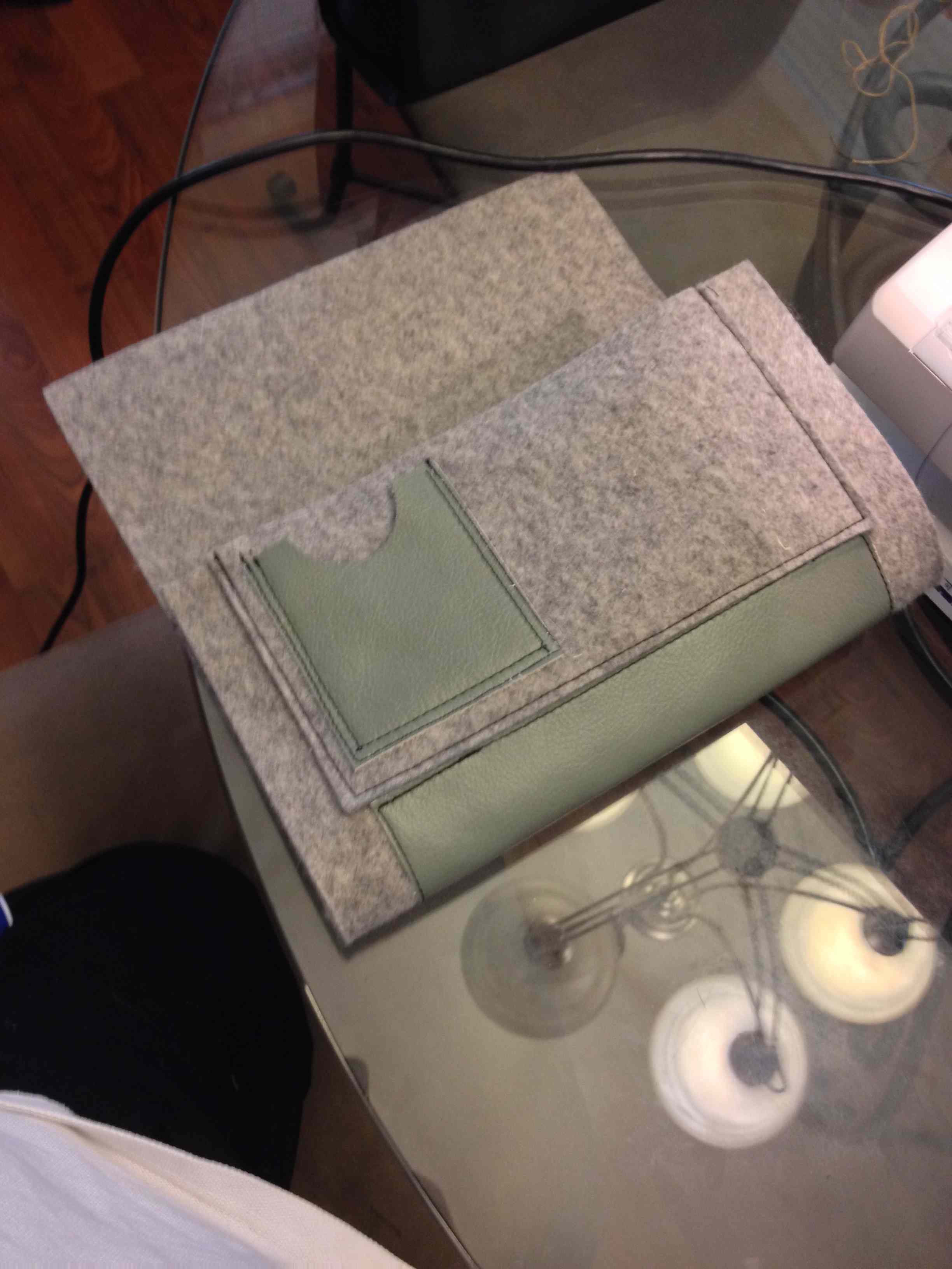

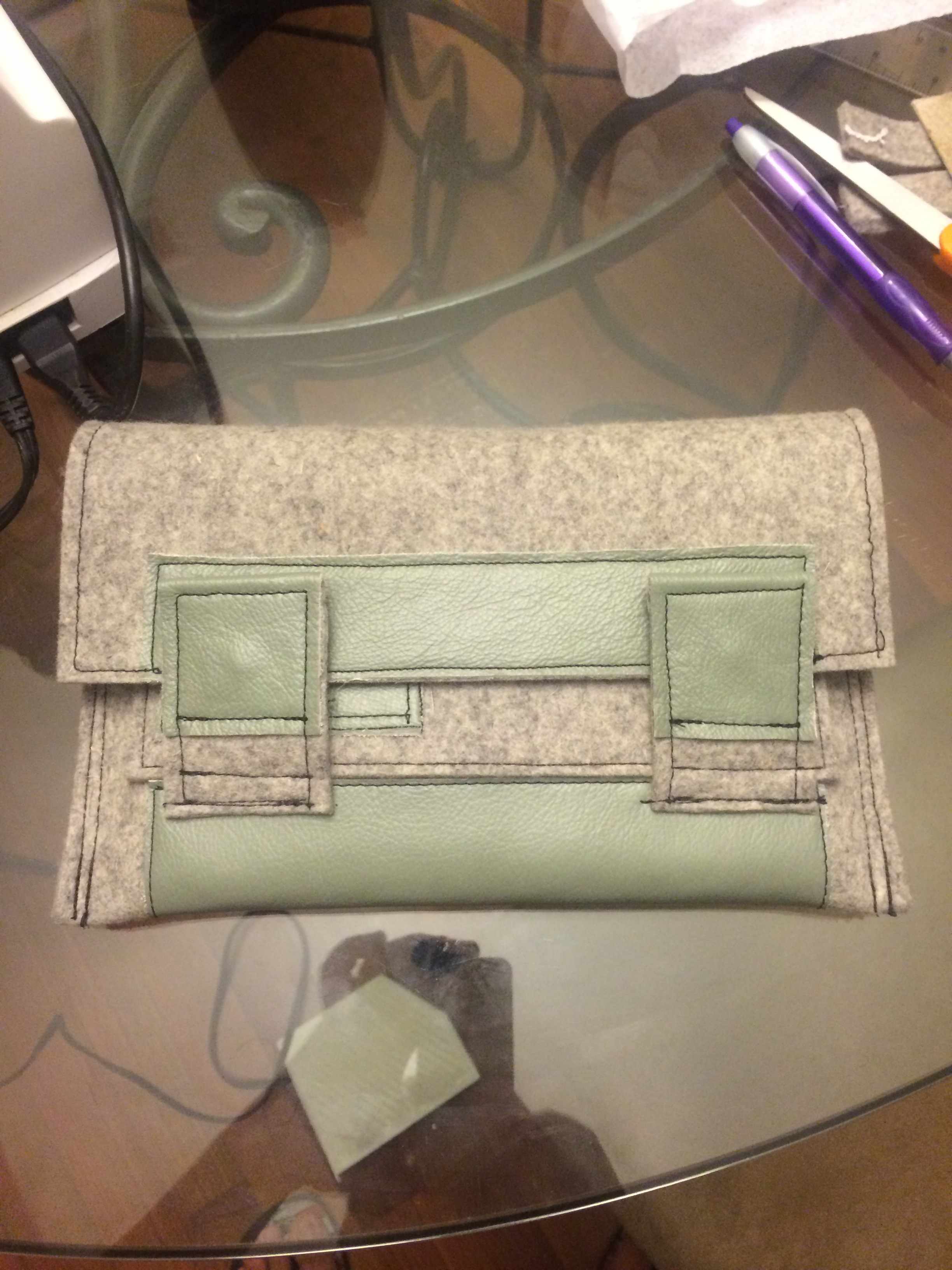

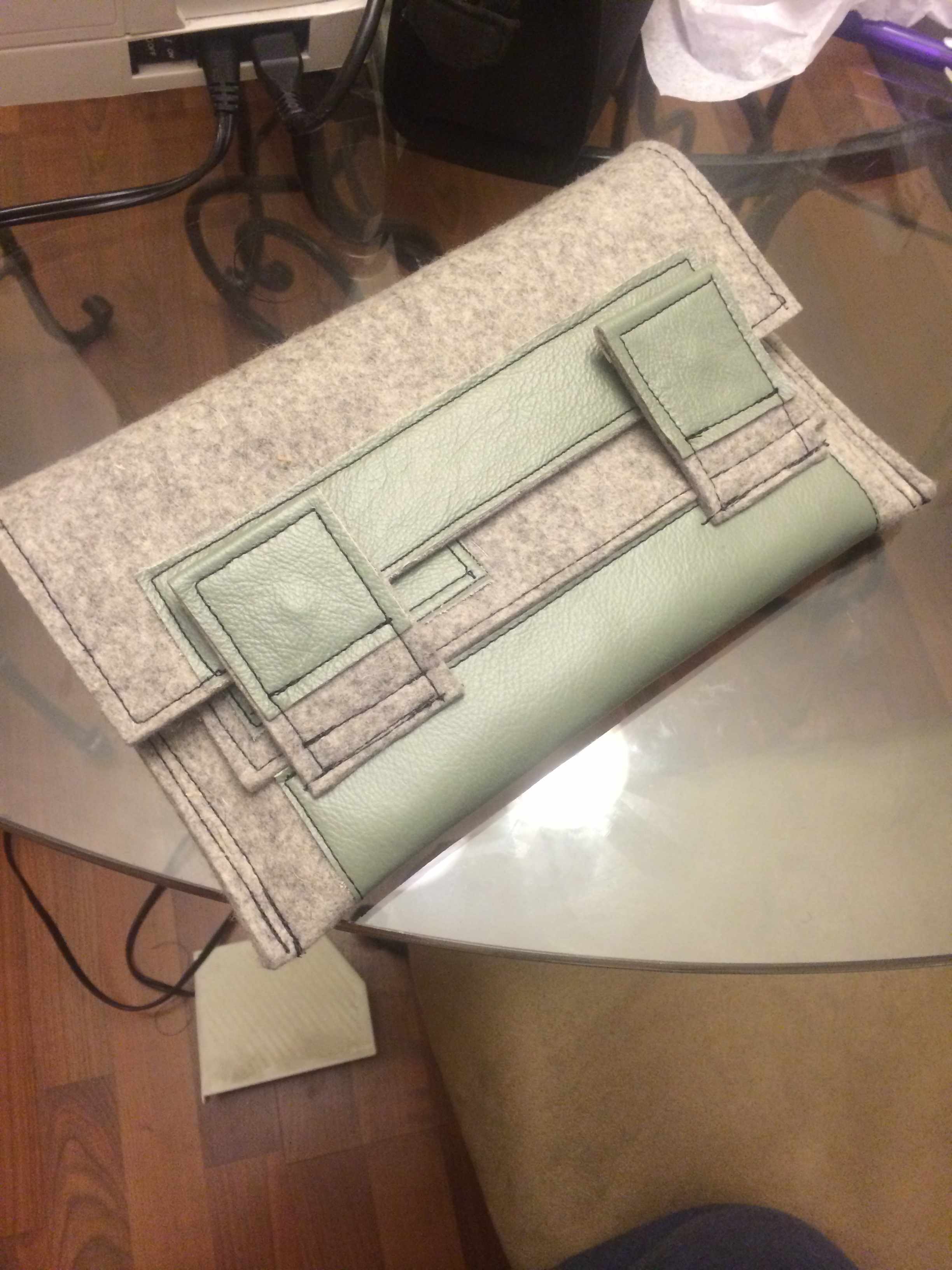

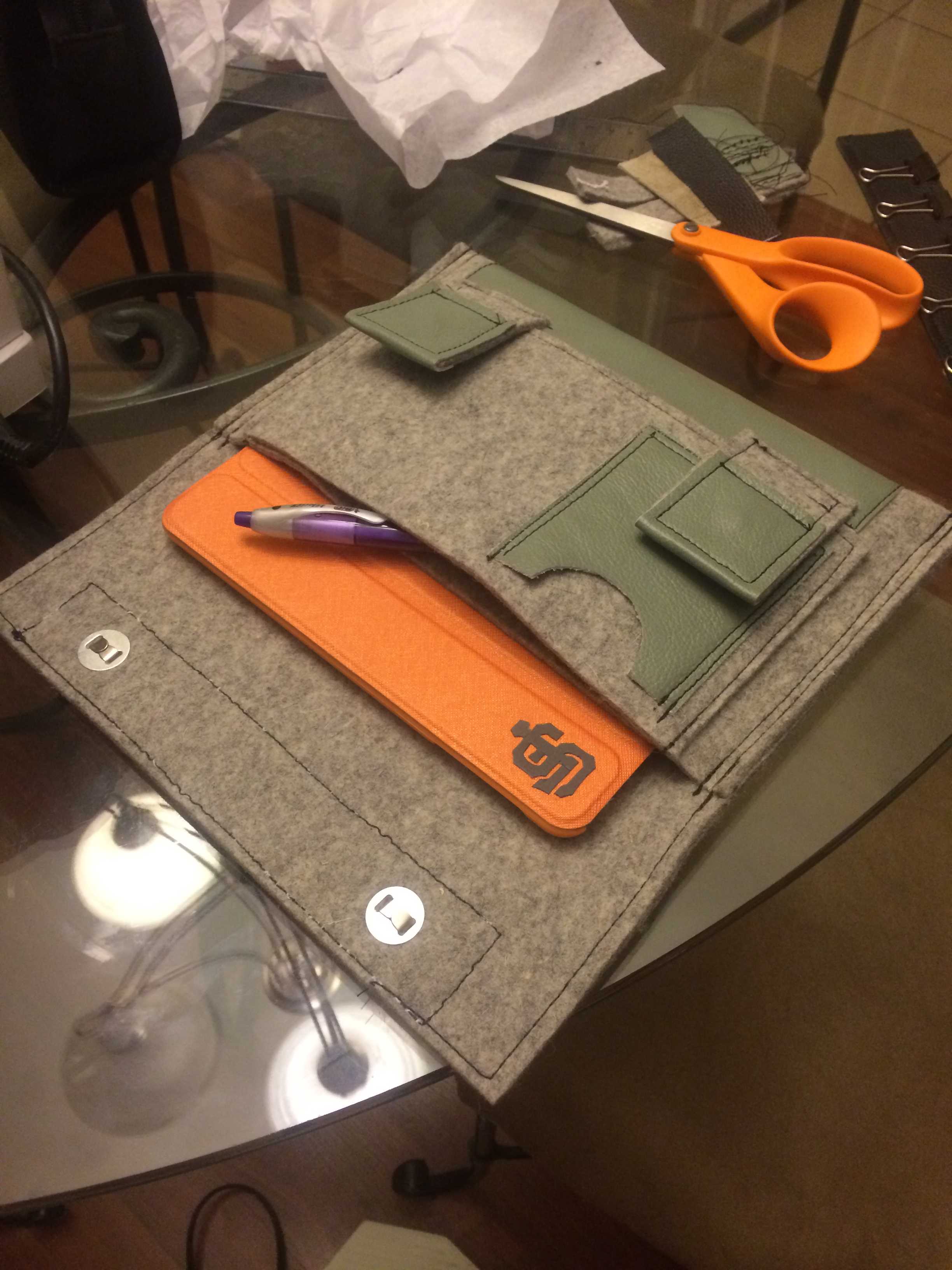

Updates: Finally it's done. maybe not the best stitches as i am using a regular home sewing machine. would be nice if i can get ahold of a commercial sewing machine. maybe not the best design out there but for total cost of $12 (+/-), i am a happy camper. i will now try to make an iphone 5S case/sleeve and will make another ipad mini sleeve. i could say that this one is kinda like On The Job Training. it's quite a challenge i may say as i got too ambitious and had some plan changes when i already have done the sewing. next time i will know better (patterns, patterns and patterns are the key). leather is so hard to sew using your home sewing machine. make sure that you use a leather needle. and the wool gets so thick that sometimes my sewing machine will just stop.
By the way this is 100% Wool Felt 1/8' thick medium F-7 and genuine cowhide leather in light green.

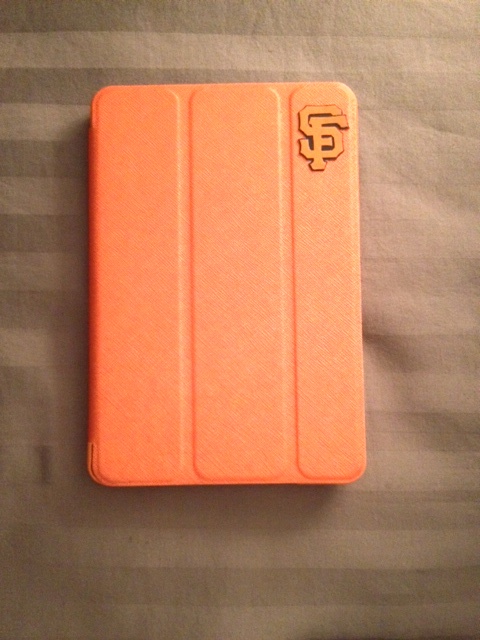

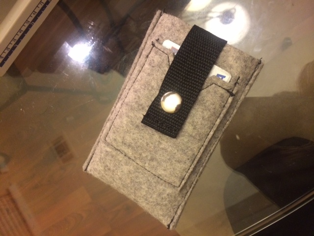

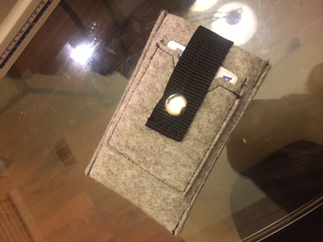

thanks. appreciate it. not the best quality as this is my first project. i will try to make another one with better quality. i decided to make another project for my iphone 5S. here is the case i made.

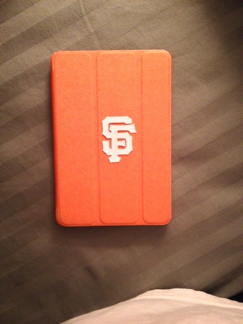

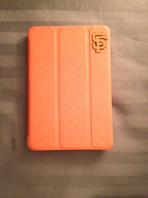

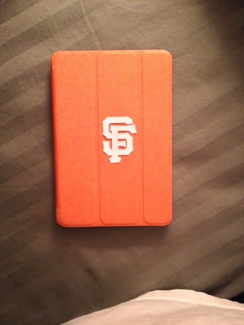

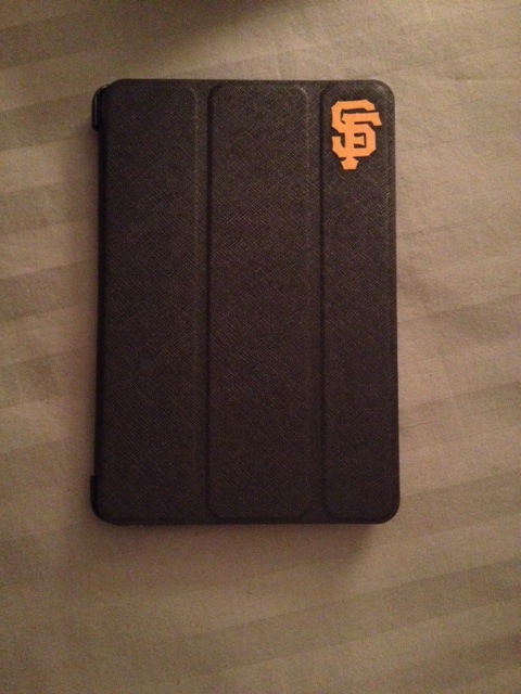

question, did you put a SF sticker on your smart cover or does some place sell it with different sports logos?
thanks
nice!
thanks

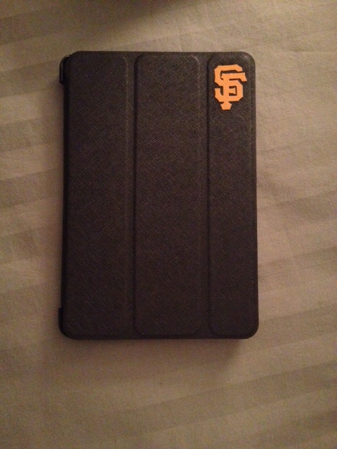

thanks. i just cut out the SF logo. can't find anywhere and the cover with sports team logo is so expensive so i decided to make my own. i cut it out of a lexan label i have.

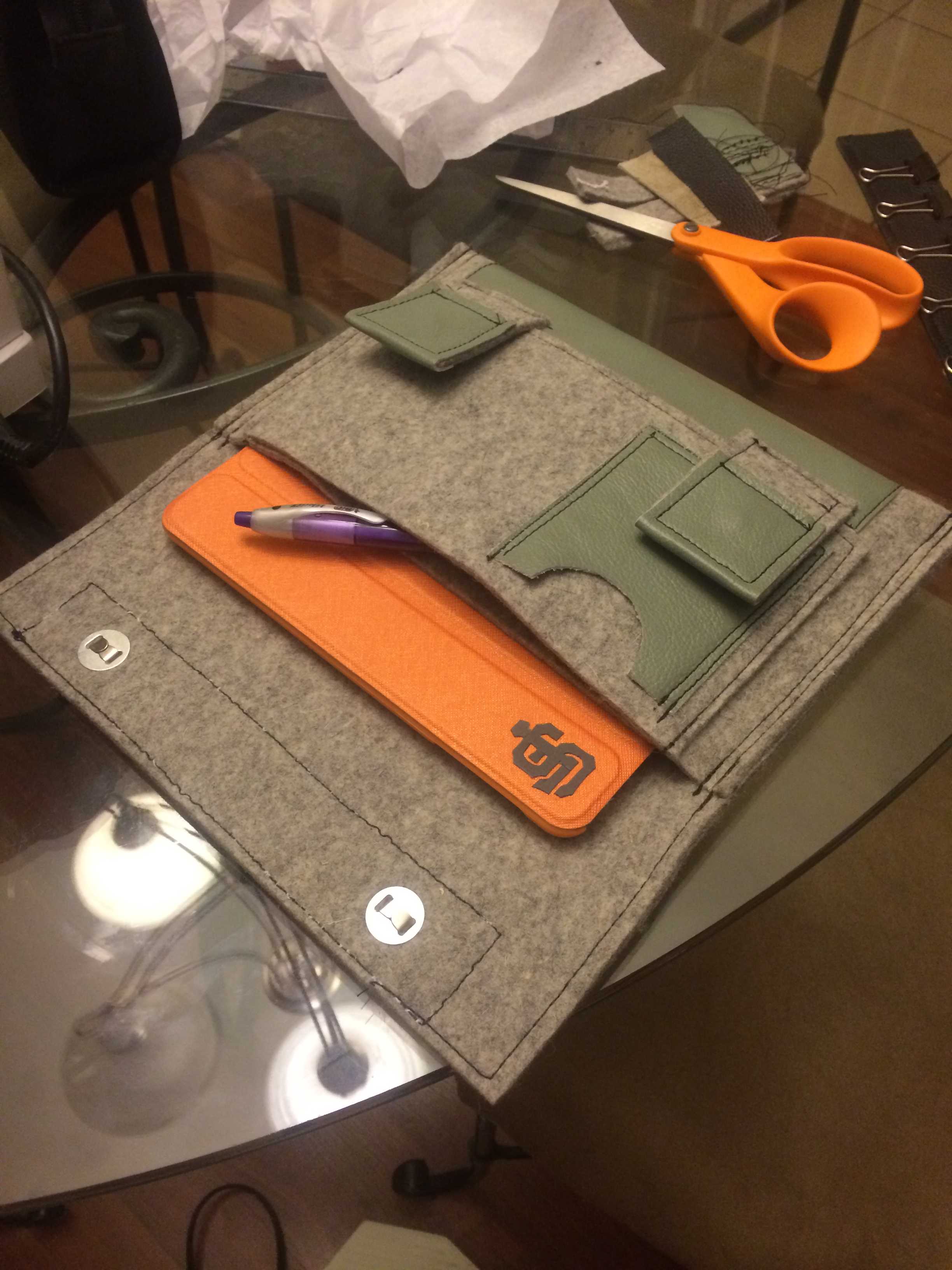

i actually have more cases with the SF Giants logo that i made. i got these cases so cheap that's why i decided to buy some extras.
