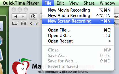

Just regular QuickTime Player. Go to File > New Screen Recording.
