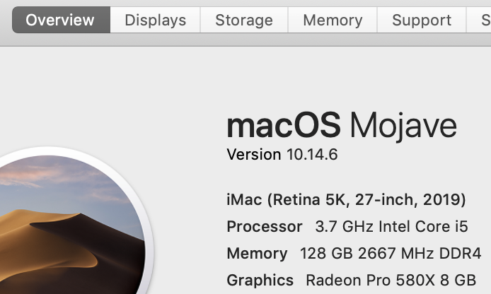

It was widely reported that my model of iMac would support 128GB 3rd party memory upgrade. I am running the iMac (Retina 5K, 27-inch, 2019) 3.7 GHz Intel Core i5 with Radeon Pro 580X 8 GB. I ordered the 4x 32GB kit from OWC. Upon installing all 4 modules I could not get the iMac to boot up. After calling tech support at the memory retailer they told me to try putting one module in at a time and spacing it out 1 to 2 hours between adding each additional 32GB module. I tried that and was able to get it up to 3x32 for 96GB. Each time I would add the 4th module it would crash and reboot, and act very unstable. I tried different modules. I ordered another kit of 4 32GB modules and tested those additional 4. Each time I tried bringing it up to 128GB it failed the Rember test, and would powercycle itself randomly at 15 or 30 minute intervals, booting back up to an error message. Apple is saying it wont work past 64GB. I have got it up to 96GB and it is stable running intense programs and does not crash. I have tested it with 8 different ram modules and it seems it is not a problem with the slot or any of the modules itself, but rather the system itself does not tolerate 128GB as the memory reseller claims it does. Currently I am out of pocket $1,700 on this memory upgrade and am going to be returning the excess and keeping it at 96GB unless there is a problem. I would not recommend to try 128GB. This is definitely not a configuration that this version of iMac tolerates. Once you start opening programs it will crash and turn off with 128GB installed. If you are just looking at the desktop it may stay online for up to 1 hour but will eventually power itself off.
Any updates w/ your issue? Maybe I should just settle w/ 64gb.
Having upgraded multiple 2019 with 128GB, you must have a bad module causing issues. I've only used Samsung modules in my upgrades, but all of them are 100% working to this day.
