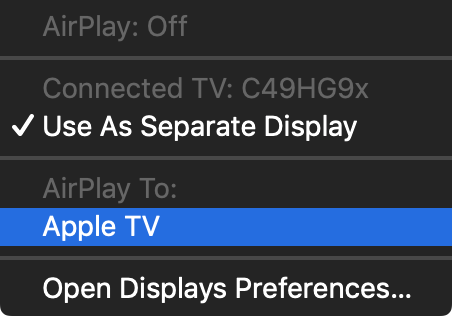

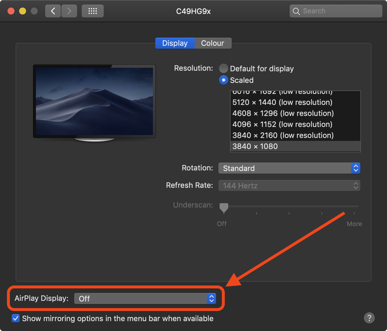

10.14.5 officially released.
And this Airplay Display option also officially shows up on our cMP.
However, it isn't working yet.
My understanding so far is that this function require HEVC hardware encoding. We already have H264 hardware decode, H264 hardware encode, and HEVC hardware decode. The only thing we are missing is the HEVC encoding.
Since now this is an official bug in the macOS. I would like to ask all of you to submit a bug report to Apple (via http://bugreport.apple.com ), and hopefully after 5.0GT/s, NVMe bootability, HDMI audio...... we will able to enjoy the full hardware acceleration from our GPU. Thanks!

Is HEVC encoding enabled in Windows 10(or 7) for the RX-580? From memory I did not see it there either so maybe it is not available for 580?

This option wasn't there on or before 10.14.4, but should shows up in 10.14.5 now with RX580.
I have this option since 10.14.5 beta, no matter if I inject the board-id or not. You don't have this option now?
AFAIK, HEVC encoding always supported in Windows (since the GPU release).

Of course no need to make up some bug report if you don't have that. I believe it may need Polaris or newer card to have this option.

The icon and interface was present with the 580 during the Mojave beta (not sure exactly which versions). We had a thread here about it at the time. I remember booting into 10.13 with the 580 installed around that time and seeing the Airplay icon there too. Of course it didn't work at all, but gave us hope it would be fixed.
Instead, either in one of the last betas or the GM of 10.14 Apple removed the Airplay menubar icon and interface from System Preferences > Displays.
It's interesting that it has returned. Might be inadvertent given that it's still non-functional. Or maybe they really will enable it. When I researched this last year I remember finding some discussion about it reading someone say that QuickSync is required for it to work, which if true would eliminate the cMP from ever getting it regardless of GPU since QuickSync is a CPU feature and the cMP's processors pre-date QuickSync. But that person may have been wrong or just guessing.

It only need HEVC hardware encoding, not QuickSync. Since iMac Pro have that from Vega, we can also get that via Vega.
Also, eGPU (RX580) should also provide that in 10.14.5 now. Which means the function is there. We should able to get that via RX580.
Since the PULSE RX580 is the Apple recommended GPU for cMP. Therefore, it's entirely possible for us to have Airplay Display.
