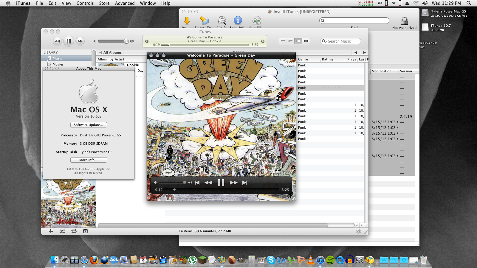

So I'm working on a project that, in all honesty, probably won't work but I'm trying. I'm trying to create a modified version of 10.6.3 that works as if it was 10.7. I have everything working except for being able to sync devices, which is the entire point in doing this. Can someone tell me where the Applemobiledevice and etc are located on 10.5.8?
Here's a photo of a very minor iTunes 10.7 feature running on PPC

Yeah, I did notice I could sync my iPod with iOS 9 to iPhoto 09 on my G5. Thats what started me trying this. But if you couldn't get it, I'm sure I won't then. I'll still give it an attempt though. I do need to find the kexts for syncing though so I can put the correct one back in. I messed something up where I can't sync anything to iTunes anymore. Whoops.
