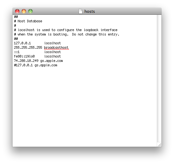

I have never done this type of thing on the Macbook before. I get to the part where it says to arrow down. . but i dont undertand how to use the # that the instructions are saying. Can someone give me a visual guide? It would be so appreciated!!

In my above post is a screenshot of what the article was talking about.

Your host file must be set for Cydia and not Apple.
if you want to use your own MBP or anyone else have this issues, just open terminal and ping gs.apple.com
If you get 74.208.10.249 or something on that range, your host file is set to look at Cydia's servers (you may have used Tiny Umbrella before and it used to close without changing the host file back) Specially if you are or have been Jailbroken before.
if that is the case just edit your host file to look for Apple's server, you can search or google for detail step by step on how to do that.
