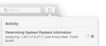

Even after these few years from that quote (2014, holy ****...), I've gotten a new laptop and rebuilt my library from the ground up (mainly cause I had a long of crappy 192/320 singles and whatnot from the 90s), and this still happens. Less frequently, but nevertheless its just a hit or miss when iTunes decides its done playing a track halfway through and just skips to the next. The only thing now is iTunes does this everytime I open it (even when i let it finish, every time i launch it, it does this all over again):
I don't know what it means.
No one on Apple support forum knows what it means.
Pretty safe to say that even Apple themselves probably doesn't even know what that means.

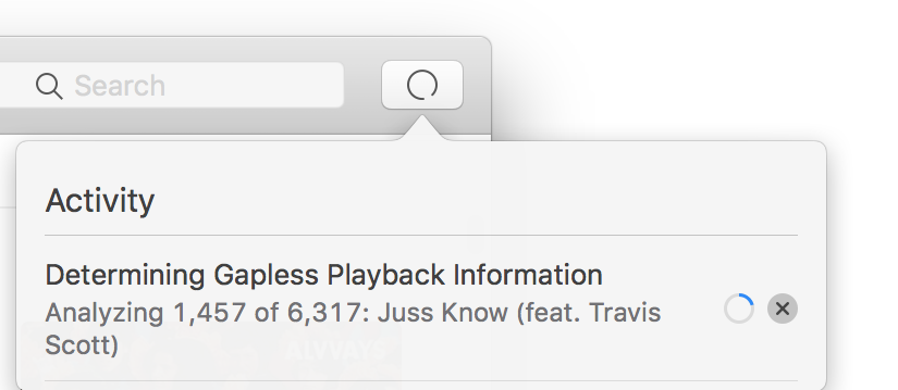

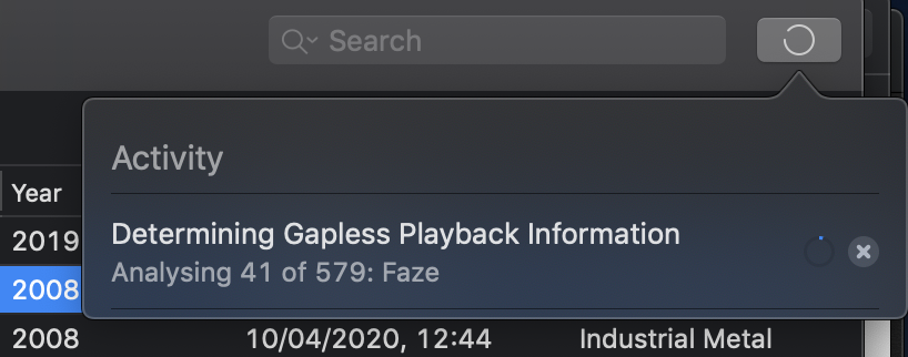

Just started experiencing 'the one true problem' this week - April 2020. I'm on Mojave 10.14.5 with iTunes 12.9.5.5. For me almost every imported file was skipping on to the next track at 2.17. I agree with your analysis - it's nothing to do with the files themselves, its a meta-data issue. The good news is I seem to have identified where the bad data is sneaking in!
SOLUTION: On importing an album folder (by drag and drop onto the iTunes window), wait until all tracks have copied, then look at the top right of the iTunes window. You should see a new temporary button appear, with a rotating circle on it. Click on this, and an 'Activity' pop up will appear, bearing the words 'Determining Gapless Playback Information'. Hit the 'X' button next to this the cancel the process. See attached image. Your tracks will now all play to the end.
in my case, the clue that iTunes has thrown a moody is that the 'Determining Gapless Playback Information' process is clearly attempting to repeatedly re-do the last 600 or so tracks I have imported, and has arbitrarily decided that all tracks are 2 mins and 17 seconds long. Perhaps by cancelling it for a while it will eventually right itself. In the meantime, bear in mind that your newly added songs will not crossfade - but for me, this is bearable when compared with all the tracks being borked!
Hope this helps somebody.
