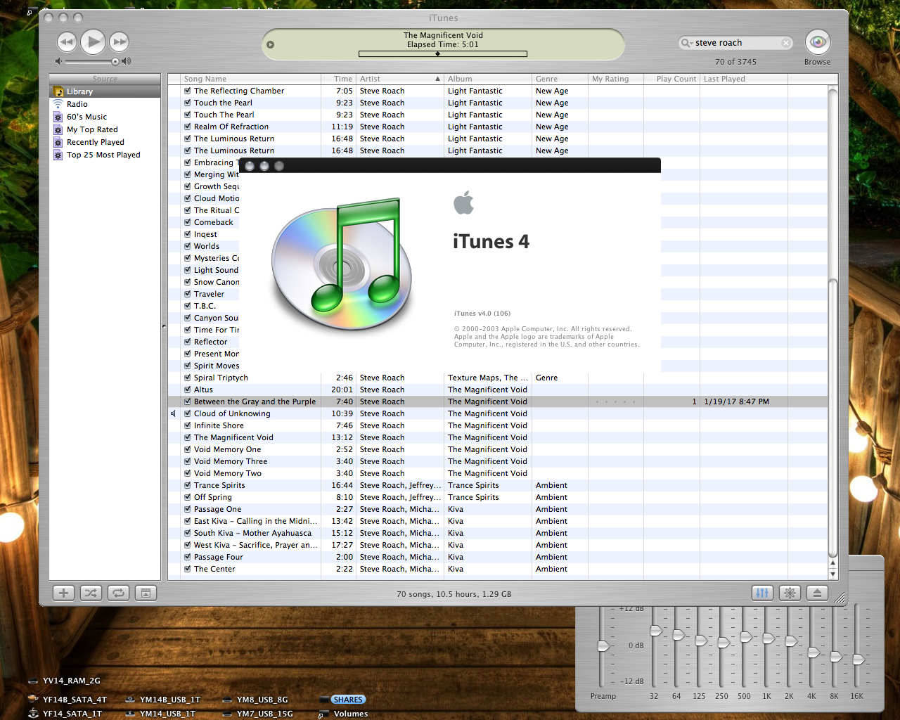

You may have heard from me the following over the last few years: "iTunes 4.0 is the only version of iTunes that was capable of streaming shared music libraries over the internet."
Once, a long time ago I had iTunes 4.0 set up on my TiBook at home and on the G5 at work. To stream your shared music over the internet you had to be using the EXACT same version on each Mac.

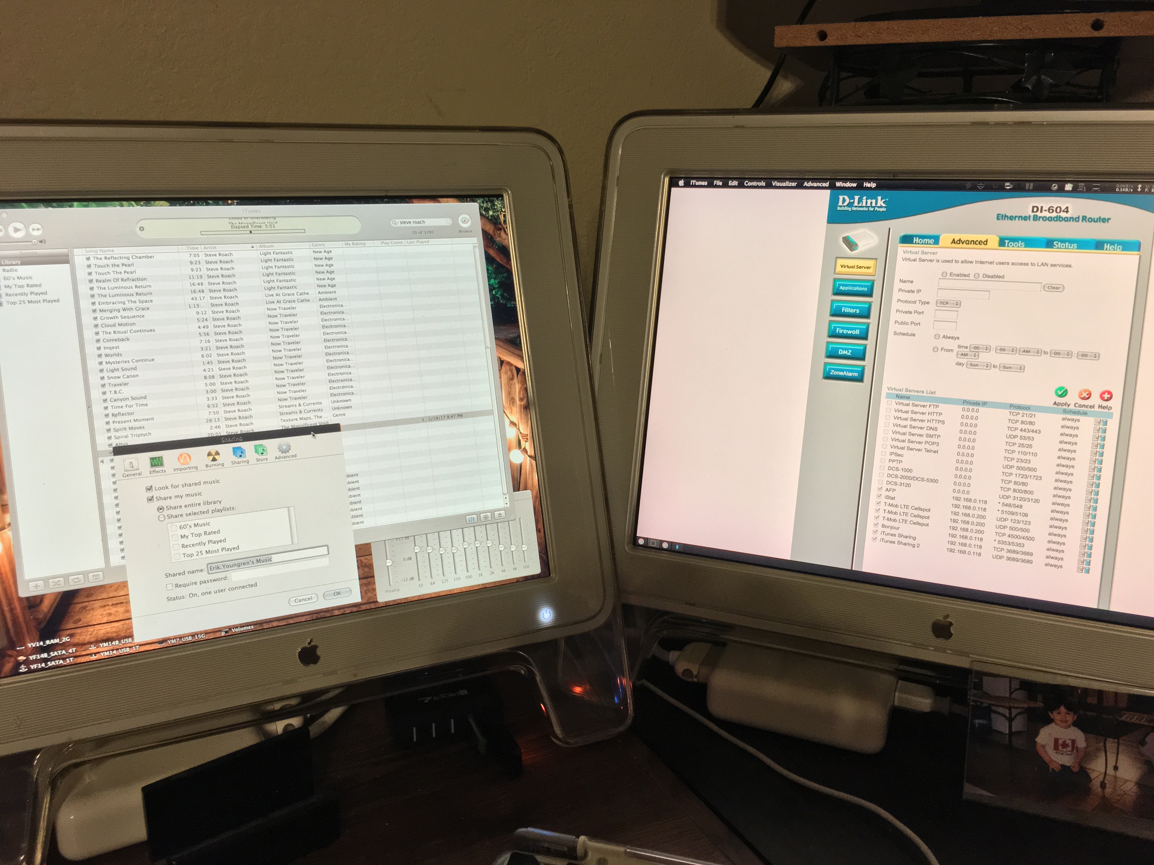

Tonight I decided that iTunes on the G5 and my PowerBook don't matter any more because I am now only using them to play music. So, I set this up again.
As you can see my PowerBook is tethered to my iPad (to get an outside IP address) and is streaming my shared library from my G5 over the internet.
All you have to do is open port 3689 UDP and TCP in your router.
Keep track of your router's WAN IP address and you can connect anywhere in the world and stream your music - as long as you're using iTunes 4.0. 😀

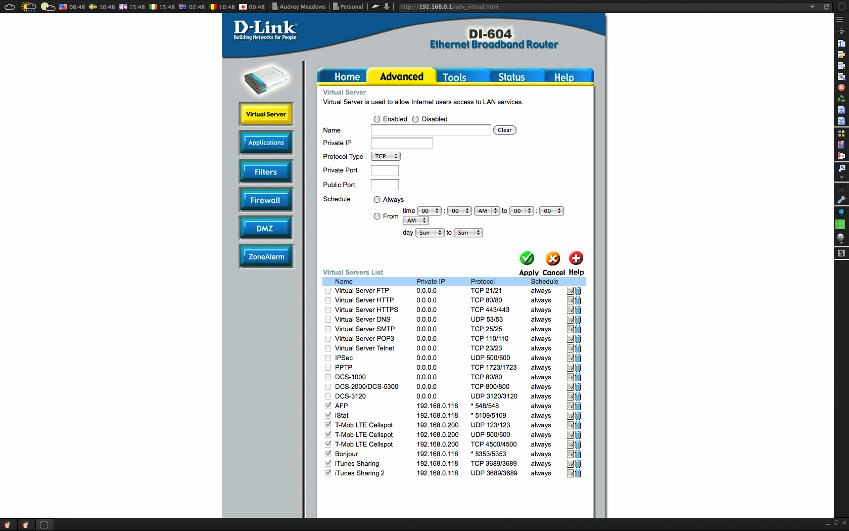

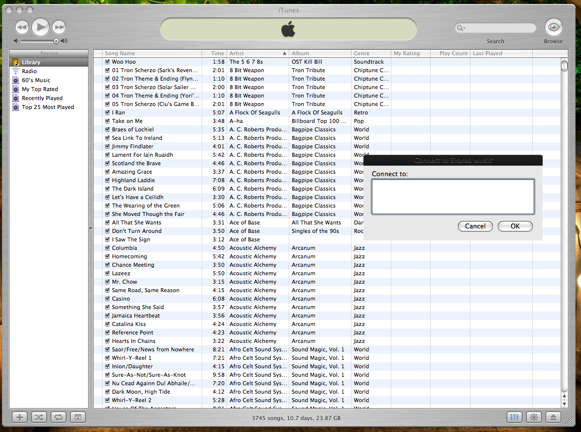

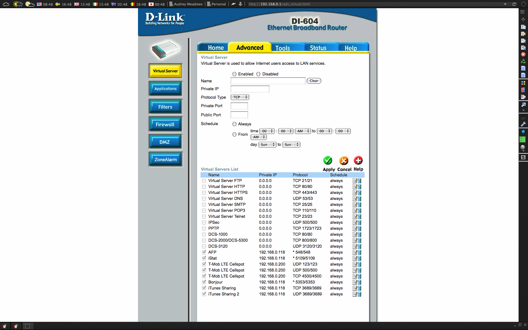

You need to open ports 3689 UDP and TCP on your router and point them to the private IP address of the Mac that will be sharing your music. Here's what it looks like on my router (192.168.0.118 is the private IP of my G5).
Then just use 4.0 on the Mac you want to share the library from and 4.0 on the Mac you want to access the library.

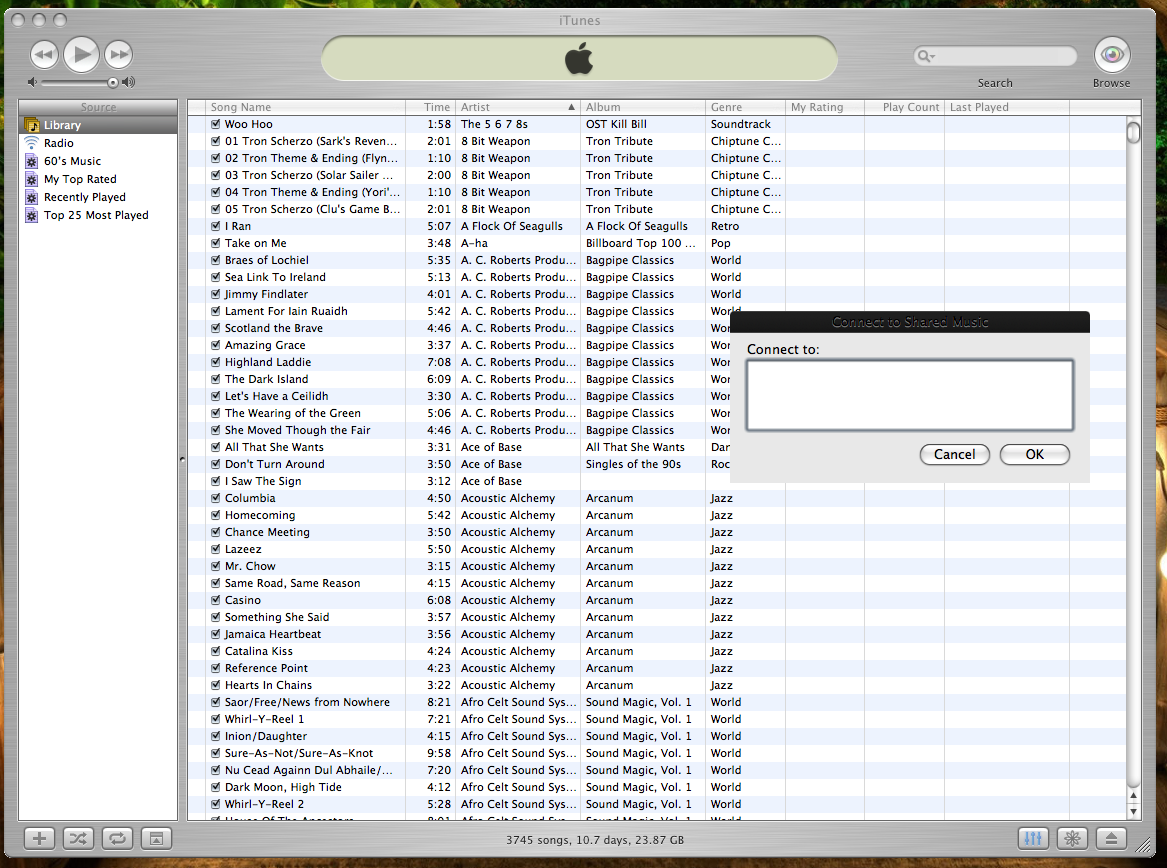

With the Mac that you want to access the shared libary open 4.0, and then press CMD+K (just like if you were connecting to a server). There will be an empty box that pops up. Type in the IP address (the WAN IP) of the Mac sharing the music and you'll access the shared library. Play as normal.
That's it.
One thing to keep in mind however! I do NOT suggest using 4.0 if you intend to still use any other version of iTunes. Remove the old iTunes and put it somewhere else.
4.0 cannot read your current iTunes database. You'll have to remove that somewhere and then have 4.0 reimport the songs.
Once done, do not open the newer version of iTunes. It will update the database and 4.0 won't be able to read it again.
So, again, I don't suggest this if you are going to be using any other version than 4.0.
Also, if you use iTunes for digital radio at all version 4, won't work. You'll need to find the direct stream URL for your favorite station(s) and connect to it (CMD+U) inside iTunes 4.
However! The good thing is that once you enter a stream, iTunes remembers it. The stream will be listed alphabetically in your Library.

You wouldn't be able to see my shared library even if you knew my WAN IP. The "About iTunes" needs to say 4.0. 4.0.1 was the update that removed sharing over the internet. Hence, why ONLY 4.0 has this feature.

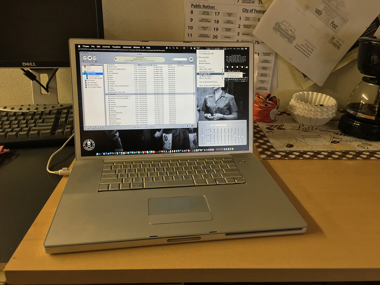

Connected at work to G3 Server at home. Connected to JLabs headset via Bluetooth.
Streaming iTunes over the internet from server through BT headset. Oh yeah. While the PowerBook backs up over the internet to the RAID connected to the G3 Server. 🙂

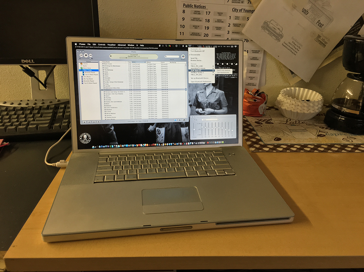

Connected to my G3 B&W server and streaming it's iTunes library (located on my 2TB RAID) to my Quad using iTunes 4.0.
Did I mention that the library on the RAID is also accessed by my MBP and my Thinkpad? Oh yes, in another thread. 😀
