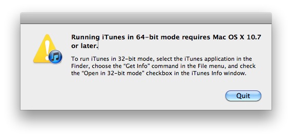

OK, so I decided to do an "Archive and Install" of Snow Leopard using the install disc that came with my iMac (all files, settings, programs, etc. left intact) and am now running 10.6.7 (will update to 10.6.8 later).
When I decided to run iTunes (10.4), now I get this: (1st attachment)
What's wierd is that the "iTunes" and "iTunesHelper" processes both say "Intel (64-bit)", so why can't it run in 64-bit?? (see 2nd attachment)
I was working on this the past 2 days, and as far as I can tell, it's probably just Apple's way of asking you to get Lion. However, if you fool the computer to think it is on Lion, it will launch, with a mix of Lion and Snow Leopard GUI elements. I am still working on it.
