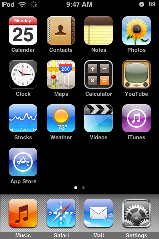

Anyways, I restored my iPod and it seemed to remove the jailbreak (Cydia, and everything else is gone), however, the battery percentage that I had turned on in BossPrefs still remains. Anyone know how this happened?
You restored from a backup. That puts back the numerical battery status.
And this situation with iTunes has nothing to do with jailbreaking or anything like that. Sometimes, some of the media partition gets corrupted on the phone, and deleted the folder /var/mobile/Media fixes it. You didn't do anything wrong.
