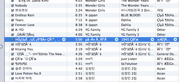

I usually keep my music files on my PC and stuff, but since I was thinking of getting rid of it, I transferred all my music files into my MBP.
So I transferred it via a USB Drive, and what do you know, iTunes show some of my Korean and Japanese songs with broken-looking weird scribbles.
It happens to only certain songs, and I really am confused.
As you can see in the attached picture, some displays the correct characters, but some just looks weird. Like the bottom three songs show correctly, but not some of the top ones or the highlighted one.
However, both my iPhone and my iPods in the past showed ALL Korean/Japanese charcaters without a single problem.
Is there any language pack that I'll need to be installing?
Or is there some kind of encoding within the iTunes?
I am currently using the latest build/version of the iTunes on Mac OS X Leopard running on Unibody MacBook Pro 2.53Ghz.

Yeah, the Korean/Japanese characters show perfectly fine on my iPhone like I said, I can type/read with no problem.
It's the iTunes that's messing me up, and I really don't know what to do 🙁

Well I think I figured out how to fix this even though this thread is over a year old. The old method of "get Info" doesn't work anymore on newer ones. Someone had directed me to ID3Pro v2.0 on macupdate and it worked for me. Basically you load the songs into ID3Pro by searching the folder you downloaded the osngs to and in the encoding you choose MacJapanese (for japanese songs) and hit save. It'll go thru the ID3 tags and rename them in the proper format and then relaod the songs into iTunes and voila its good.
