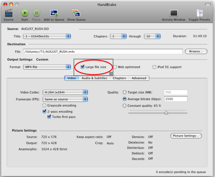

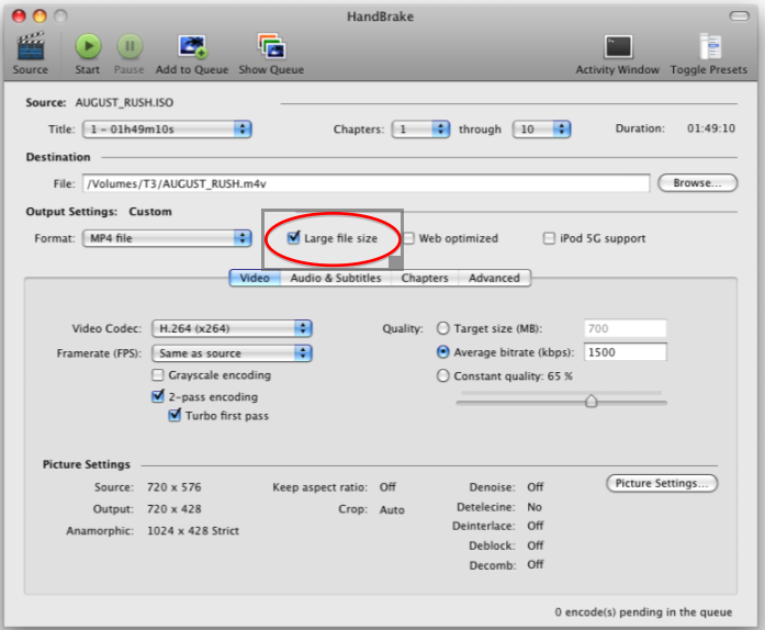

Found The Problem!!!
hey OP, finally found the problem. had to encode 3 times to figure it out.
in handbrake there is a setting to support "large files" i guess this must make everything "just work", see the picture below to find out where it is. its all good now i could import the 4.93gb file no problems. 🙂🙂
goodluck!
Awesome - thanks! Of course I'd seen this checkbox before but I really had no idea what it did. I'll try and re-encode and let you know if it works.
