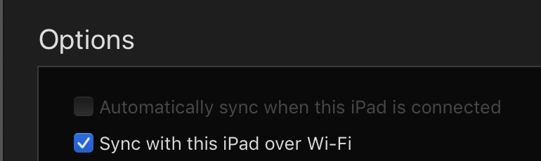

You will need to plug the device into the Mac and toggle off the "Sync via wifi" option in iTunes under the device's Summary page.
