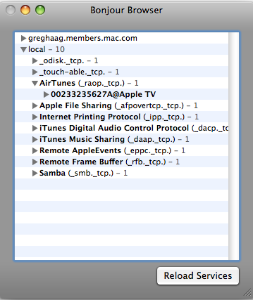

I am having exactly the same problem. I have had the apple tv since its release. No significant problems until recently. The apple tv is connected directly to the router. My iMac connects to the network wirelessly. Connection is variable. Sometimes it connects and sometimes it doesn't. I was thinking it might be a glitch with one of the new software updates.
Here is a screen shot of from Bonjour and it seems to show the apple tv. Not exactly sure how to ping.
